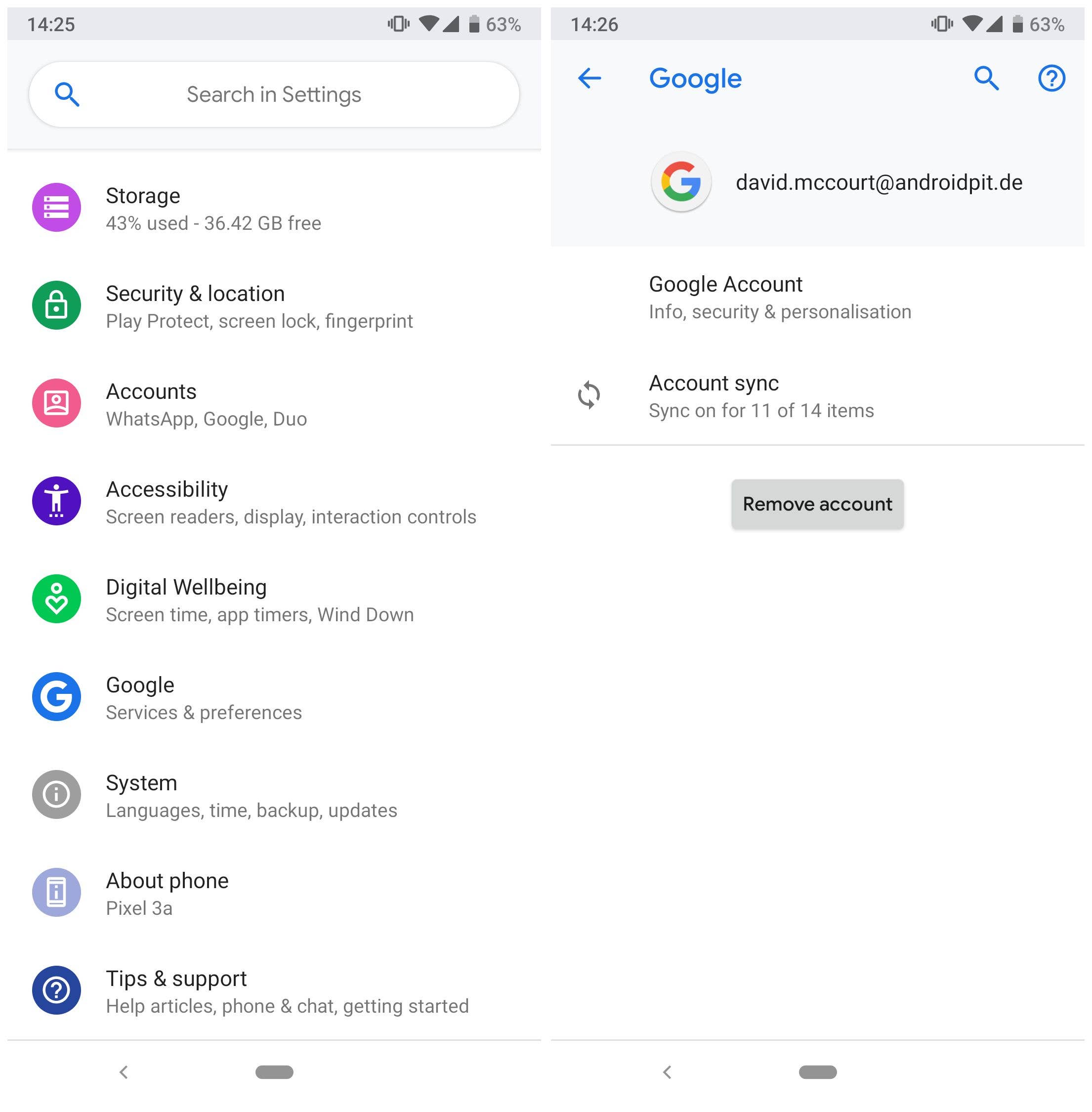

Simply remove your Google account
The error may simply be a sign-in issue, which sometimes occurs when the Play Store is updated. The first trick is to go into your phone’s main Settings menu and then Accounts & sync and simply remove the Google account that is getting the “authentication is required” error. Once you’ve done this, you can re-add the account and it should work just fine. You can also restart your phone before re-adding just in case. However, you may need to do this step along with the second step below.
Try a fresh sync
It’s possible that things aren’t syncing for some reason, and just need a little push. Go to the phoneSettings, tap Accounts & sync, find your Google account, tap it, and select Account sync. Then you can go back to the Play Store and see if the authentication message is gone.

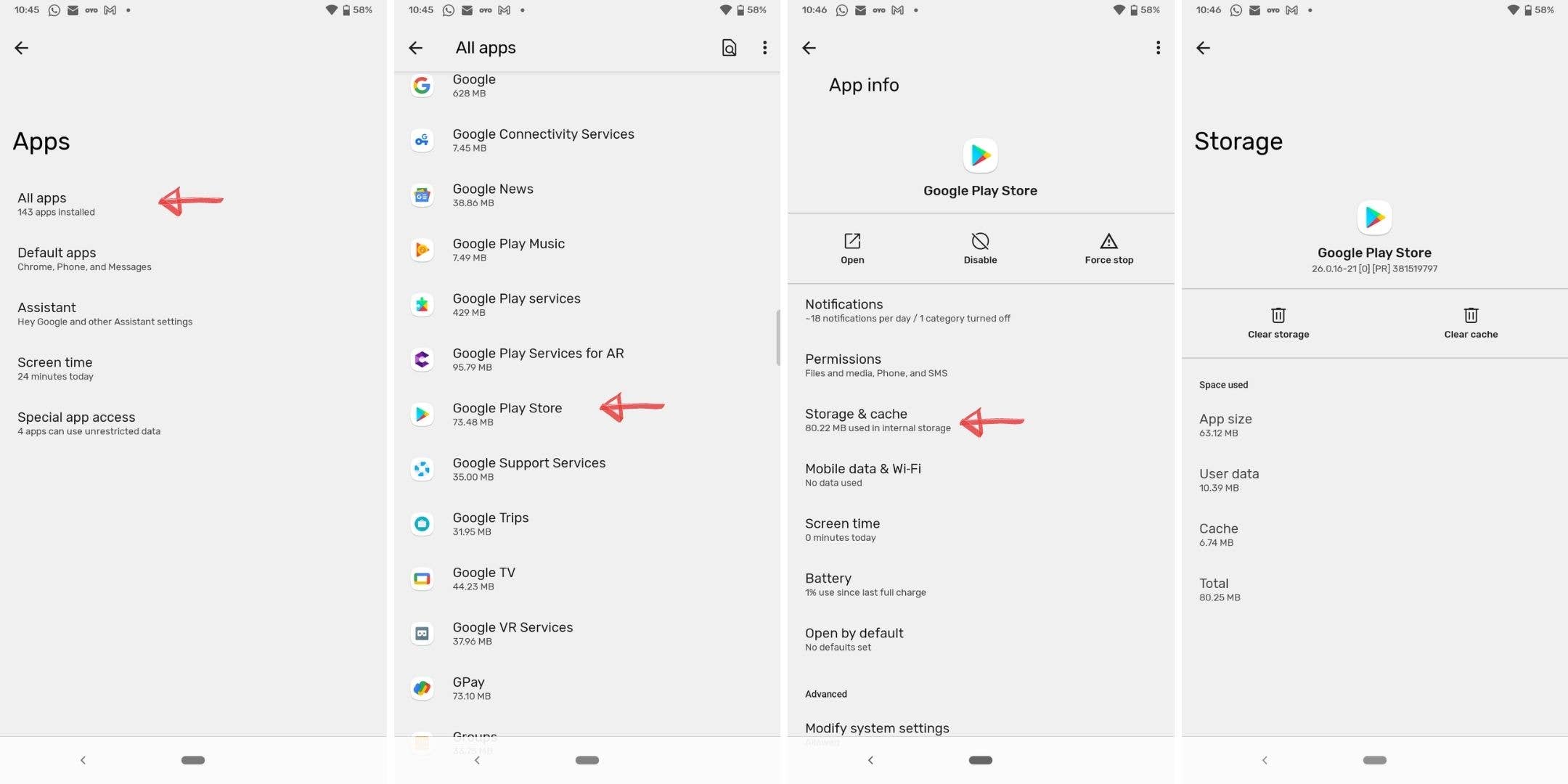

Clear data from the Google Play Store
To clear data from the Play Store, you need to follow these steps.
- Open Settings.
- Select Apps.
- Choose All apps.
- Scroll to find Google Play Store and tap to open.
- Tap on Storage and cache.
- Tap on Clear cache or Clear storage.
- You can try just clearing the cache first if you like, but clearing data will clear the cache as well.
If the previous step (the fresh sync) didn’t work for you, try again after clearing the cache and data—it could have better results.

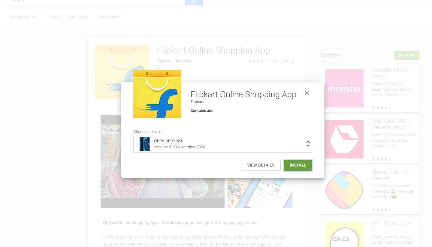

Download an app using your mobile/desktop browser
This workaround bypasses the malfunctioning Play Store app completely. Go to your web browser and navigate to the Google Play Store website. Try downloading an app directly from there rather than through the Google Play Store app. Just sign into your Google account through your browser and then install the chosen app.
You can also do this on your desktop browser. You will be asked to sign in to your Google account and then select which device you would like to download the app to. As long as your smartphone/tablet is connected to the Internet, the download should begin almost instantly.
