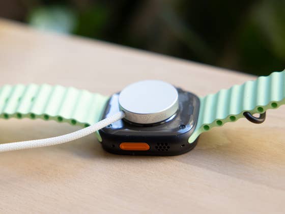

When testing the Apple Watch Ultra 3 battery life, I plugged it into a 30-watt MacBook adapter. Apple clearly states that fast charging requires a USB-C power adapter of 20 watts or higher, but what really matters is the supported charging profile. I assumed more wattage would automatically make it faster. It did not.
Fast charging on the Ultra 3 requires about 9 volts at 2.2 amps to reach the full 20 watts. The 30-watt MacBook adapter likely defaults to five volts at three amps, which is 15 watts. As a result, charging took much longer than Apple’s claim of zero to 100 percent in 75 minutes. I measured a full charge in 103 minutes.
Having the charging cable arrive in the same color as the chassis is a nice touch.
I mistakenly used a 30W MacBook Air charger to power the Apple Watch Ultra 3, and it took 103 minutes instead of the expected 75. Image source: nextpit
So the takeaway is simple. Check the charging specifications of your smartwatch and use hardware that supports the correct voltage and current profile or PD PPS protocol if applicable. This information is available in the product documentation or on the manufacturer’s website. Certified third-party chargers and cables will also work, but only if they match the supported requirements.
