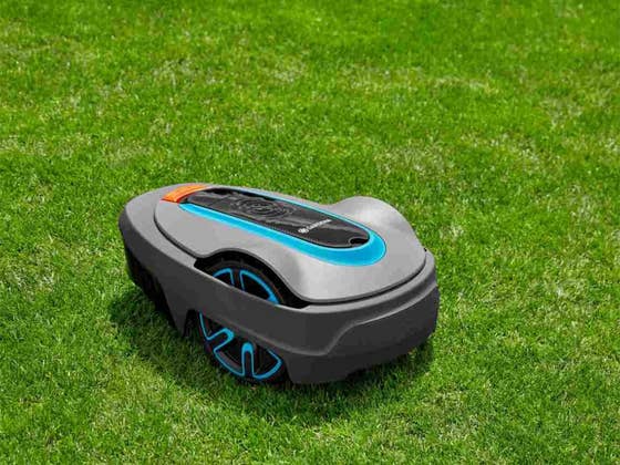

Check the drive wheels
The next item on the list is to check the drive wheels. Similar to cars, you should take a look at the profile of the wheels. If the wheels are too worn out or defective, you have to replace them. Finally, you can oil the axles of the robot lawn mower so that it can drive around more smoothly and continue to climb slopes in your garden without any problems.
How massive should the robot lawn mower's wheels be? EcoFLow Blade: Yes.
How massive should the robot lawn mower’s wheels be? EcoFLow Blade: Yes. / © nextpit Image source: nextpit
