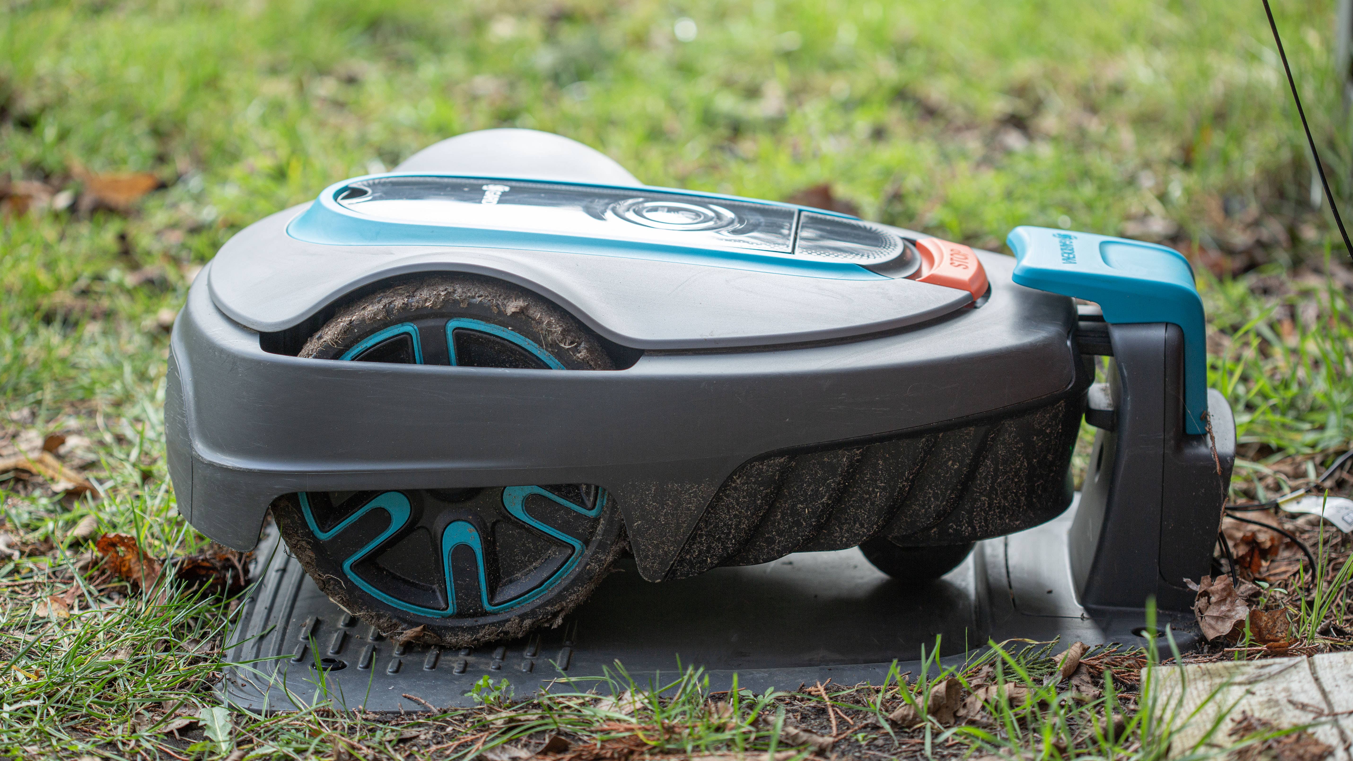

I must admit that when I first unpacked the Gardena Sileno City, I was a little bit shocked. The box included not only the functionally designed robot itself and the corresponding charging station with a power adapter, but the huge box also contained a cable drum, numerous pegs, various clamps, and a “quick start guide”, which could also double up as a temporary tent.

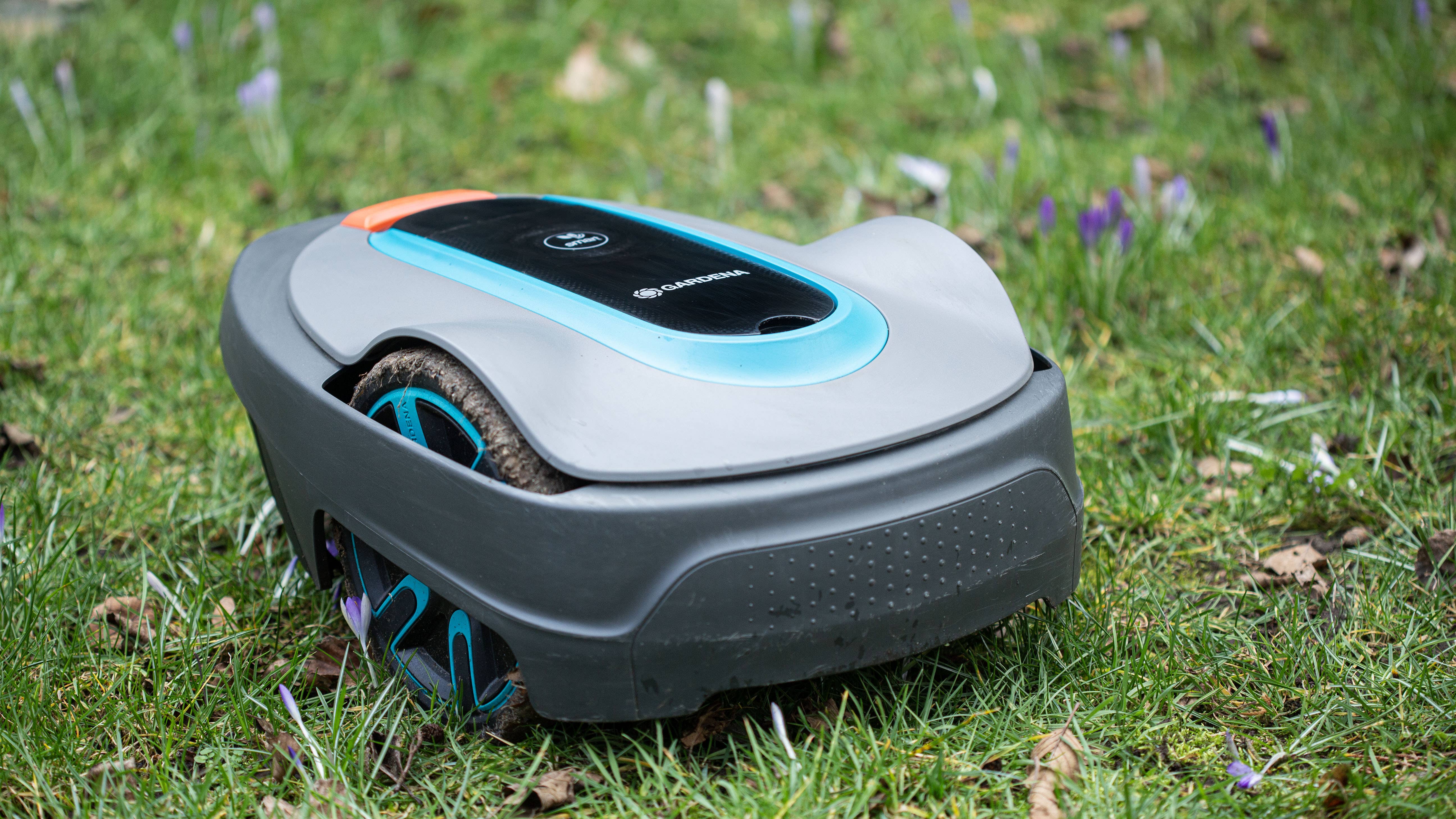

Gardena Sileno City 600 m²
The Gardena Sileno City looks chic and feels expensive, although the robotic mower is made of mostly plastic. / © NextPit Image source: NextPit

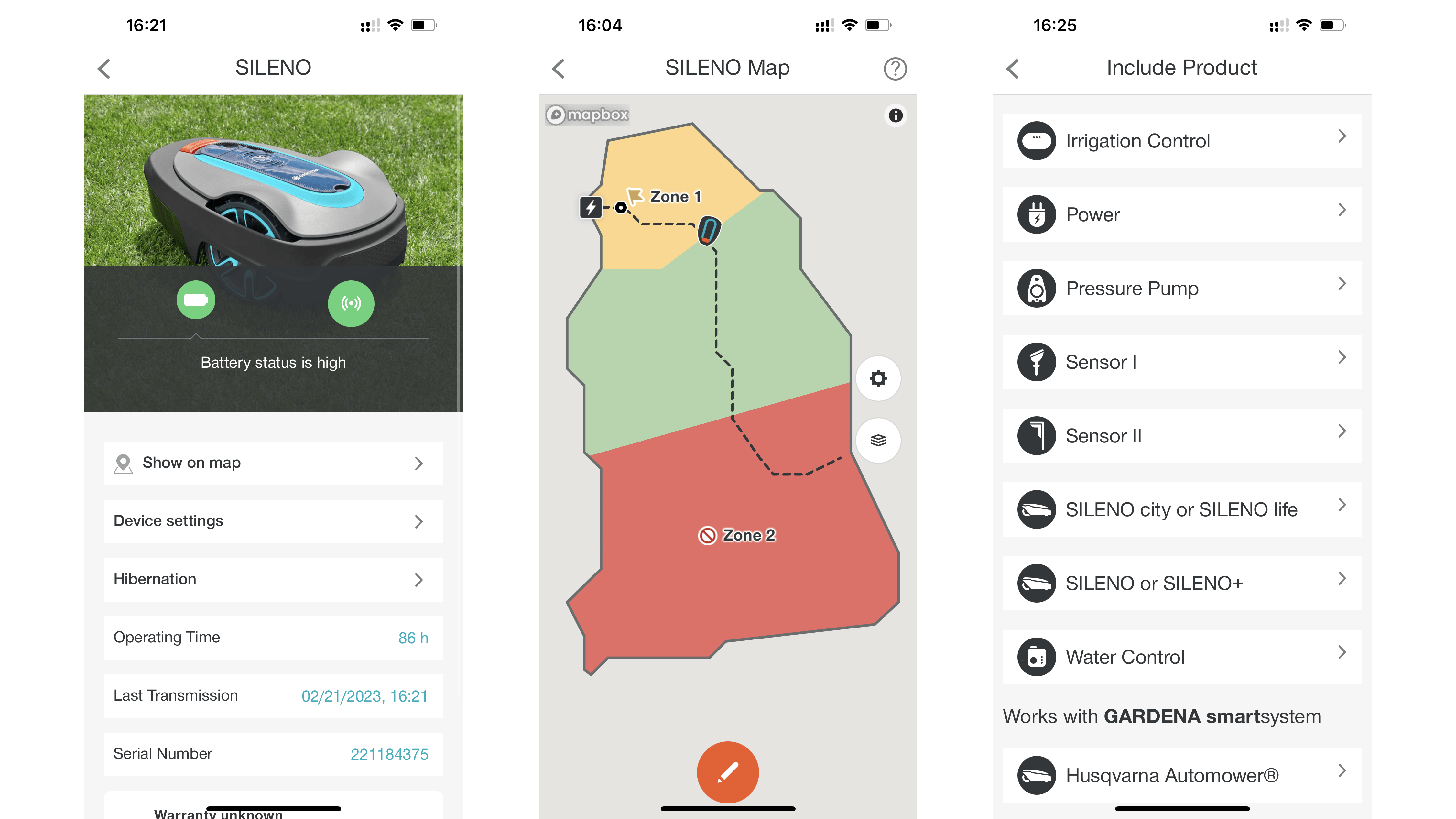

Gardena Sileno City 600 m² screenshots
Until you find the robot and your garden in the app, you have a chunk of work ahead of you. / © NextPit Image source: NextPit

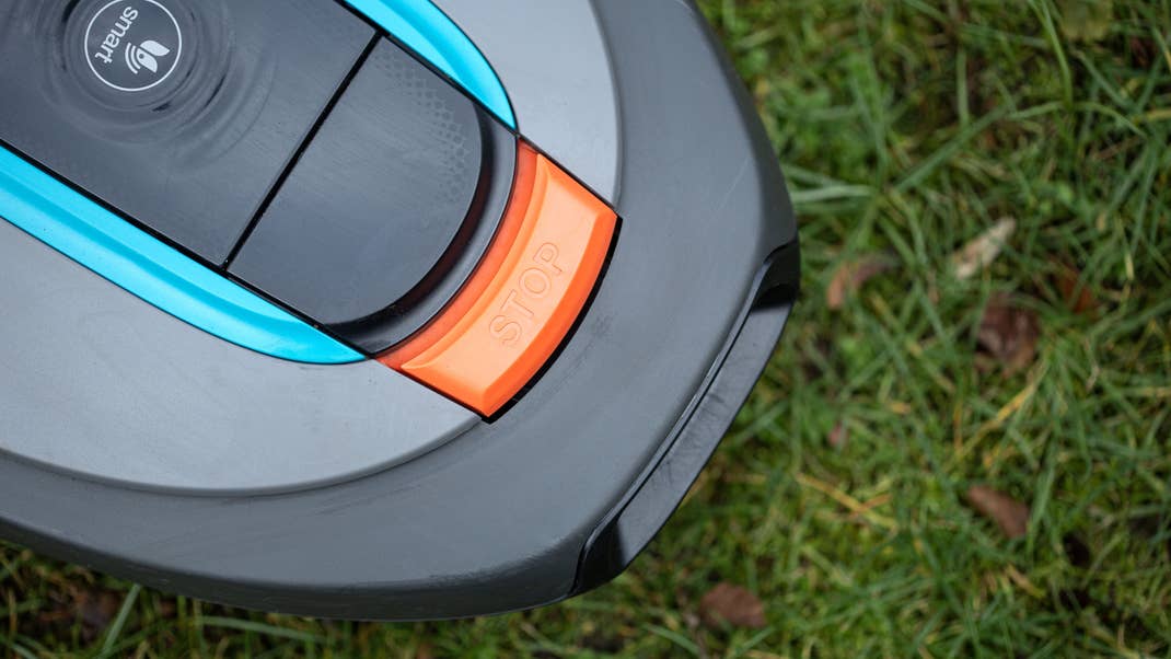

Gardena Sileno City 600 m² stop button
On the top of the Gardena Sileno City 600 m² there’s a big stop button to stop the robot. / © NextPit Image source: NextPit

Once your garden is correctly wired, you have the option of connecting the bridge between your robotic lawnmower and your Wi-Fi network. Doing so will allow you to control the robotic lawnmower via the Gardena app. In principle, you can also operate the Sileno City completely from your device, but that is not much fun.
Establishing the connection is easy: You plug in the bridge which is ideally located outdoors in a protected location, connect it to the Wi-Fi and then hook up the robotic lawnmower to the bridge. This worked without any problems in the review. If you do not have a bridge, you can also control the robotic lawnmower via Bluetooth, but only within the immediate vicinity of the Sileno City.

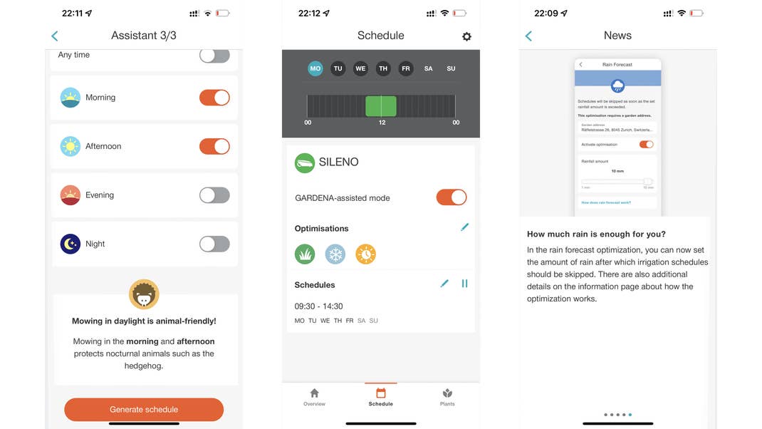

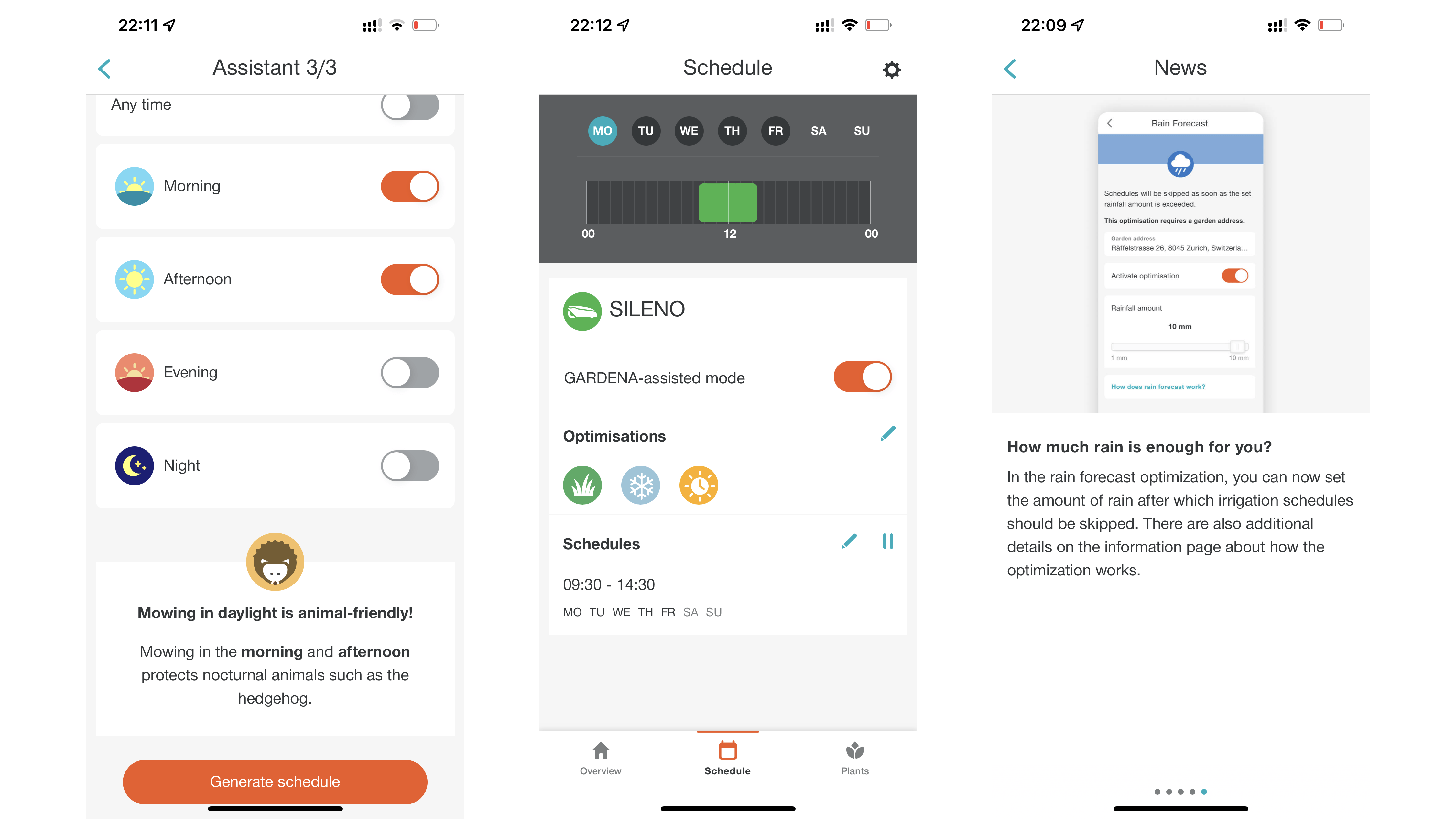

While most of the Gardena Sileno City’s features are also programmable directly on the robot, it has about the operating charm of a VCR from the 80s. The smartphone app is a whole lot more convenient. On your smartphone, you can conveniently schedule the robotic lawnmower when it should perform, and the easiest way to do so is via the integrated assistant. Here is some food for thought: There is also a daylight mode so that the robot only mows in daylight when hedgehogs and other small animals are not around.
Gardena Sileno City 600 m² Screenshots
Interesting: In the assistant for schedules, the app tells you how to protect hedgehogs. The robot can also refer to the weather forecast. / © NextPit Image source: NextPit

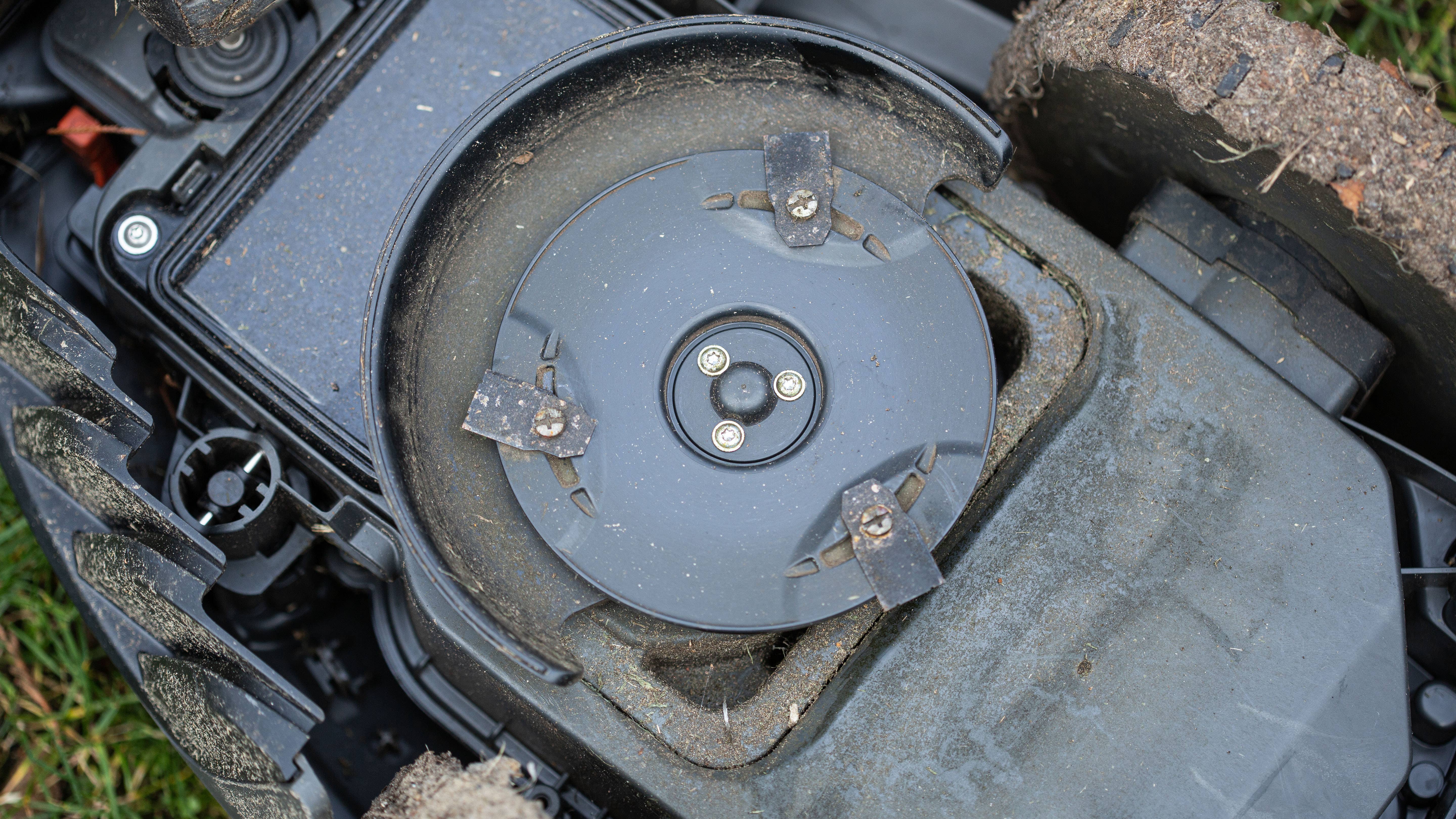

Gardena Sileno City 600 m² bottom view
Looks like work: On the underside of the Gardena Sileno City 600 is a disc to which three blades are loosely attached. If the disc rotates during operation, the blades will align themselves. / © NextPit Image source: nextpit

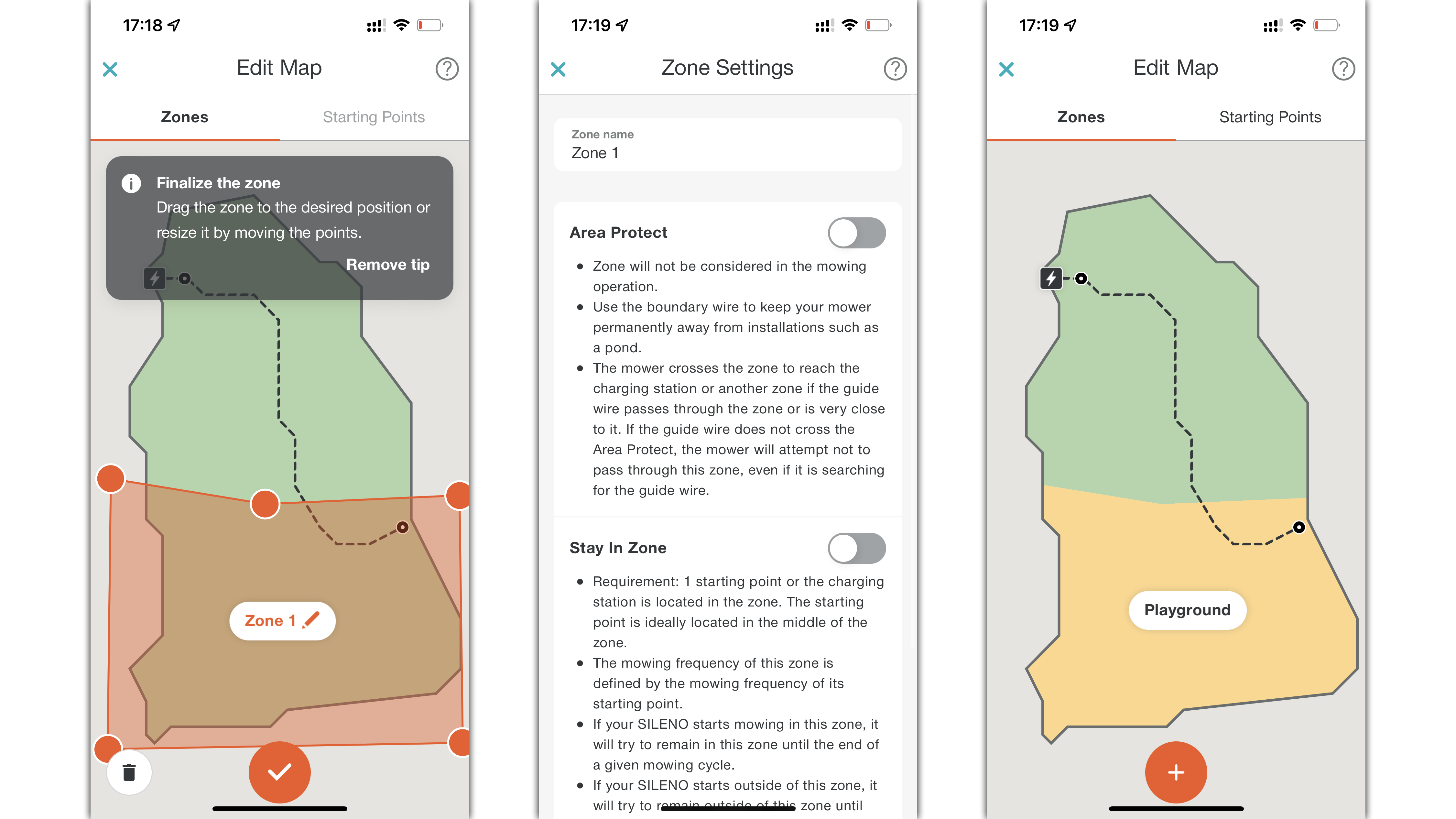

Towards the end of the 2022 mowing season, Gardena added another interesting LONA feature: You can now create different zones in your garden. You can switch the status of each zone between “Do not enter” and “Do not leave” modes, thus restricting the robot to certain areas. For example, you can prevent the robot from driving through your barbecue area or over freshly seeded lawns.
With the zone option, you can determine where the Sileno City 600 should mow and where it is not welcomed. / © NextPit Image source: NextPit
This worked out pretty well, but you should not expect fantastic precision from the built-in GPS module. In the review, the Gardena Sileno City often exceeded the virtual limit by a few centimeters. If you want to protect sensitive items or plant life using zones, it is better to leave a little bit more wiggle room than usual for safety. Another advantage of the GPS module? You can always see where the robot is on the map, which can be quite helpful in larger gardens.

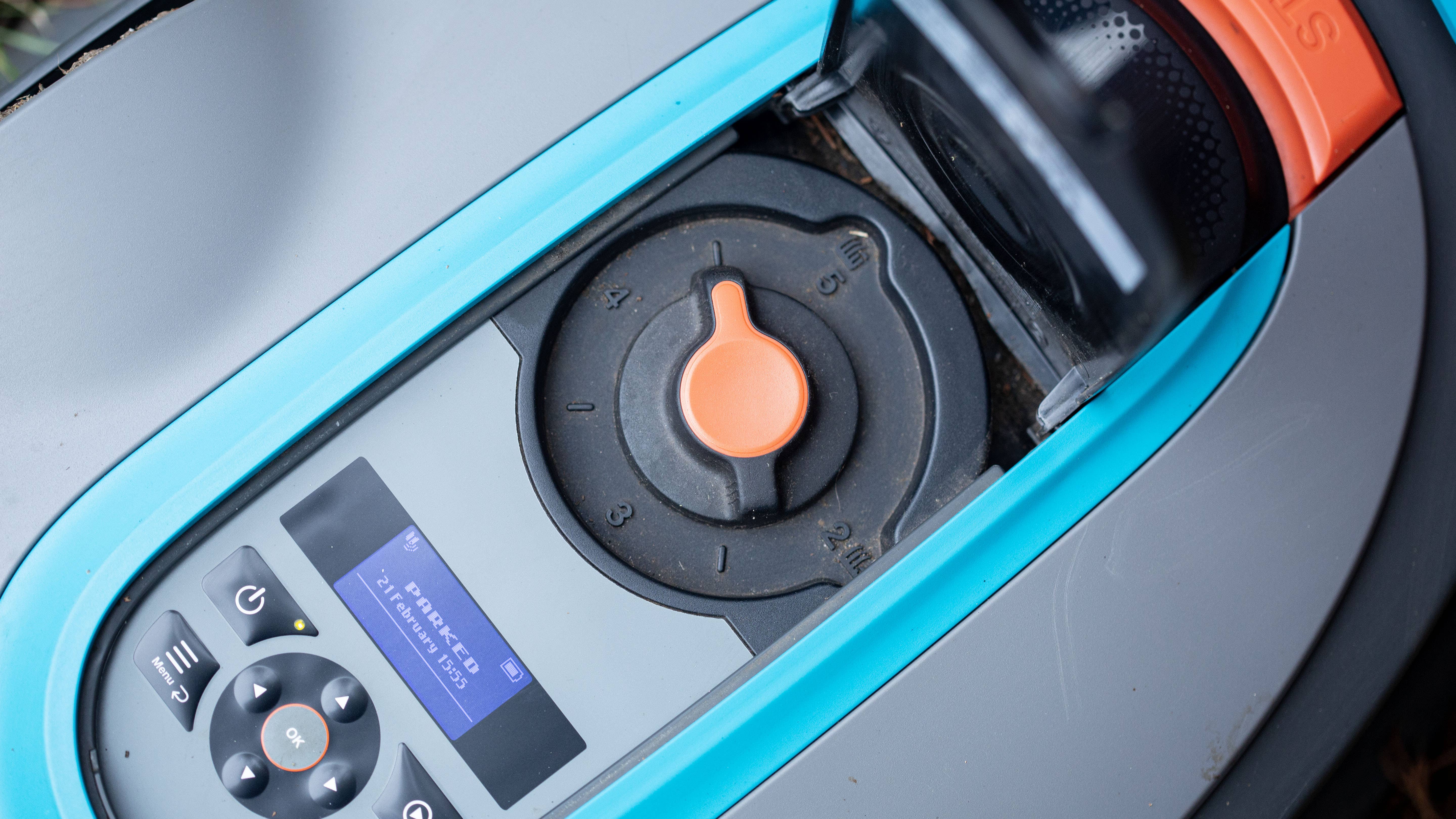

In terms of mowing performance, the Gardena Sileno City leaves very little to be desired. The robot reliably draws its paths and trims the lawn to the preset length. For this purpose, there is a rotary knob under the cover on the top of the robot to adjust the height of the blades and set the cutting length between 2 and 5 cm. This is to ensure that your lawn does not end up with nasty-looking patterns like a soccer field, and it does so by moving around randomly.
You can set the desired cutting length of the Gardena Sileno City. / © NextPit Image source: NextPit
