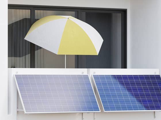

Yuma Flat (800) Pro photovoltaic panel
If the PV modules are mounted flat, as is the case here with the Yuma Flat (800) Pro balcony power plant, then the yield is significantly better than with a completely vertical 90-degree orientation on the balcony! / © nextpit Image source: nextpit

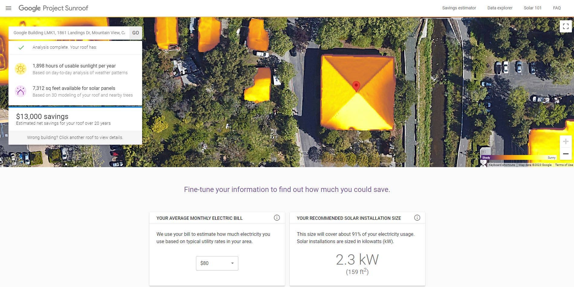

For this example, we will use Google’s Project Sunroof calculator. Which will offer a ballpark estimate of the average usable sunlight per year, and even the usable area for solar panels if you are planning on going for a roof installation.
Google Project Sunroof
Google’s Project Sunroof will give an estimate on the necessary installation to cover most of your electricity bill with solar panels. / © Google Image source: Google
Most US-based calculators are set to roof installations, and we couldn’t find tools to estimate balcony solar panels, but you can get a rough estimate for electricity bills savings with smaller solar installations by checking the kilowatts (kW).
