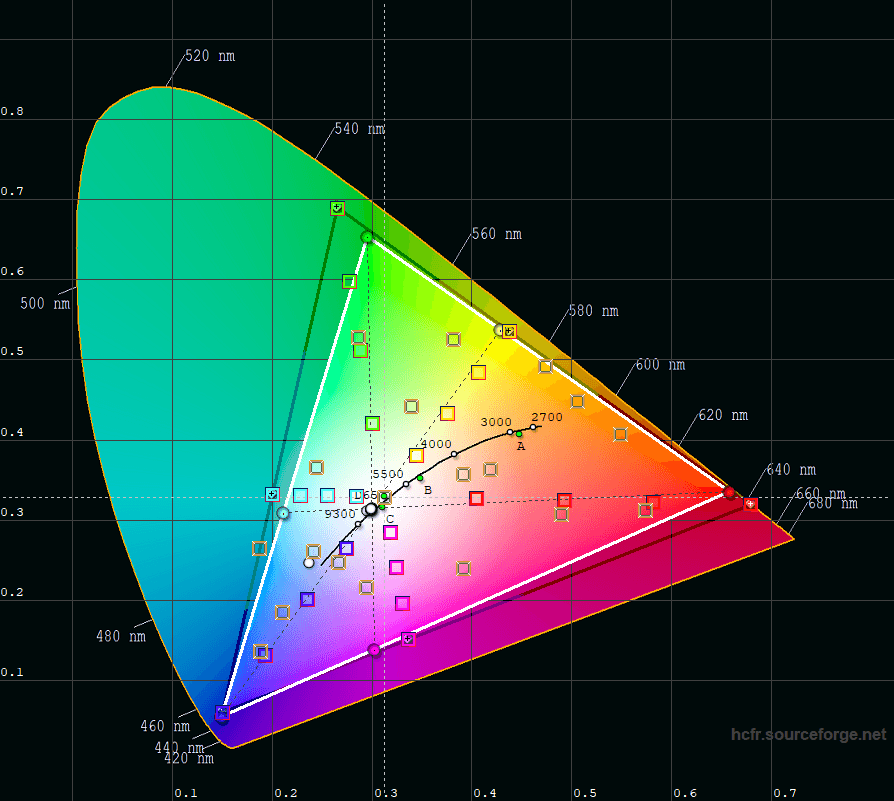

But the results from our test speak for themselves, and they’re less generous. The maximum brightness is 454 cd/m², which isn’t very high and makes the device difficult to read in bright sunshine. The deviations in color representation and grayscales, which are expressed in Delta E values, are too high. That’s especially the case with the grayscales, which have an average of 8.11. The colors are too far from ideal, especially with cyan, magenta and white.

There are noticeable gaps in the color representation. / © NextPit

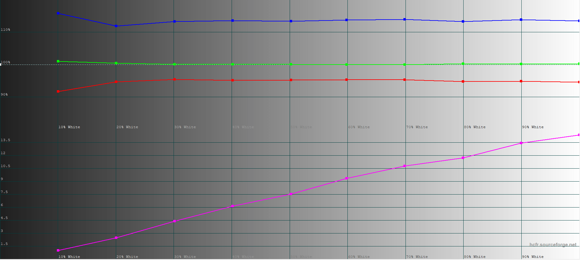

You’ll notice the display’s shortcoming with your eyes when you take a closer look at the Pocophone F1 display. The colors don’t shine like on an OLED panel, and the blacks aren’t quite deep enough; they seem slightly gray. The viewing angle stability is also a bit shaky, as the display darkens relatively quickly when you view it from a sharp angle. The panel also doesn’t evenly illuminate, and clear halos can be seen at the lower end.
xiaomi pocophone display test 3
Reds, greens and blues are quite balanced. / © NextPit
The Pocophone F1 is well on its way in terms of contrasts: 1,302:1 is a good value for an LCD screen. In the standard setting, red and blue are also pretty close to the 100% mark, and green is exactly on it. That speaks for a balanced display.
