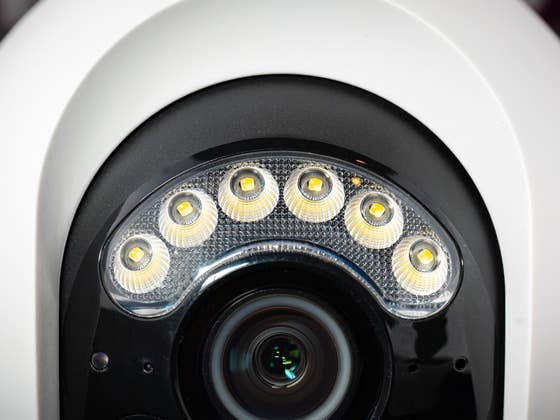

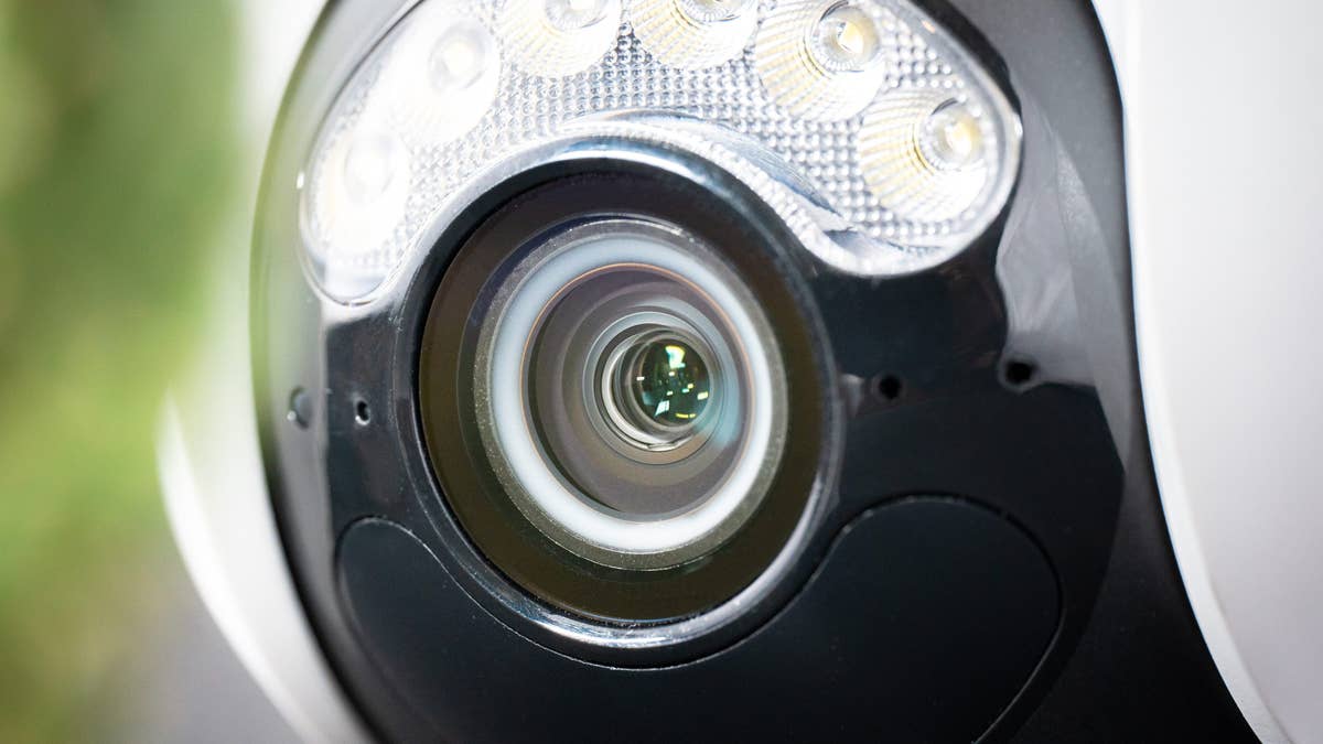

Close up of the Reolink Atlas PT Ultra security camera lens and its LED lights.
Thanks to a high-speed lens, the Atlas PT Ultra does not need infrared lights for night vision.
Quelle: nextpit

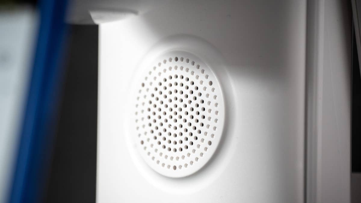

Close-up of the Reolink Atlas PT Ultra device and its powerful speaker.
The speaker is located at the bottom of the camera and is surprisingly loud.

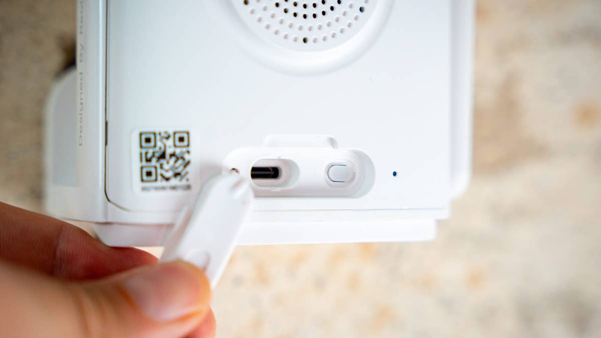

Close-up of the USB-C port and QR code in the Reolink Atlas PT Ultra camera.
The USB-C port is used for charging, where the charging cable of the solar panel covers the port.

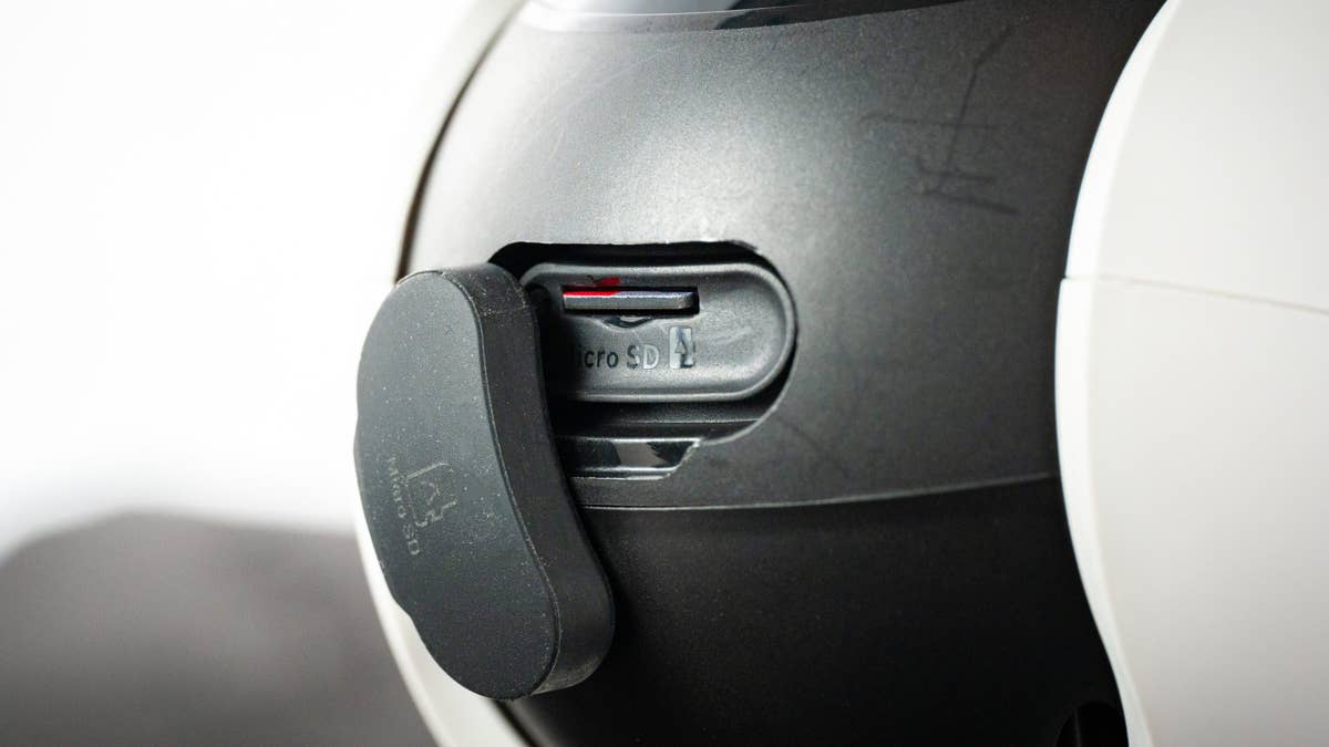

Close-up of the microSD card slot on the Reolink Atlas PT Ultra camera.
Unfortunately, the microSD slot is freely accessible.
Quelle: nextpit

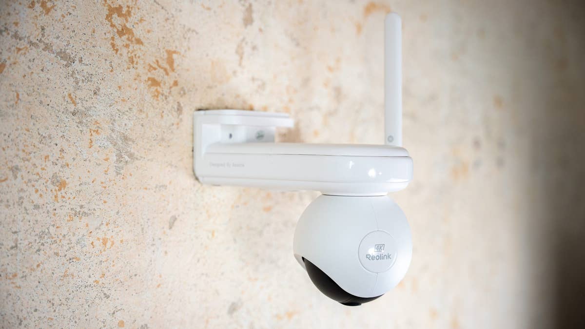

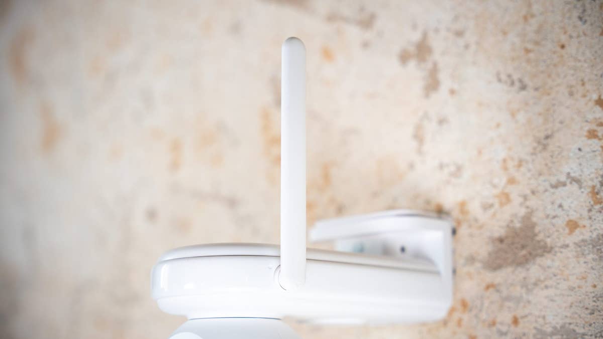

Close-up of the Reolink Atlas PT Ultra camera mounted on a wall with its antenna.
The antenna is intended to provide better WiFi range.
Quelle: nextpit
This solution already indicated the Altas PT Ultra is more of an outdoor security camera than anything else. Of course, the camera can also be mounted on walls within your home, but since it protrudes approximately 18 cm from the wall, it is rather bulky for indoor use. As I’m not allowed to monitor the outside of my home, I used the camera in my office and placed it on a bookshelf using a DIY mechanism.

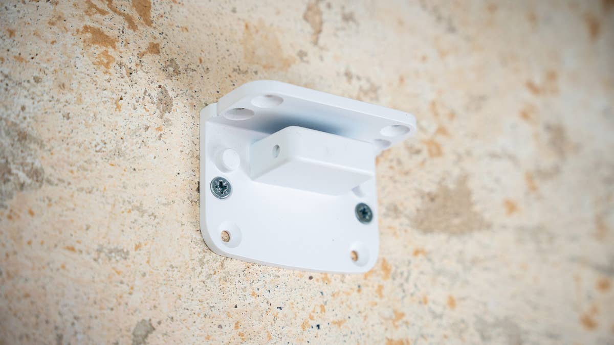

A white bracket attached to a textured wall.
To install it, you must first screw this plate to the wall.

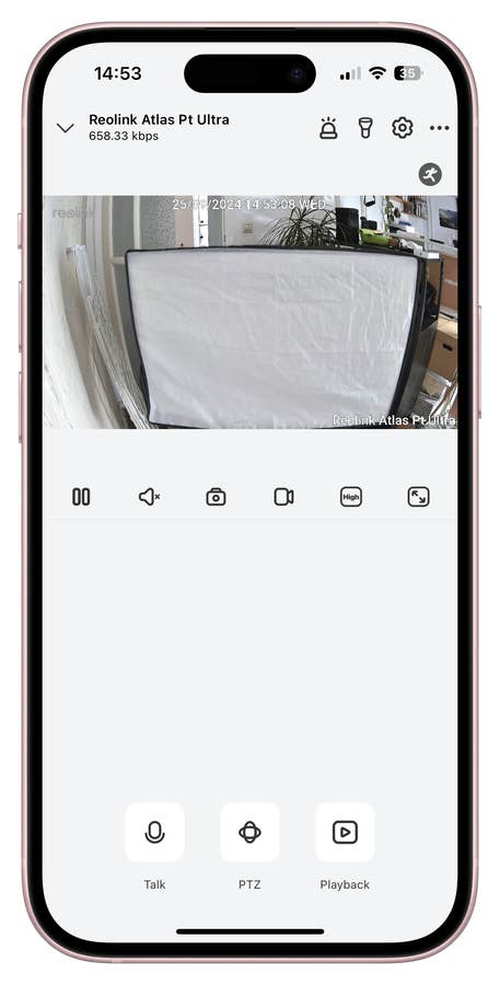

Reolink Atlas PT Ultra camera interface with live streaming and controls.
If you tap on this, you can control some other functions.

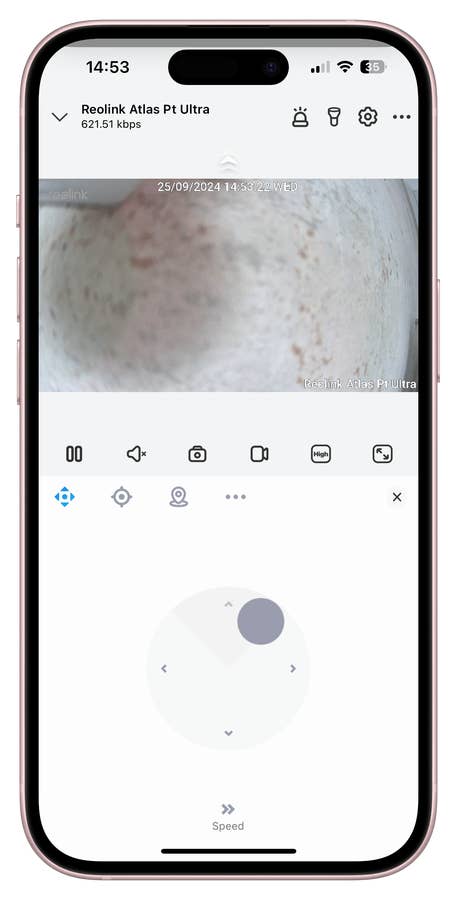

Reolink Atlas Pt Ultra app interface with live feed and control options.
You control the PT function via a virtual joystick.

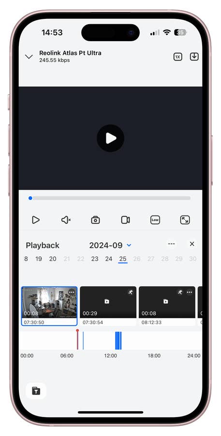

Reolink Atlas Pt Ultra app interface with playback options and video timeline.
You can watch all recordings again in the playback view.
Quelle: nextpit

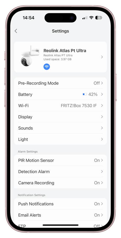

Settings menu for Reolink Atlas PT Ultra camera, showing battery, WiFi and alarm settings.
You can find all the camera functions in the settings.
Quelle: nextpit
However, I was impressed by the way the Reolink app worked during the review. You get an overview of all the cameras, numerous settings to choose from, and icon-based control of the main functions of the Altas PT Ultra. There is a digipad that can be used to control the pan-and-tilt function and an overview of the recorded video clips. You can zoom into the camera image itself, which makes perfect sense thanks to the 4K resolution.

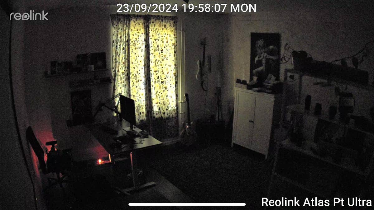

The compact Reolink Argus 4 Pro (review) already impressed us in the review with its very good image quality and color night vision. There is a particularly bright lens with an open aperture of f/1 and a 1/1.8″ sensor, ensuring infrared lamps are no longer required for night vision.
This configuration certainly works if there is a little residual light. In this case, the Altas PT Ultra even brings colors out of the darkness, but in most cases, it switched on a floodlight. Together with an acoustic signal, this can provide a good deterrent effect. However, the Altas PT Ultra only detects movements that are within the camera’s field of view.

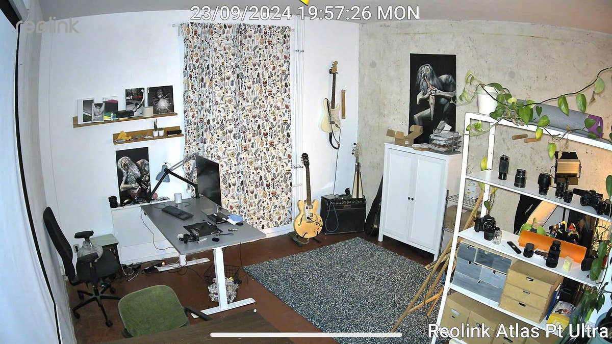

Reolink Atlas PT Ultra Image Quality 01
Image quality with the floodlight activated
Quelle: nextpit

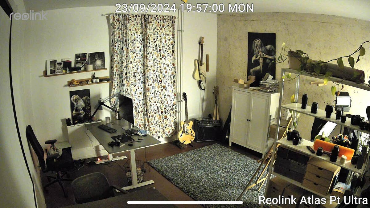

Image quality in complete darkness.
Quelle: nextpit
Reolink Atlas PT Ultra Image Quality 02
Image quality without the floodlight with an external light source.
Quelle: nextpit
