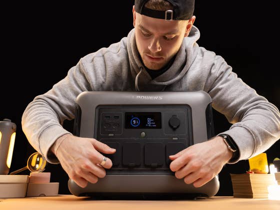

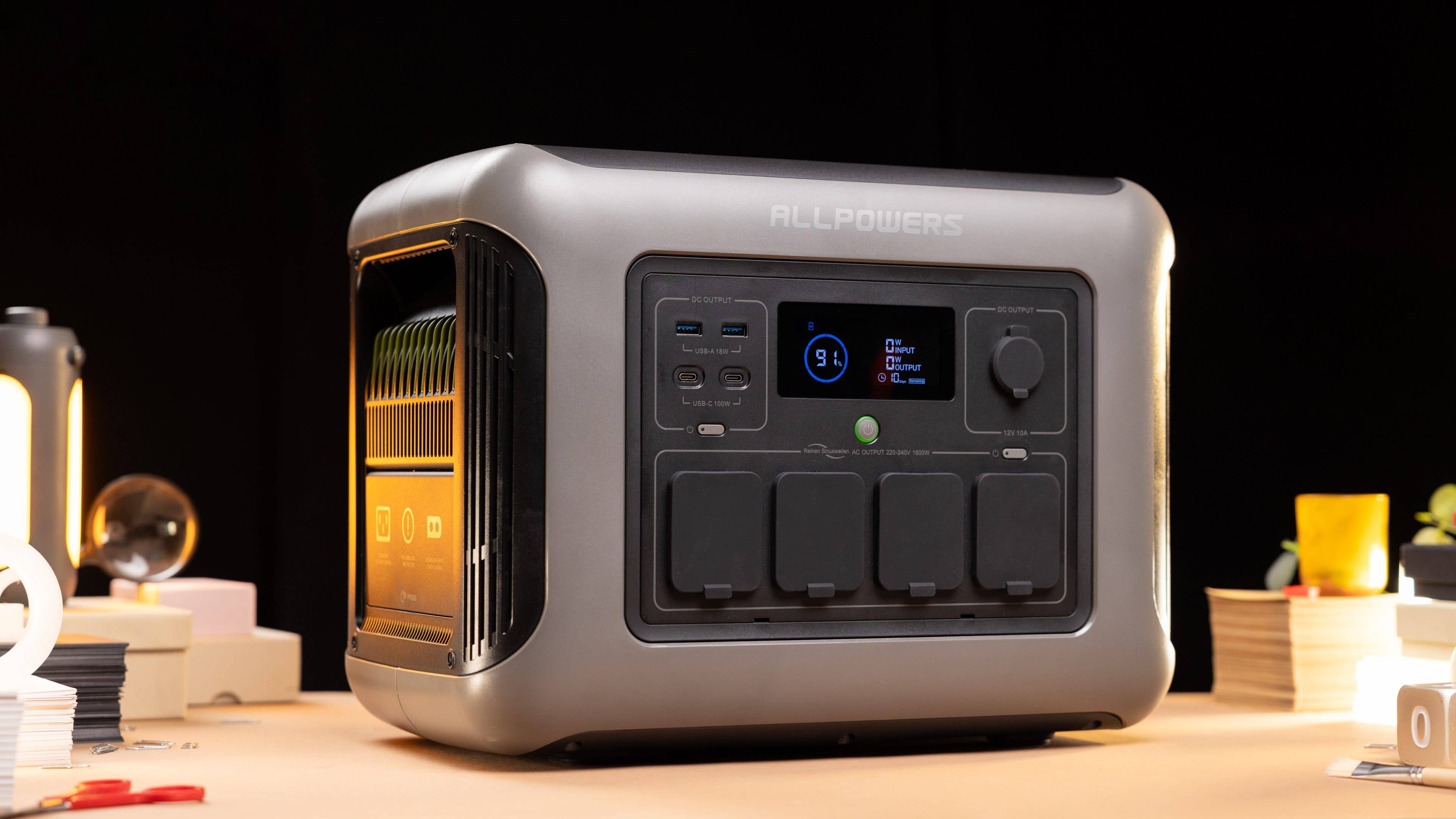

Getting the Allpowers R1500 out of the box is not an easy task with its compact shape and recessed side handles. However, you can ease it out of the box by turning it upside down and gently shaking it. Thanks to the compact carrying solution, the power station is extremely compact and easy to transport.
Allpowers opted for a gray-black color combination for the R1500. The Allpowers R1500 tips the scales at 16.7 kg and measures 41.3 × 31.2 × 26.5 cm. The square design of the Allpowers R1500 is practical for transportation and storage purposes. You can easily store additional luggage or crates of beer in the trunk for a weekend trip on top of the power station without missing a beat. Thanks to the rubber-coated feet, the Allpowers power station also has a non-slip base.

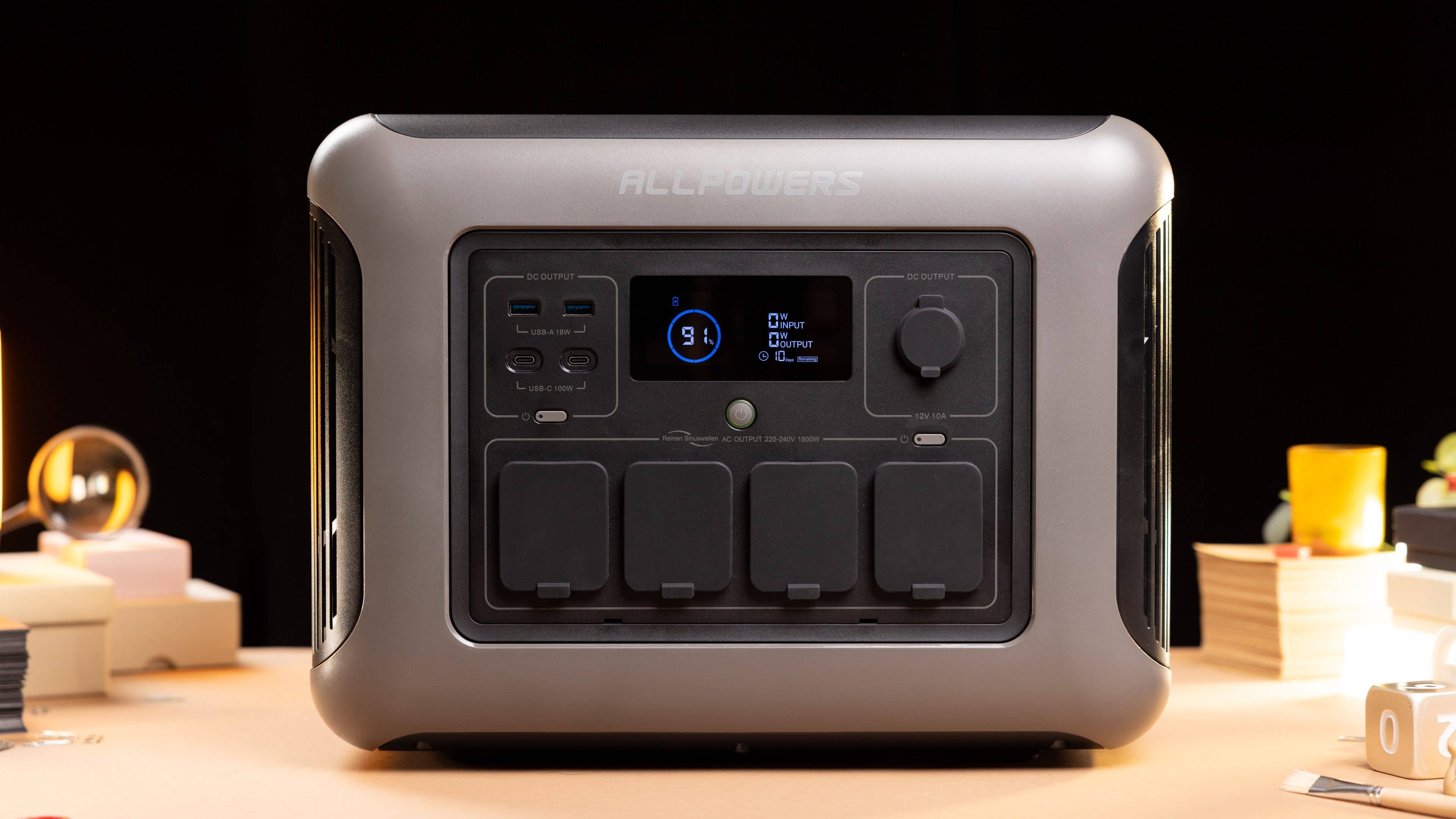

Nothing out of the ordinary with the Allpowers R1500 in terms of looks.
Allpowers cleverly hides the side handles of the R1500. The design is discreetly unspectacular thanks to the black and grey color scheme. / © nextpit Image source: nextpit

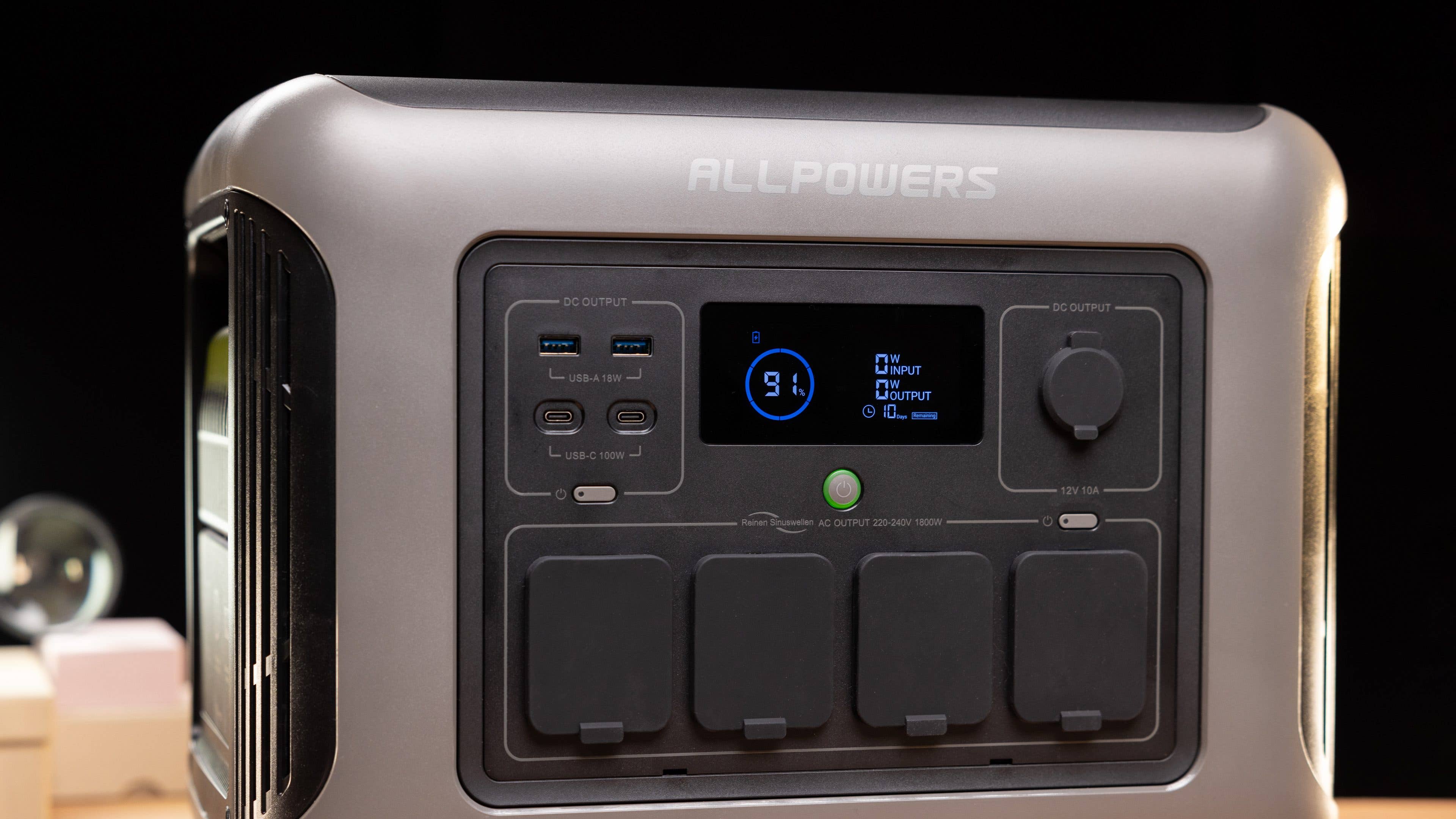

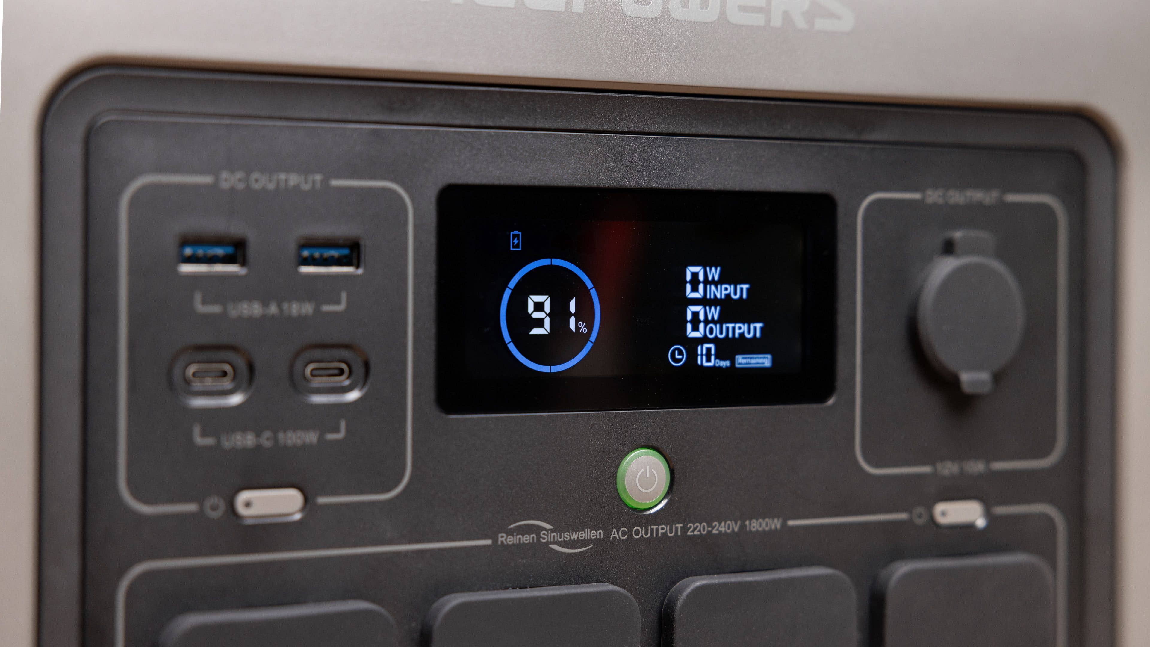

The front has eleven connections ready to serve you. The range of connections is quite versatile, comprising the following:
  • 4x 230 V sockets
  • 2x 100W USB-C connections
  • 2x 18W USB-A outputs
  • 2x 15W wireless charging pads
  • 1x cigarette lighter
Allpowers refrained from fitting protective covers on all the connections. Only connections offering AC output and the cigarette lighter are protected from dirt, moisture, and other unwanted riffraff with a cover.
It would be nice to see the USB ports covered.
The connections are all located in front of the power station. It’s just a shame that the USB ports are not protected with covers. / © nextpit Image source: nextpit

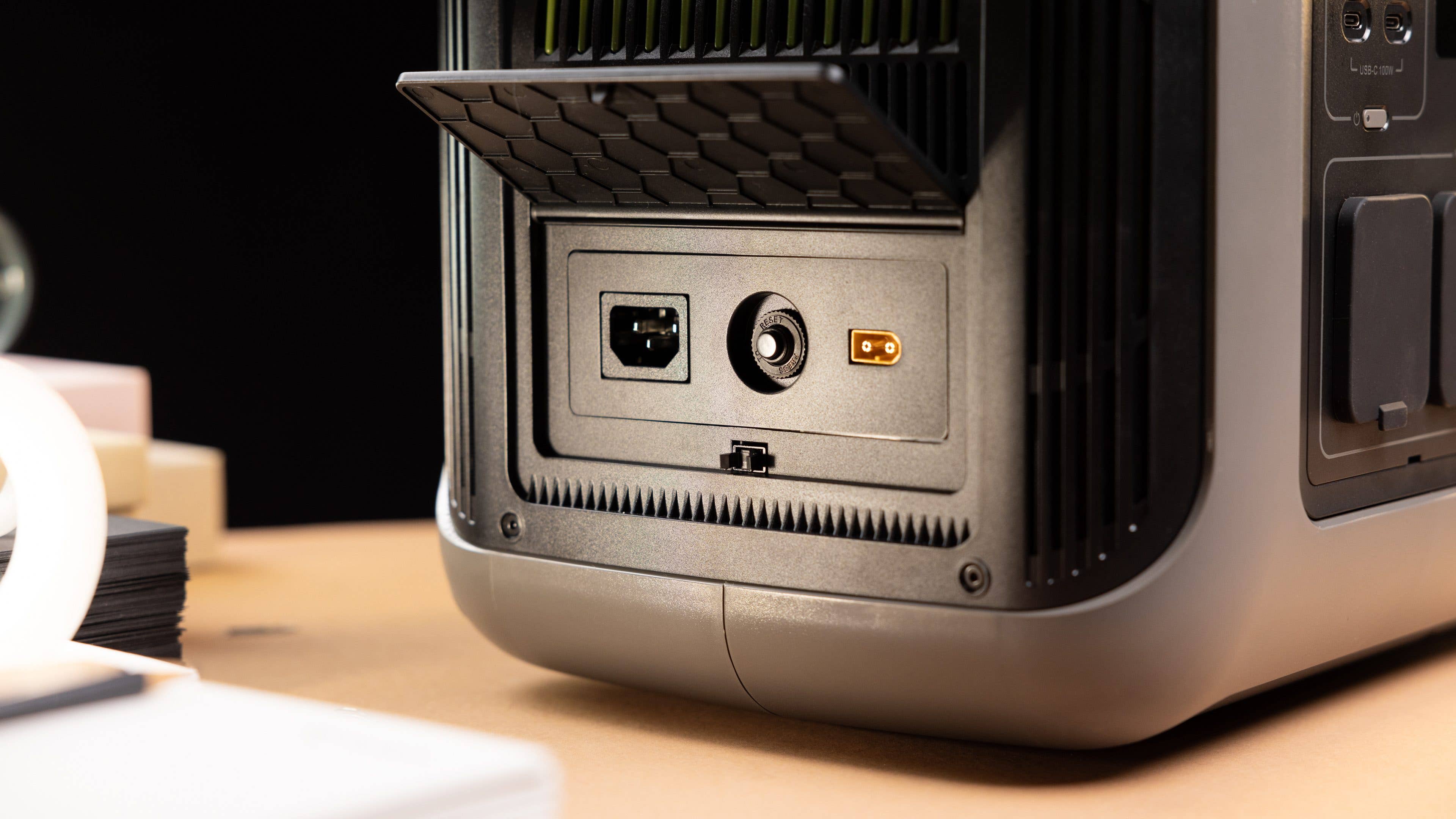

On the right side, you will find two options to charge the portable power station. One, you can connect the Allpowers power station to your home network or recharge it via solar power. You will also find the connections here protected from external elements by a push-to-open cover.
The charging ports of the Allpowers R1500 are protected by a cover.
On the right are the two connections for supplying the Allpowers R1500 with juice. / © nextpit Image source: nextpit

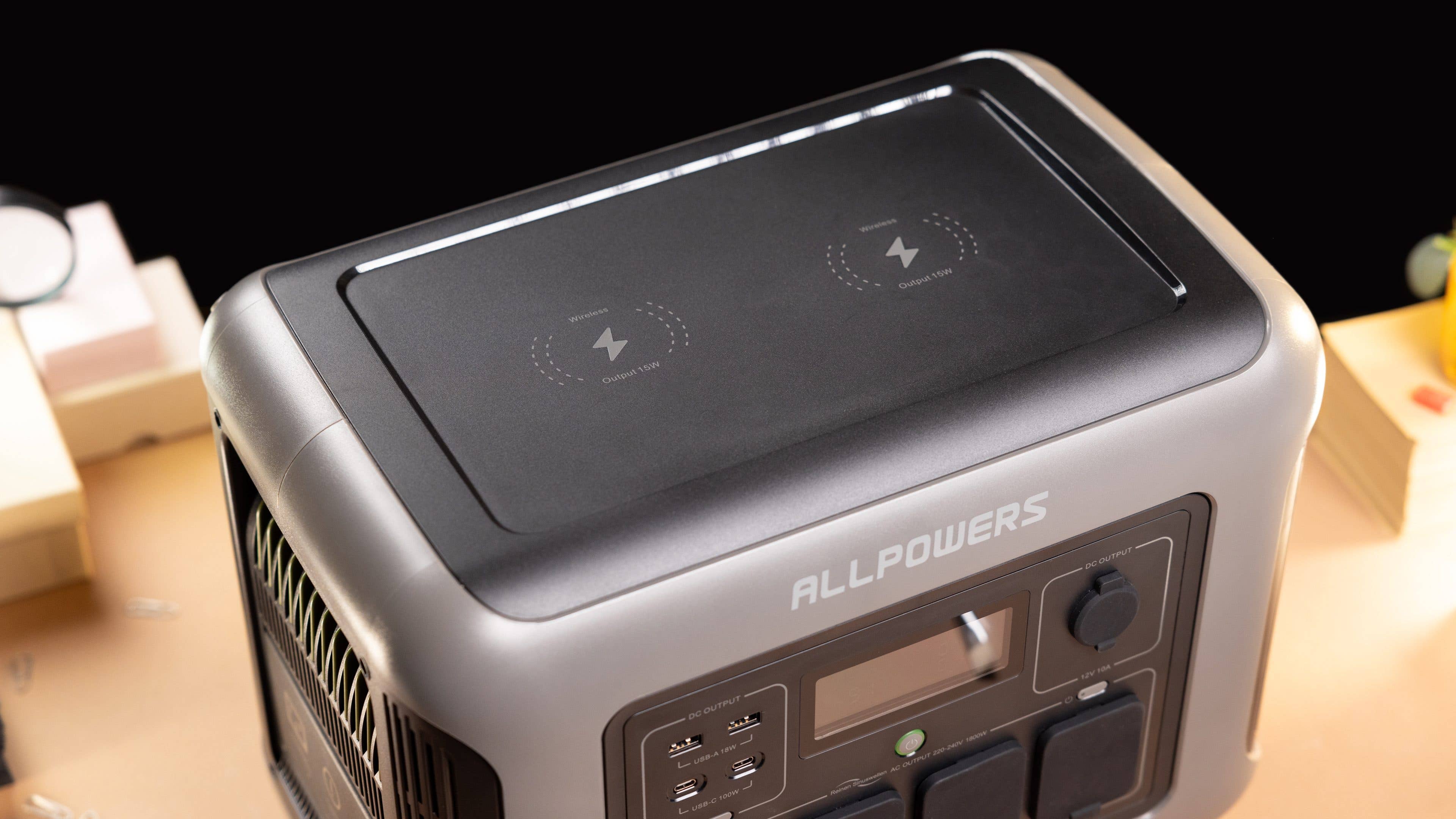

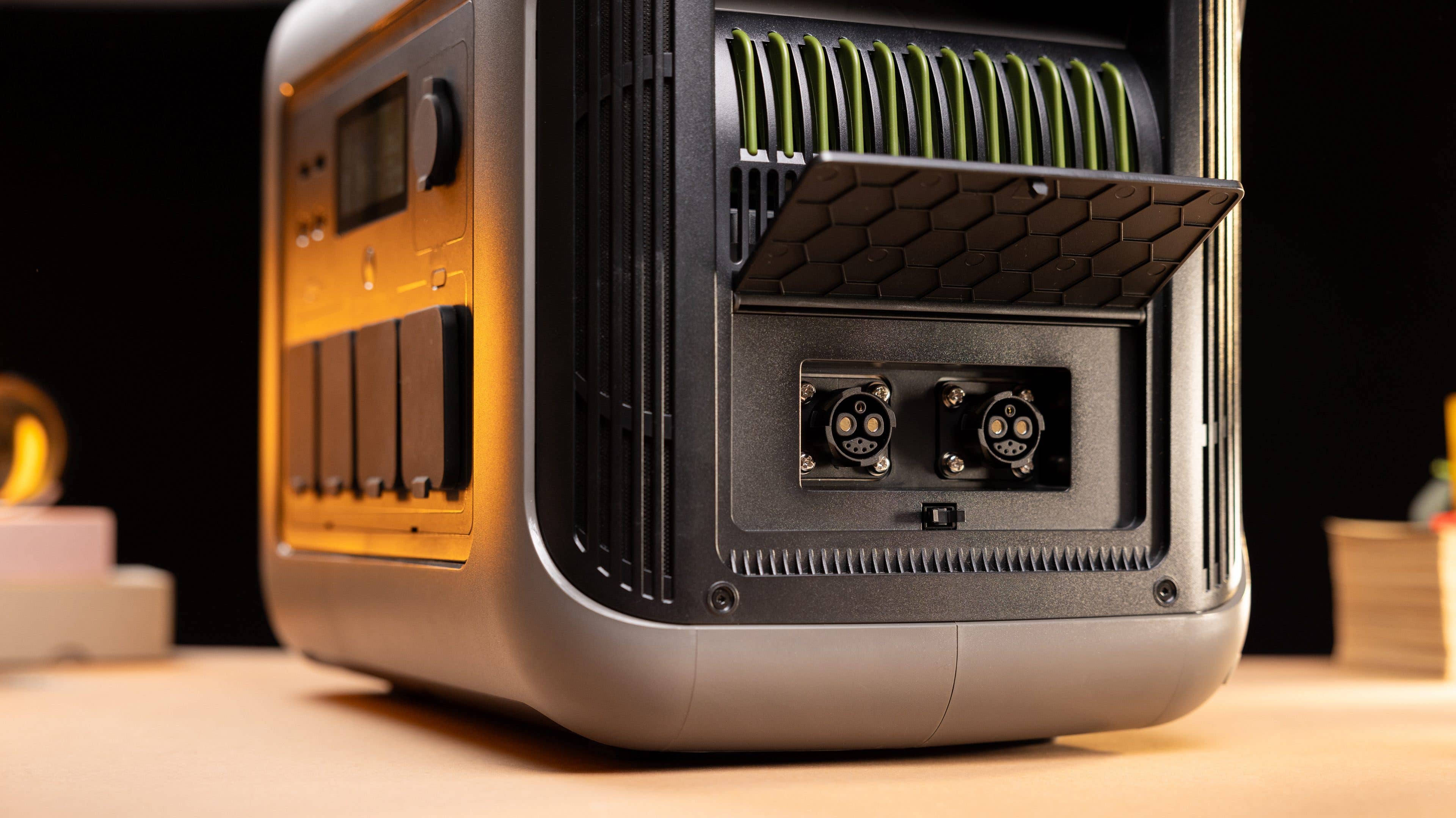

There are two battery connections on the left side of the R1500. Above the additional connections, you will find ventilation slots of the R1500. There is no earth port like on the Bluetti AC70. Last but not least, you will find two wireless charging pads on the top of the Allpowers R1500.
The ventilation slots look really distinctive right above the connections for expansion batteries.
On the left, you will find two connections for expansion batteries. Above that you can see the distinctive ventilation slots. / © nextpit Image source: nextpit

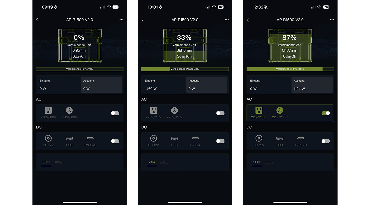

The Allpowers app is available to monitor and operate the Allpowers power station remotely. The emphasis here is monitoring, as the software support does not offer a particularly wide range of control options. Let’s begin with the setup. You can choose between a Bluetooth or WLAN connection.
We recommend connecting via Wi-Fi, as we had to add the R1500 every time we added the power station via Bluetooth in the app. It is possible this mode was primarily intended by the manufacturer for the setup process. Here’s a tip if the power station is not shown in the app during setup: Press the DC button for several seconds to enter the WLAN and Bluetooth pairing mode of the R1500.
The screen might be small, but it displays all the important information.
The small screen always keeps you up to date on the status of the input and output power. In pairing mode, the display shows you the Wi-Fi and Bluetooth icons. / © nextpit Image source: nextpit
The Allpowers app looks pretty minimal as do the number of setting options. In principle, you can only select the charging mode and control the AC and DC power supply.
In the main menu, you can see the battery status in addition to the input and output power. If you want to know how much longer the power station requires to charge, you will have to take a look at the small screen as the information is incorrectly displayed in the app. Finally, you have options for the charging mode in the other settings.
There are very limited setting options in the Allpowers app.
The setting options in the Allpowers app are limited. You can set the charging mode in the other settings. / © nextpit Image source: nextpit

A pair of Qi wireless are there for wireless charging options.
Forgot your smartphone’s charging cable? No problem! There are even two Qi pads on the top for wireless charging with up to 15 W. / © nextpit Image source: nextpit
