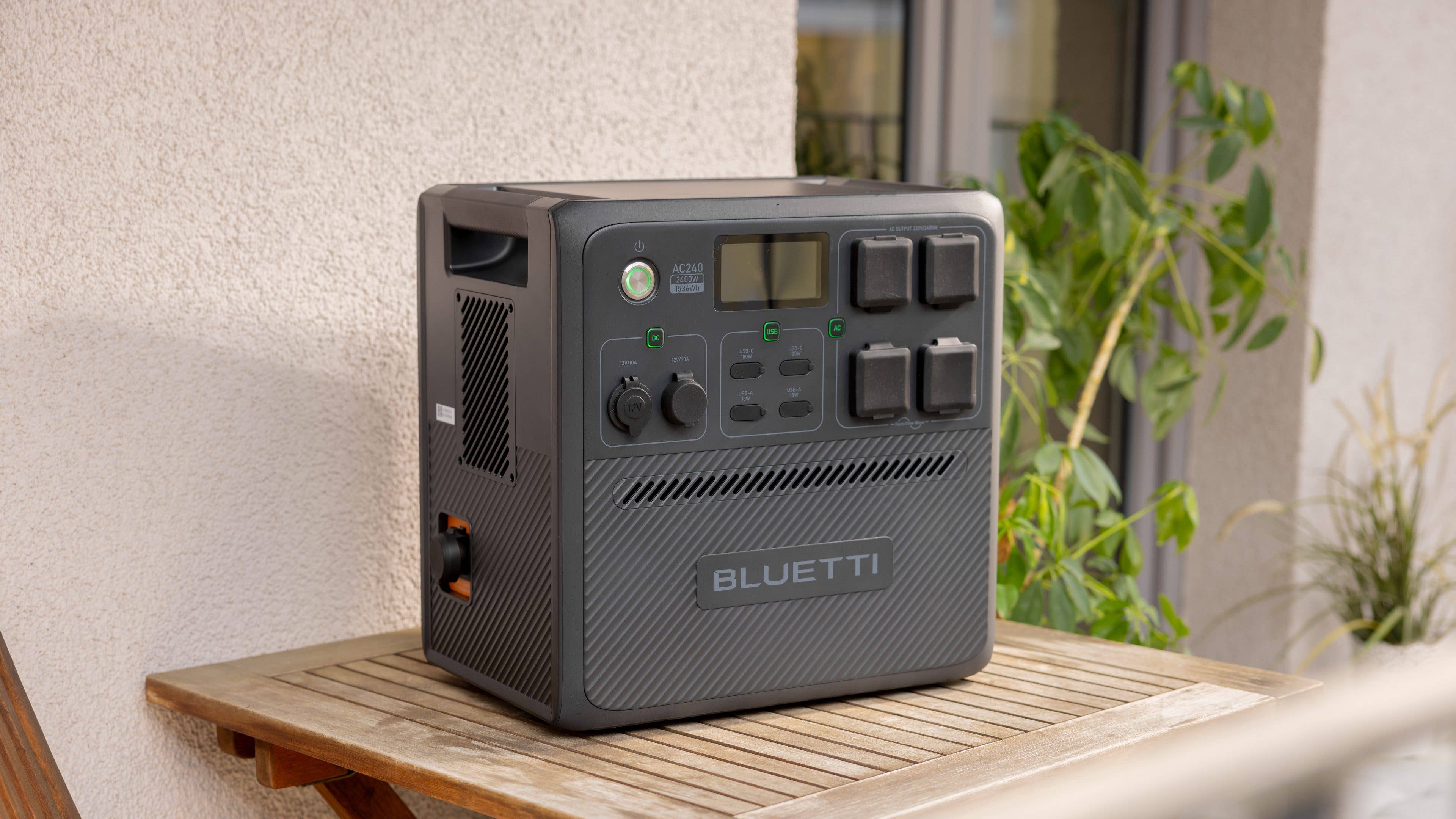

All power sockets in the Bluetti AC240 are covered.
The Bluetti AC240 is a large, elegant solar generator with a comprehensive range of sockets. You know what’s even better? All the sockets are protected by a rubber cover. / © nextpit Image source: nextpit

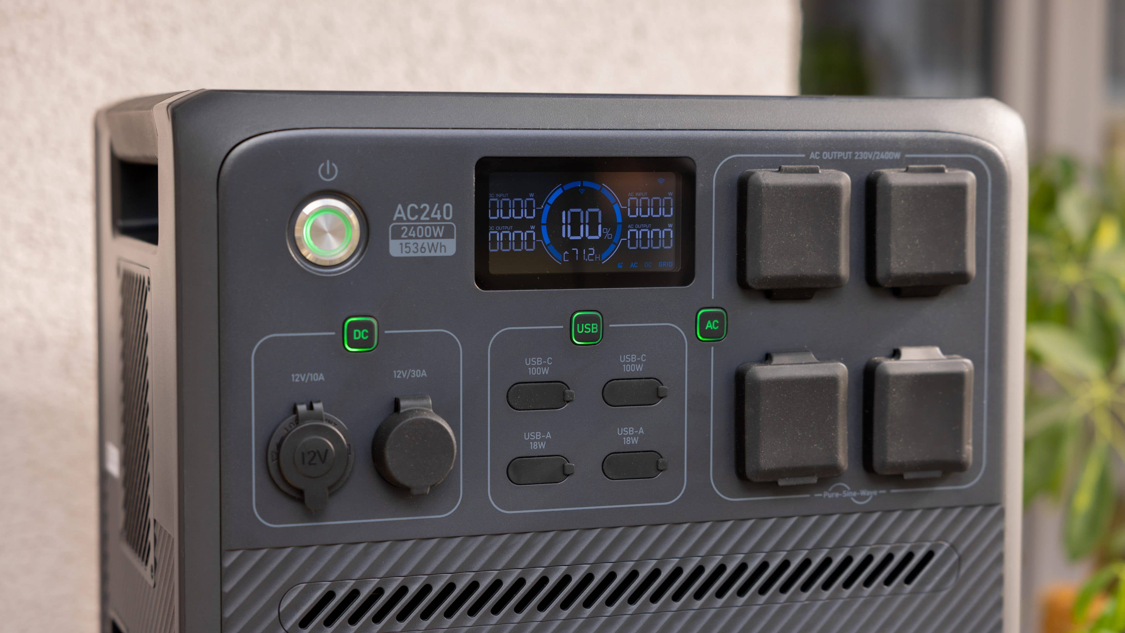

In front, there is a small display and ten sockets to choose from:
  • 4x 230 V sockets
  • 2x USB-C ports
  • 2x USB-A ports
  • 1x 12V cigarette lighter
  • 12V/30A socket for your camper van or boat
The fact that Bluetti offers protection of all sockets from dirt with rubber covers makes the electrical generator, despite its dimensions of 41.9 × 29.4 × 40.9 cm, a good option for camping.
What’s more, the AC240 is protected against water and dust with its IP65 certification. Bluetti also equipped it with rubber feet, ensuring the unit won’t slip or slide when you’re out on your boat. The bag that comes with the generator is also very practical.

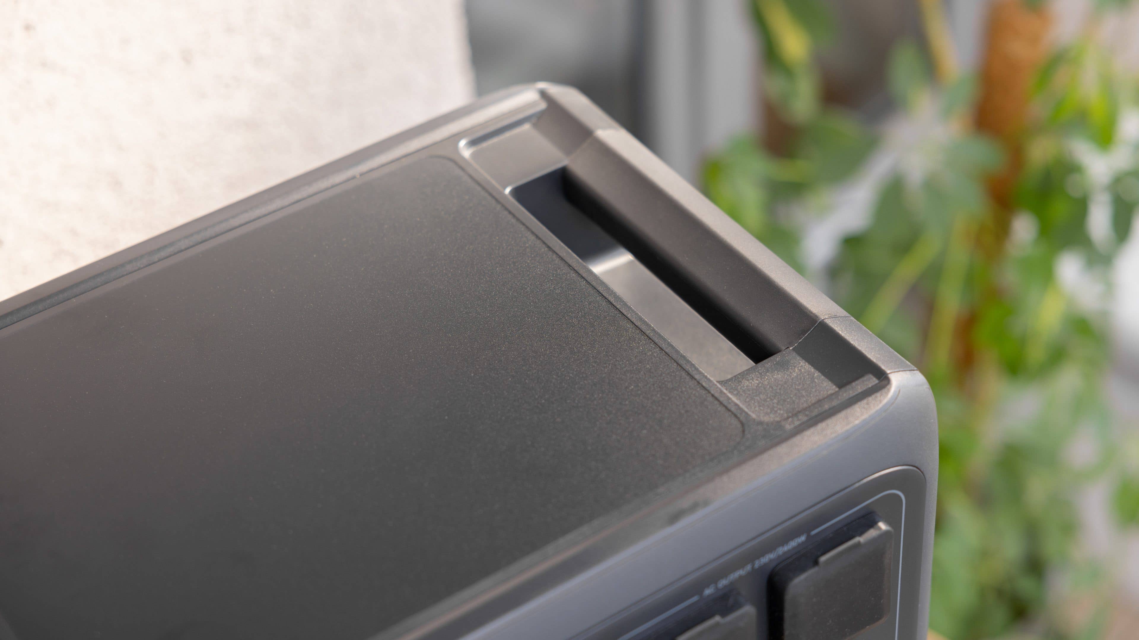

Side handles of the Bluetti AC240 ensure it is easily transported.
Don’t worry about transporting this solar generator. The well-positioned side handles won’t give you a headache when stowing it. / © nextpit Image source: nextpit

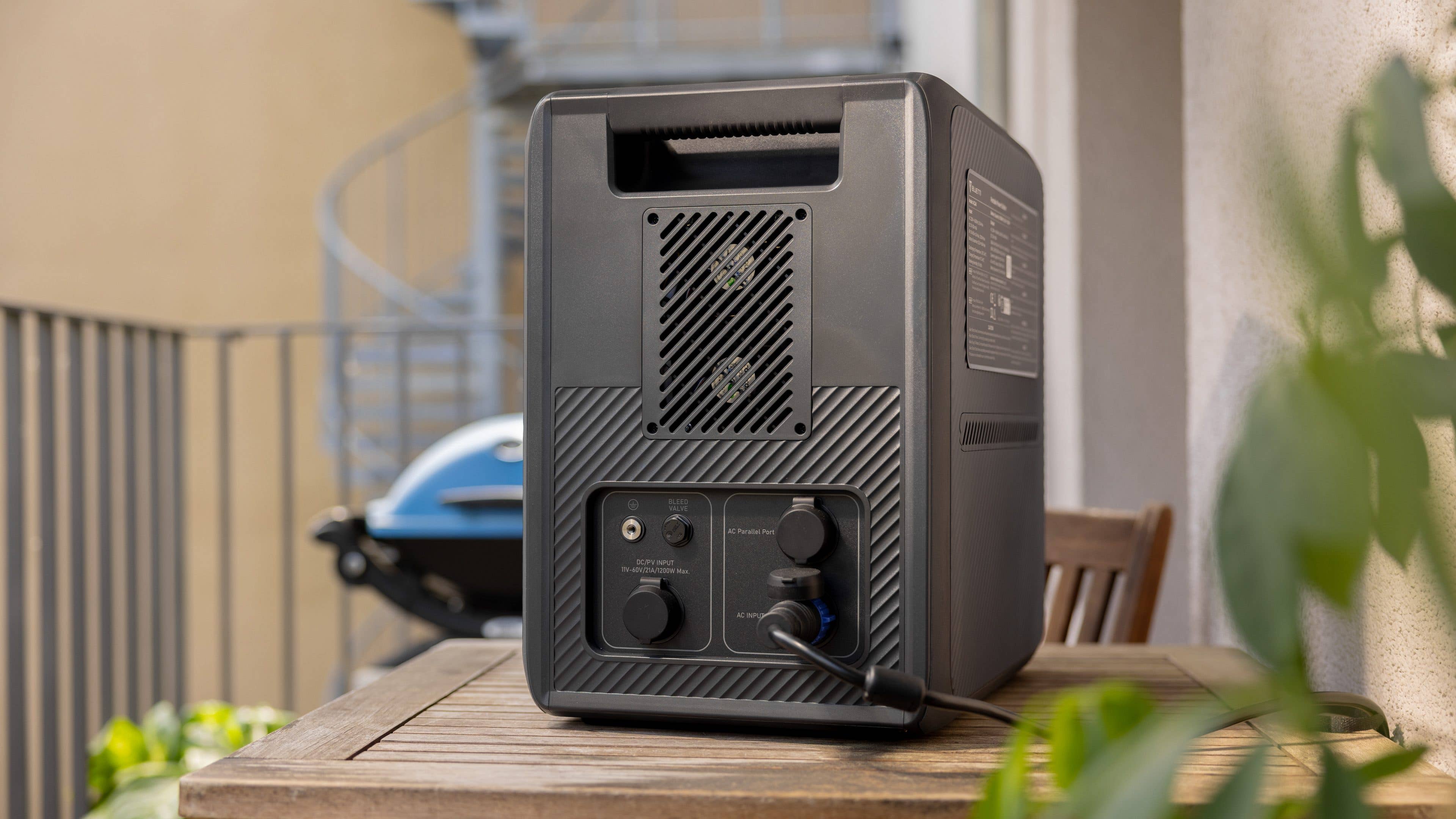

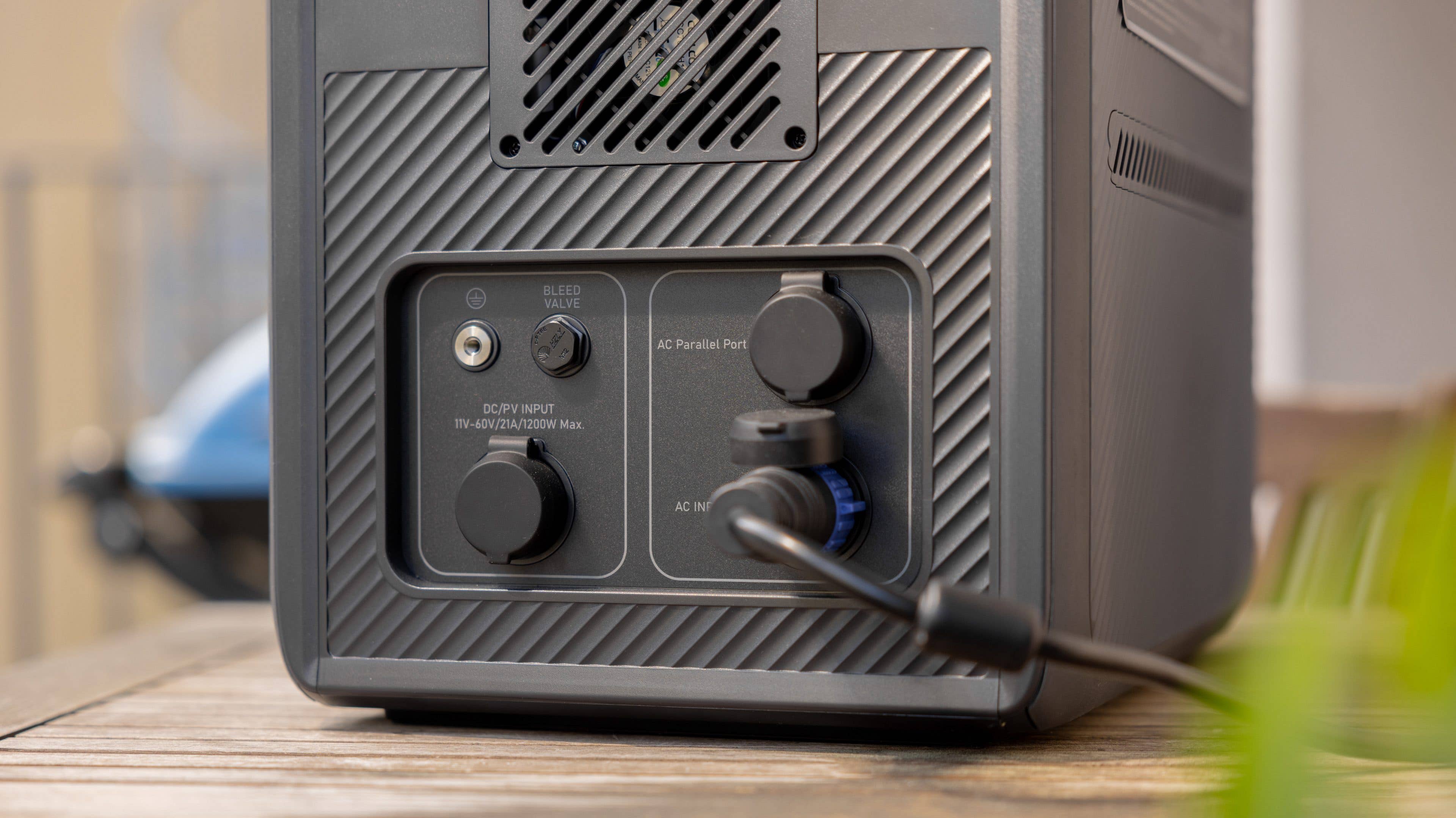

On the right of the generator is the connector to hook it up to an additional battery. Thanks to the AC240’s modular design, stacking Bluetti-B210 extension batteries is not a problem at all. On the left, you’ll find sockets to charge the AC240 with electricity. There’s also a grounding socket on this side.
The left side of the generator has sockets to supply power.
On the left side of the generator, Bluetti installed all the sockets to supply power. / © nextpit Image source: nextpit

You will not find yourself squinting when looking at the AC240
The AC240’s display is very legible and shows the most important information. / © nextpit Image source: nextpit

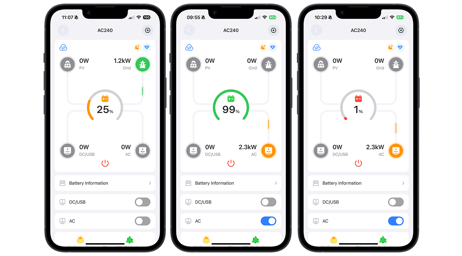

After setting it up, you’ll see the same information in the application’s main menu as on the screen. In addition to input and output power, you’ll always know the remaining battery life. It’s also useful to know how much longer the generator will be able to power connected devices.
The main screen shows the input and output power, and equally important, the remaining battery life.
The main menu of the Bluetti application shows you the input and output power. You can also see how much battery life you have left. / © nextpit Image source: nextpit

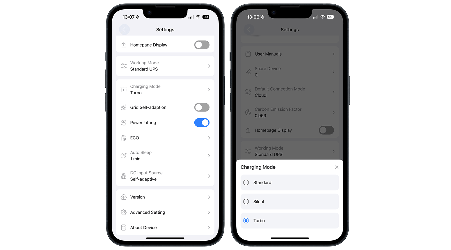

The advantage of the app is the diversity of its functions. In principle, you can control the AC240 as you would with the button layout. However, only the app lets you activate Power Lifting mode. This allows the generator to briefly increase output power up to 3600 W.
The settings let you activate the Power Lifting Mode, among others.
In the other settings, you can activate the “Power Lifting mode” and set the appropriate charging mode. / © nextpit Image source: nextpit
Bear in mind such power is only available for a fraction of a second. Alternatively, you can set the charging mode of the Bluetti solar generator in the app with three levels to choose from. The slower the level, the longer you can preserve the AC240’s battery.

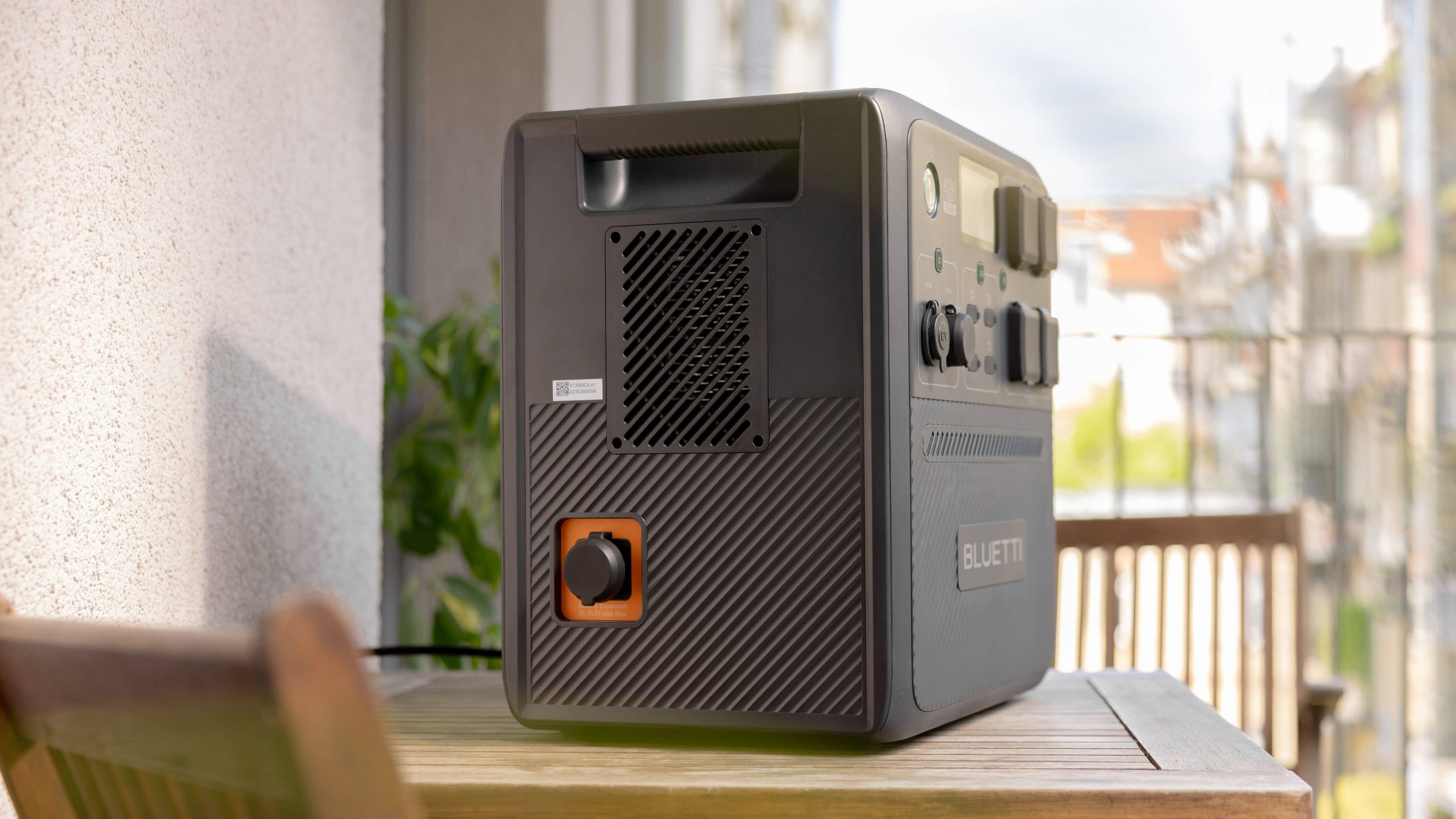

A socket for a B210 battery is located on the right, allowing it to be topped up to 10 kWh
On the right lies a socket for a B210 battery, which can be topped up to 10 kWh. / © nextpit Image source: nextpit
