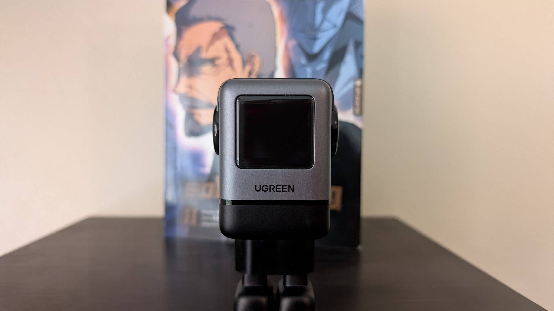

Compared to its predecessor, the Ugreen Nexode Robot GaN 65W, not much has changed with the Ugreen Uno 100W. The main reason is to personalize an everyday product and to do away with the usual clunky design. The emojis are a little more detailed than before and I have to admit, it was fun to watch the little guy charging.

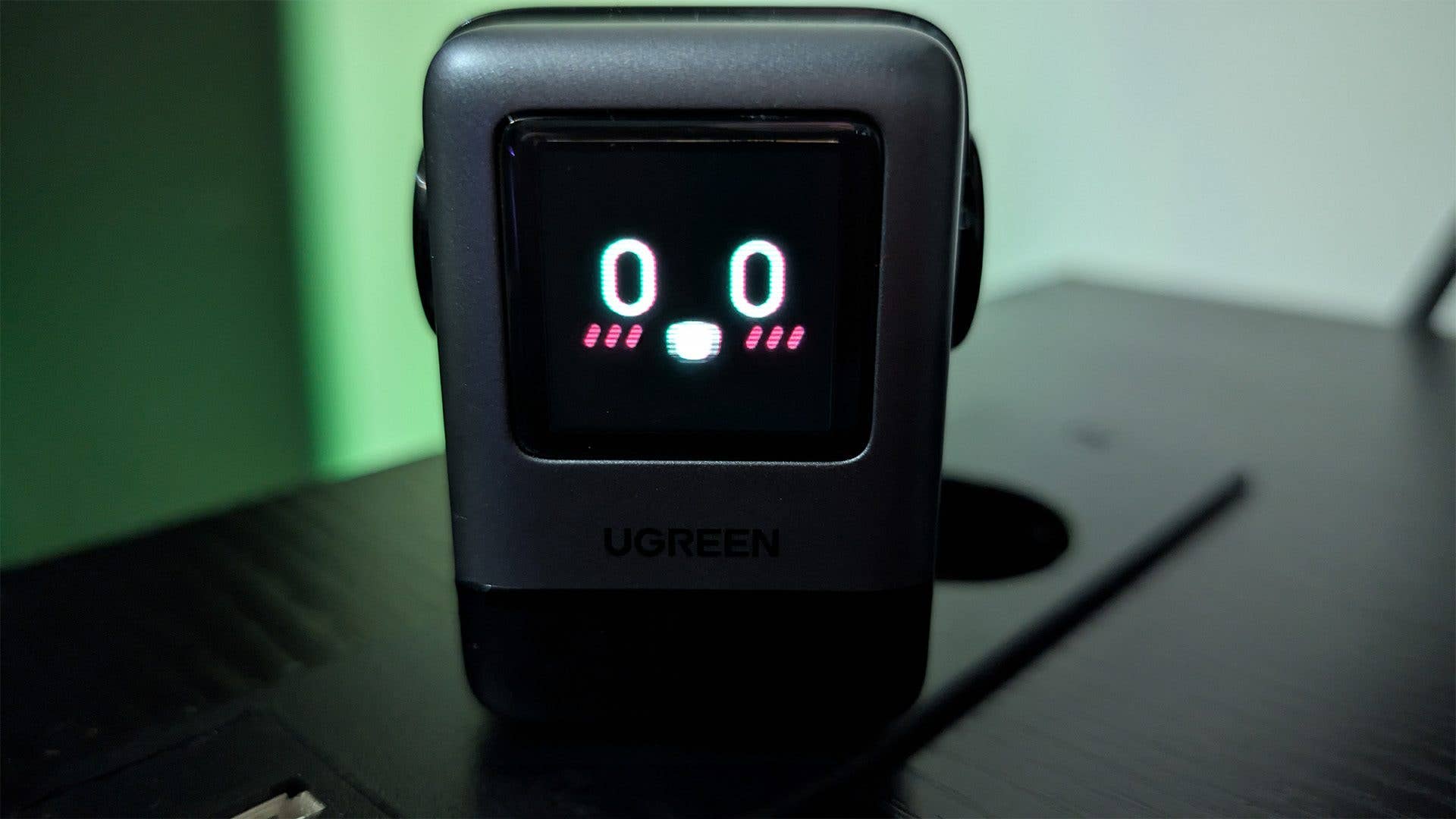

The Ugreen Uno offers a total of three standard expressions. As mentioned, it provides information about whether your device is currently in fast charging mode, trickle charging, or fully charged. During the charging process, the tiny Uno can also display various facial expressions, making the device look even livelier than its predecessor.

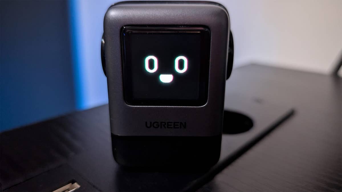

Even without a connected device, the Ugreen Uno 100W is really happy.

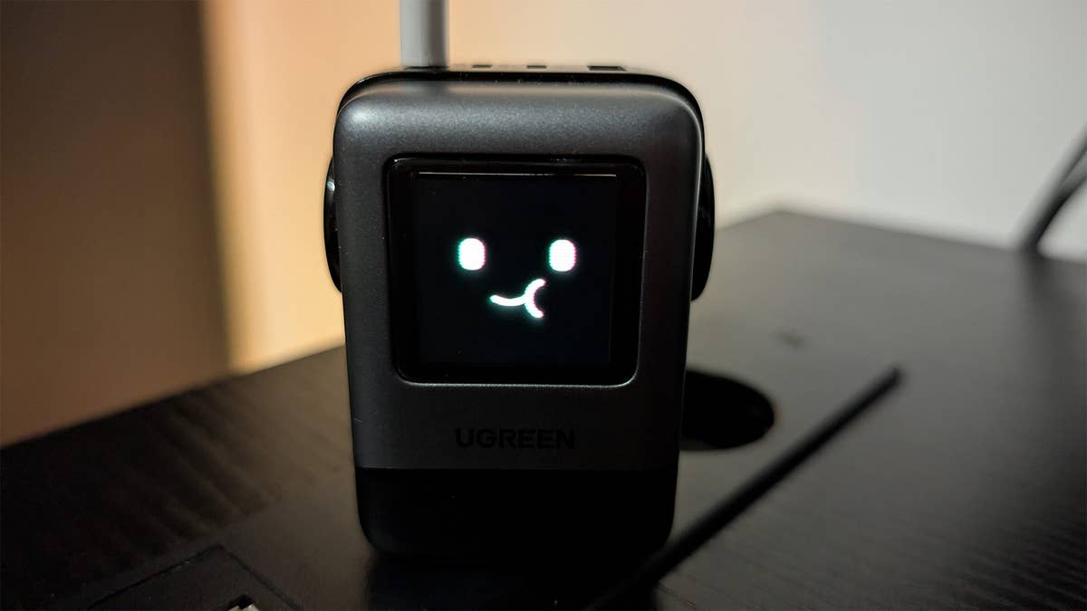

In fast charging mode, it looks like the Ugreen Uno 100W is gobbling up the power.

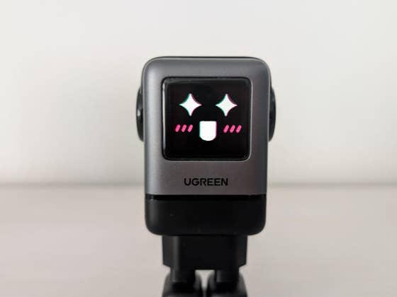

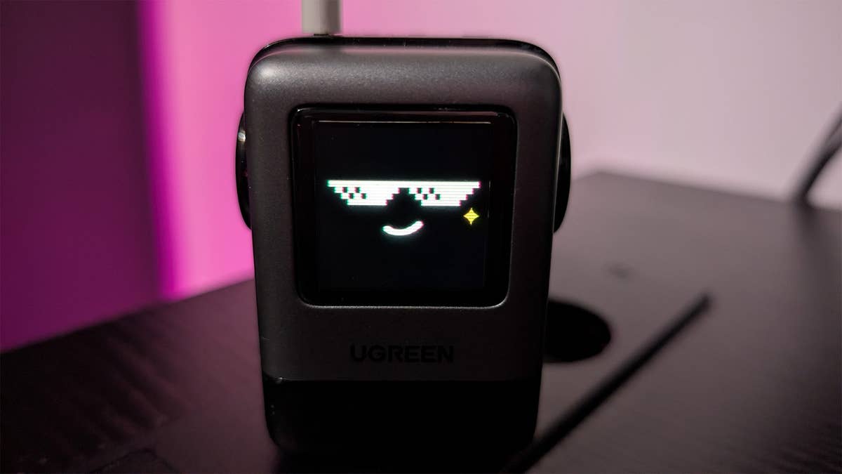

The Ugreen Uno 100W becomes really cool once it has charged a device.
The Trickle Charge in particular is something special. It lets you know that your device is fully charged, but also, the charging speed is significantly slower now to conserve battery life. The square design is reminiscent of a mini robot and is rather compact. This means it fits easily into any pants pocket or handbag.

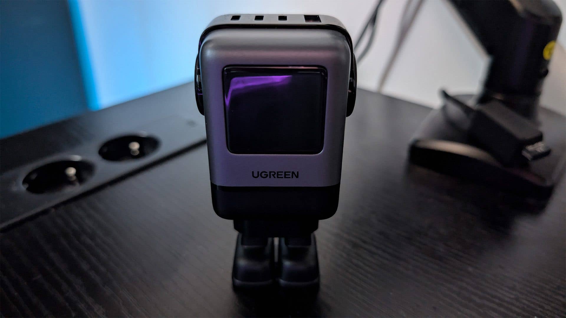

However, there were a few things that bothered me. First, the charger weighs 263 grams and is even heavier than my Google Pixel 9 Pro, which surprised me quite a bit. However, this is logical when you consider that the little guy can charge up to four devices simultaneously. The actually good magnetic feet are somewhat more problematic. Due to its relatively heavy weight, you can only attach them on flat surfaces. The Ugreen Uno slides down as soon as there is a gradient.
The Ugreen charger is also not necessarily suitable for a dark bedroom. This is because the TFT display is always on, regardless of whether a device is connected or not. However, as the brightness level is not particularly high, it will only disturb you at night if you look directly at it.

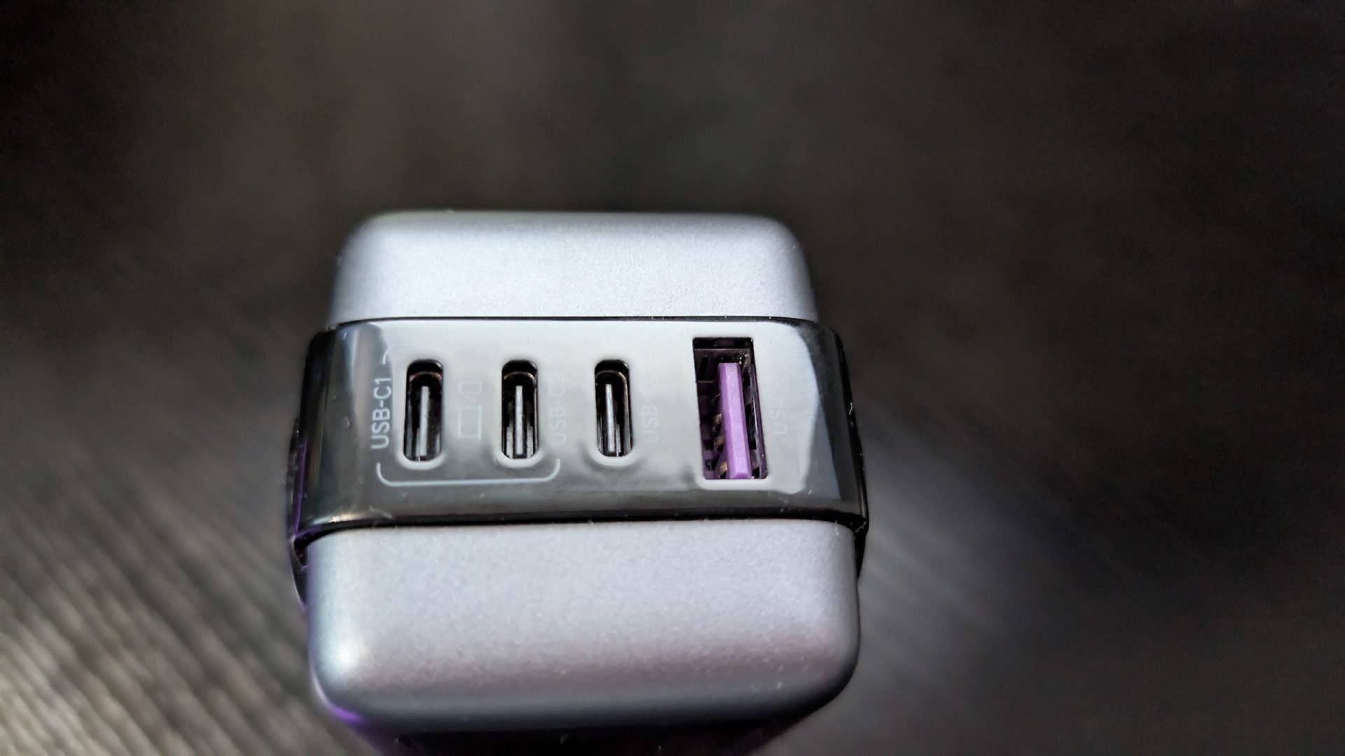

First things first: Ugreen splitting the charging power between four USB ports is nothing new. Multi-port chargers offer a total output that is normally split between different inputs. This is also the case with the Ugreen Uno 100W. The Robot Charger offers a total of three USB-C ports and one USB-A port. The former are compatible with common charging protocols like USB PD 3.0 and Quick Charge 4.0. Needless to say, PPS (Programmable Power Supply) is also available.
The more ports you use, the lower the power is channeled to the individual ports. The USB-C ports offer fixed voltages of 5, 9, 12, 15 and 20 volts. The current differs between the individual ports. While this is between 3 and 5 amps for the USB-C1 and USB-C2 ports, the USB-C3 output offers 3 to 1.5 amps. The lower the voltage, the higher the amperage for this port.
Figures are slightly different for the USB-A output. While you can still work with 3 amps at 5 volts, the current drops to 1.5 amps at 12 volts. However, the power figures are probably more important for most of you. You can view the table below to find the respective charging capacities.
