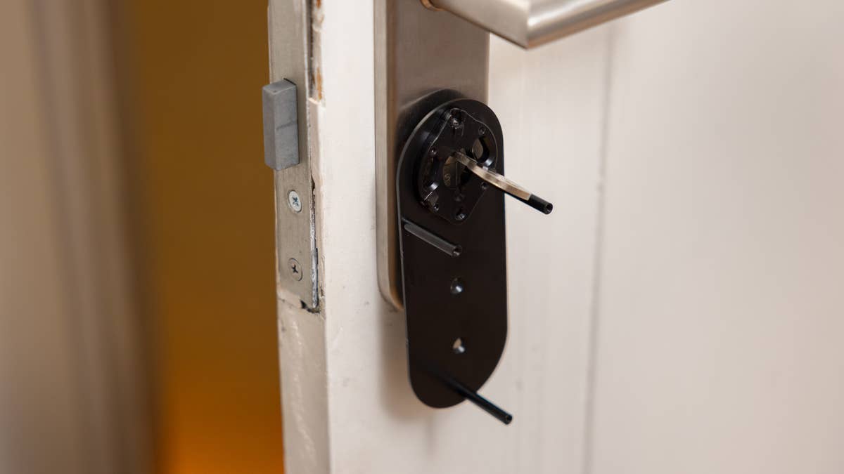

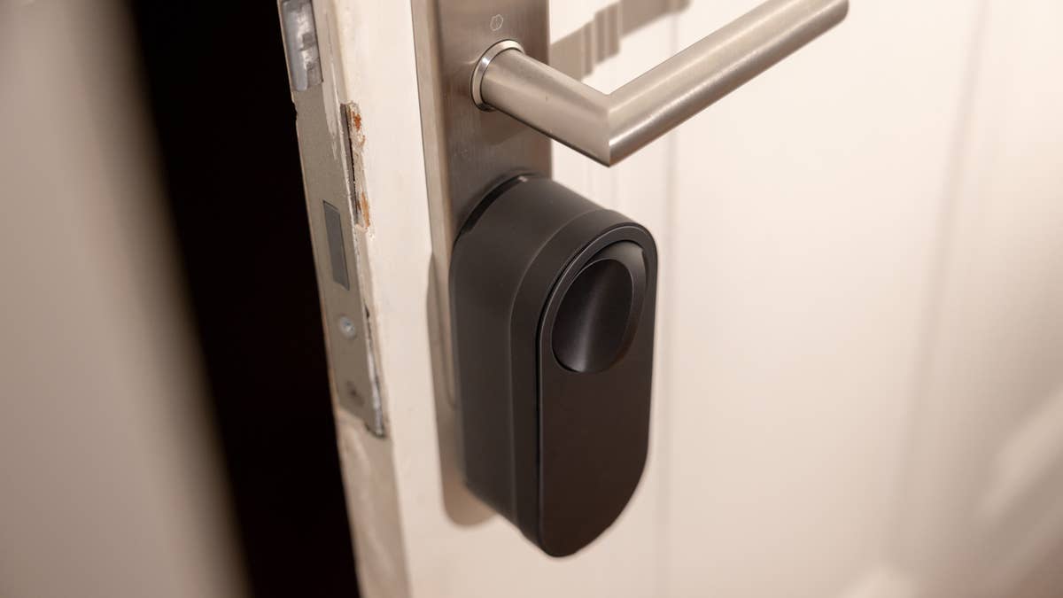

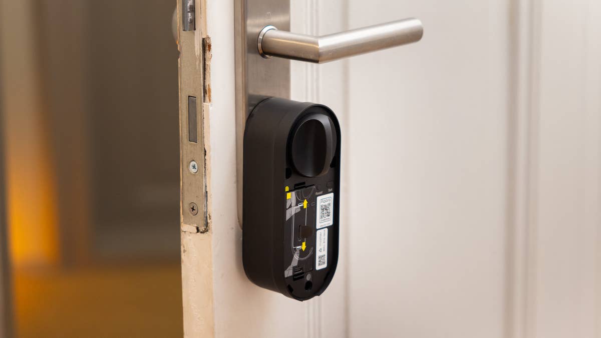

Installing the smart door lock is simple. First, you attach the fixed plate using the screws and the small Allen key. Then screw the smart door lock to the fixing plate. We used three of the black screws for this. Now insert the battery, scan the QR code in the Aqara Home app, and put the cover on.
Aqara U200 Smart Lock fixing plate
Installation is easy: First, you put the fixing plate on and tighten the screws.
Quelle: nextpit
Aqara U200 Smart Lock without cover
Then put the electronic door lock on and screw it tightly.
Quelle: nextpit

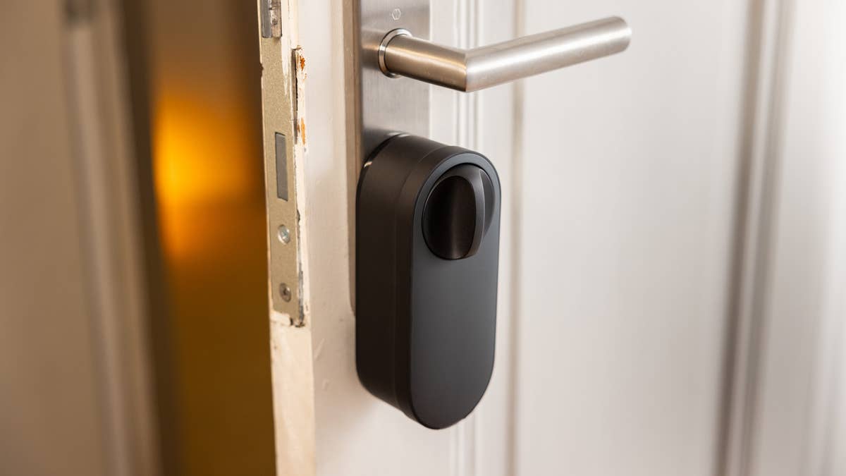

Aqara U200 Smart Lock viewed from inside
Insert the battery, scan the QR code in the Aqara Home app and put the cover on.
Quelle: nextpit
Aqara Smart Lock U200 close-up
The Aqara Smart Lock U200 is an unobtrusive, yet stylish electronic door lock.
Quelle: nextpit

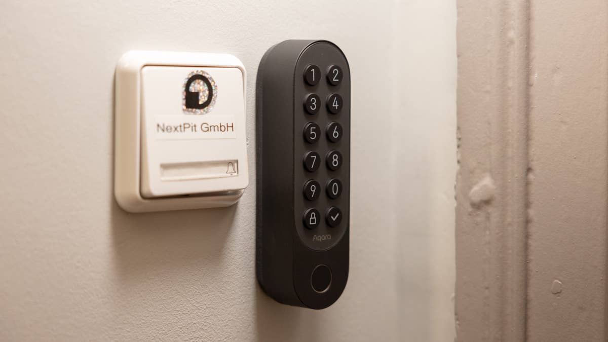

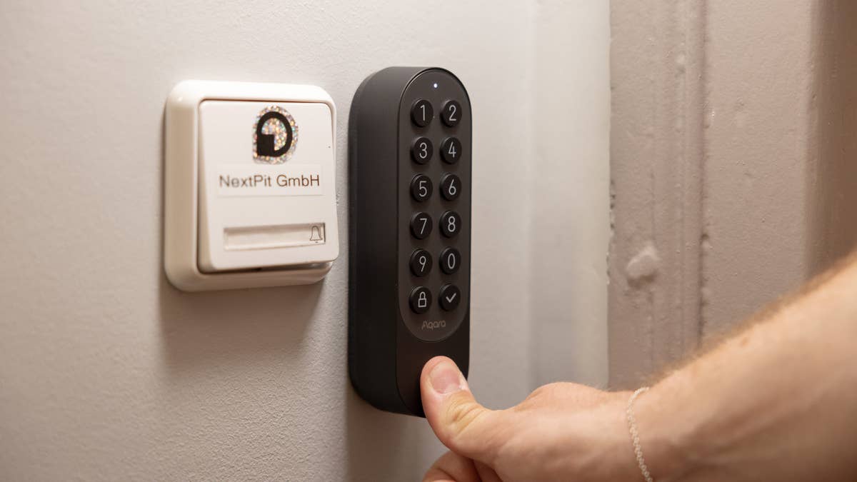

If you have any complications or simply can’t make any more progress, we recommend that you take a look at the really detailed operating instructions. You will also need to register your e-mail address in the Aqara Home app. Last but not least, you need to find a place for the keypad. The keypad has a sticky back as soon as you peel off the paper strip.
For our test, we attached the Keypad to a hallway wall. At no time were we worried that the Keypad would not hold and fall off. Note that the lock and Keypad must not be more than two meters apart.
Aqara Smart Lock U200 Keypad from the side
Here you can see the keypad of the U200. It has a double-sided tape on the back.
Quelle: nextpit
Aqara Smart Lock U200 Keypad front view
The keypadu0027s fingerprint scanner worked well in our tests.
Quelle: nextpit

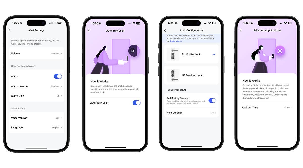

The Aqara Home app offers a wide range of settings options. You can save up to 50 users in the app, each with five fingerprints, two passwords, and two NFC cards.

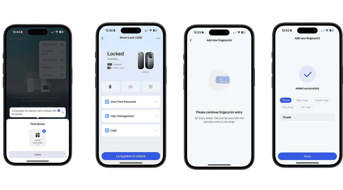

Without us even selecting anything in the app, the app offers to add the Aqara Smart Lock U200. Since we did not use an Aqara M3 Hub in the test, the smart door lock is grayed out in the app and thus incorrectly displayed as offline. However, Aqara is aware of this bug and is already working on a solution.
In the main menu of the door lock, you can set a one-time password for guests or add profiles in the user menu. Here you enter the name, add a fingerprint of the person, and can also enter an NFC device to open the front door. To add an Apple Home Key in Apple Home, however, you need a so-called Thread Border Router from Apple.
As with logins on old iPhone models, you place your finger on the fingerprint scanner several times until the device registers the grooves on your finger. Fingerprint recognition works shockingly well in everyday use. Every stored finger is recognized by the keypad straight away. To be honest, we thought setting up a password or adding an Aqara NFC card was almost superfluous because the fingerprint recognition worked so well.
Aqara U200 Smart Lock app screenshots
Setting up the Aqara Smart Lock U200 worked as expected. After you have saved a fingerprint, you specify which one you have scanned.
Quelle: nextpit
In the Aqara Home app there are numerous settings for the alarm and how the opening mechanism should work. In short, a really clear and feature-rich software.
Quelle: nextpit

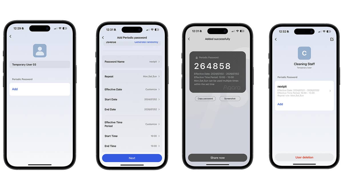

If you have guests for a certain period of time, you can create temporary passwords. Here you specify the period, days, and times at which the created password grants access.
Quelle: nextpit
The principle of the smart door lock is very simple. First of all, you press any button on the keypad so that the keypad wakes up from hibernation. Then you hold your saved finger against the fingerprint reader and press the ✔️ checkmark button to open the door. In the app, you can set how many seconds the door latch should remain retracted.
Aqara has not neglected the security aspect either. If ten “wrong” fingers have been recognized or incorrect passwords have been entered, opening the door with a fingerprint, password, or NFC card is blocked. Then you can only get in with your house key. In the app, you specify how long the lock should remain “locked”. From 0 to 30 minutes, you are very flexible in your choice.
The option to create a temporary password is particularly practical for Airbnb operators. Here you define the period, days. and times for the selected days when people to whom you send the created password will come to the apartment. If you wish, you can automatically generate a six- to ten-digit password.
According to Aqara, the battery life is a full six months with eight openings per day with the fingerprint. Access with an Aqara NFC card only works if you have previously added the smart door lock to Apple Home. In addition to Apple Home, the Aqara Smart Lock U200 also supports Alexa and Google Home via Matter.
