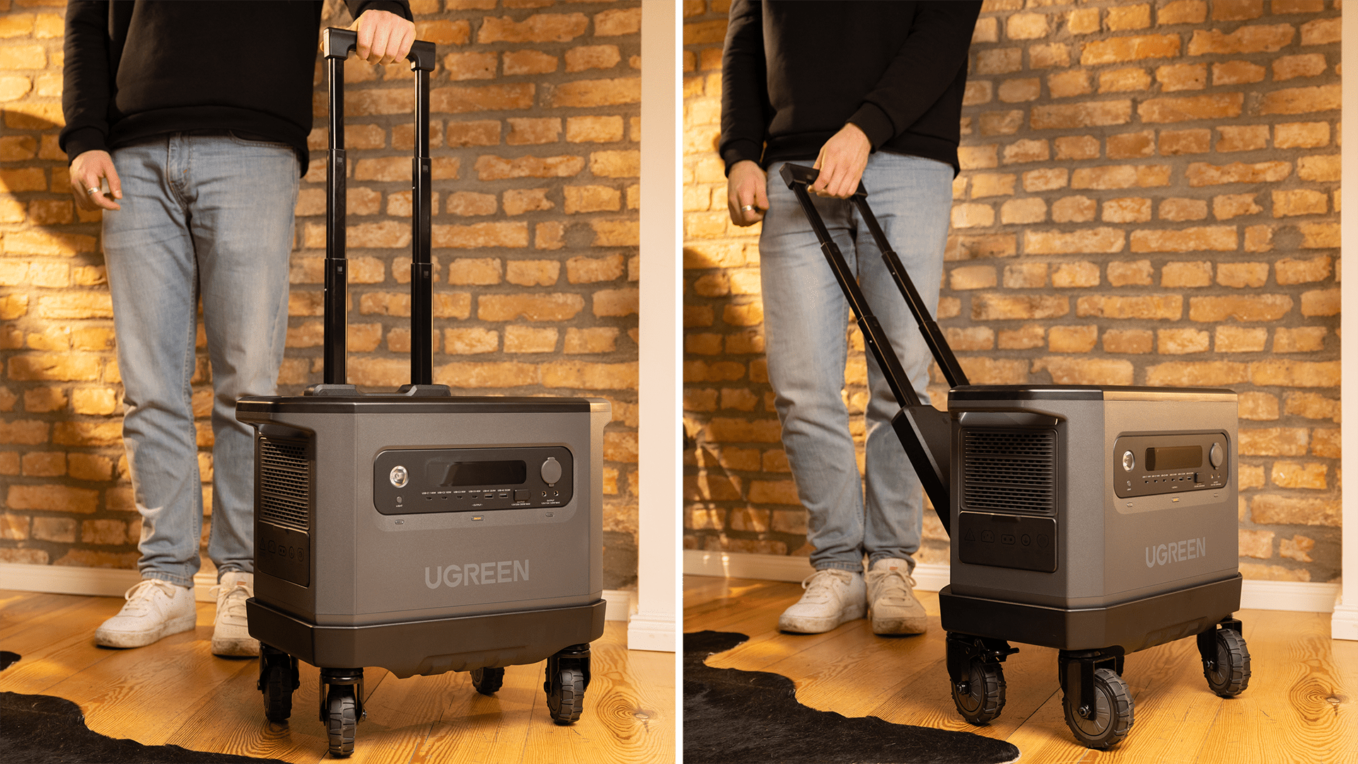

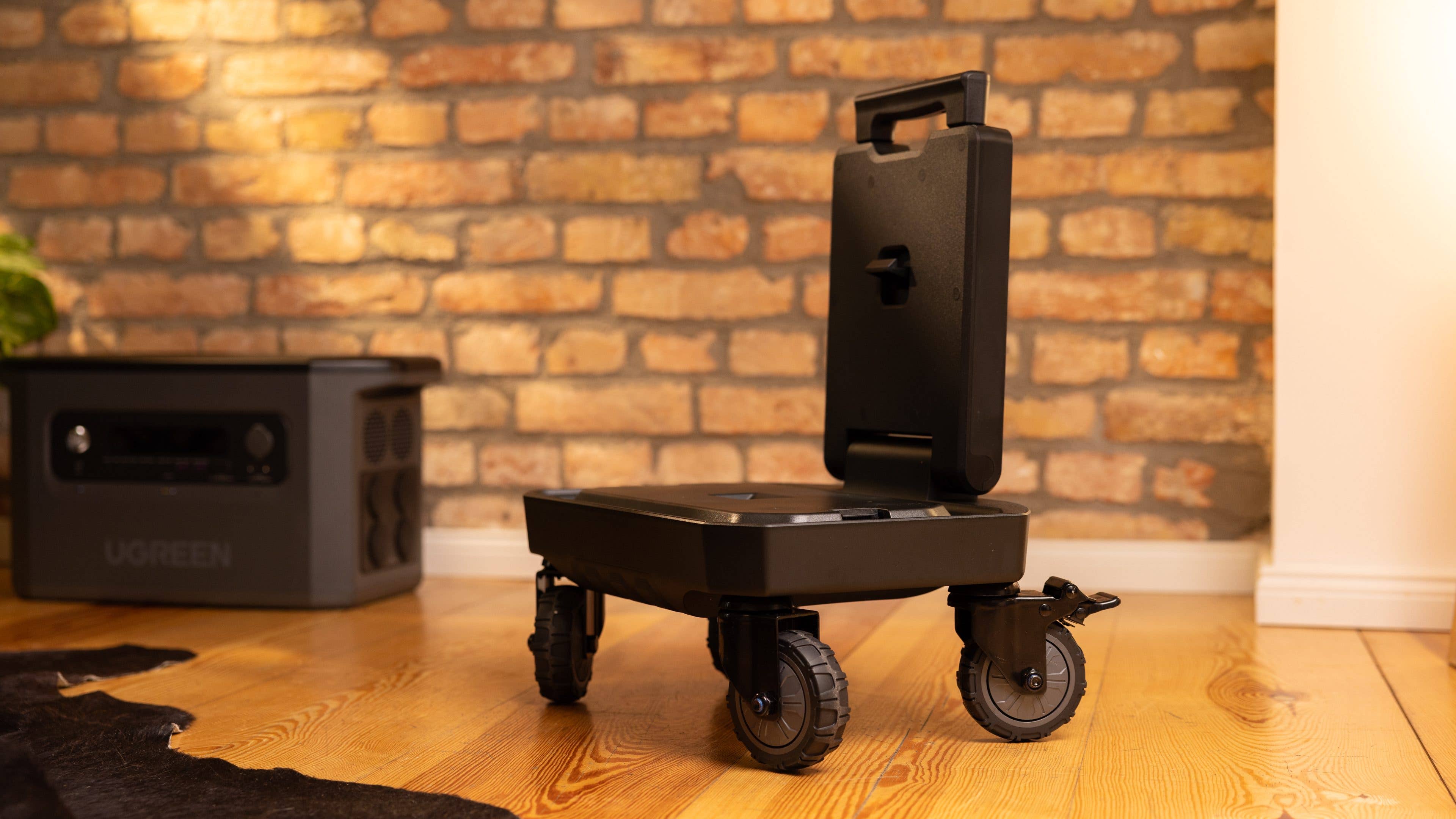

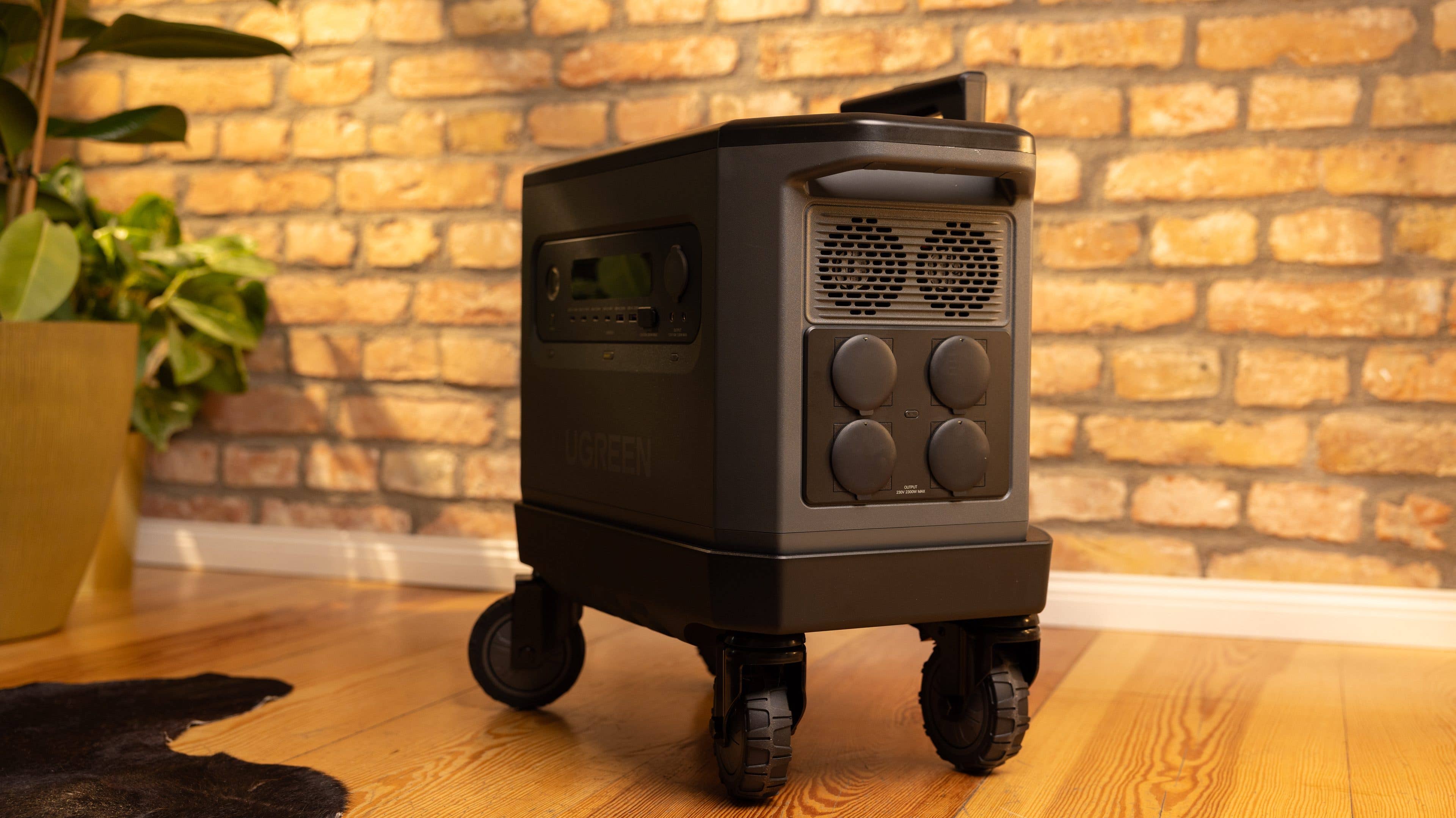

Unpacking the Ugreen PowerRoam 2200 sprung a few surprises. First, within the huge box, you will find another large package that contains a trolley. No, we're not pulling your leg: Ugreen doesn't permanently attach the castors to the power station but includes a trolley instead.
Ugreen PowerRoam 2200 comes with a trolley.
No, this is not a trolley to transport your crates of water. Ugreen has come up with the smart idea of designing a trolley to make transporting the PowerRoam 2200 as easy as possible. / © nextpit
Recently, nextpit has already taken a close look at a number of rollable power stations such as the Fossibot F3600 or the Oukitel BP5000 (review). What Ugreen has come up with for the PowerRoam 2200 is simply ingenious. You place the Powerstation on the trolley and tilt the extendable handle to bring it with you wherever you go.
The Ugreen PowerRoam 2200's trolley is highly versatile.
Not only can you easily move the Powerstation around on a trolley, you can even tilt the extendable handle to your liking without the handle falling off. / © nextpit
Transporting the power station on the trolley is effortless. The Ugreen PowerRoam 2200 weighs a mere 22.5 kg. If you were to transport the power station using the trolley, you will hardly be encumbered by the weight of the 2 kWh power station. Just so you might drop your jaw further—the PowerRoam 2200 measures 54 × 25 × 29 cm.

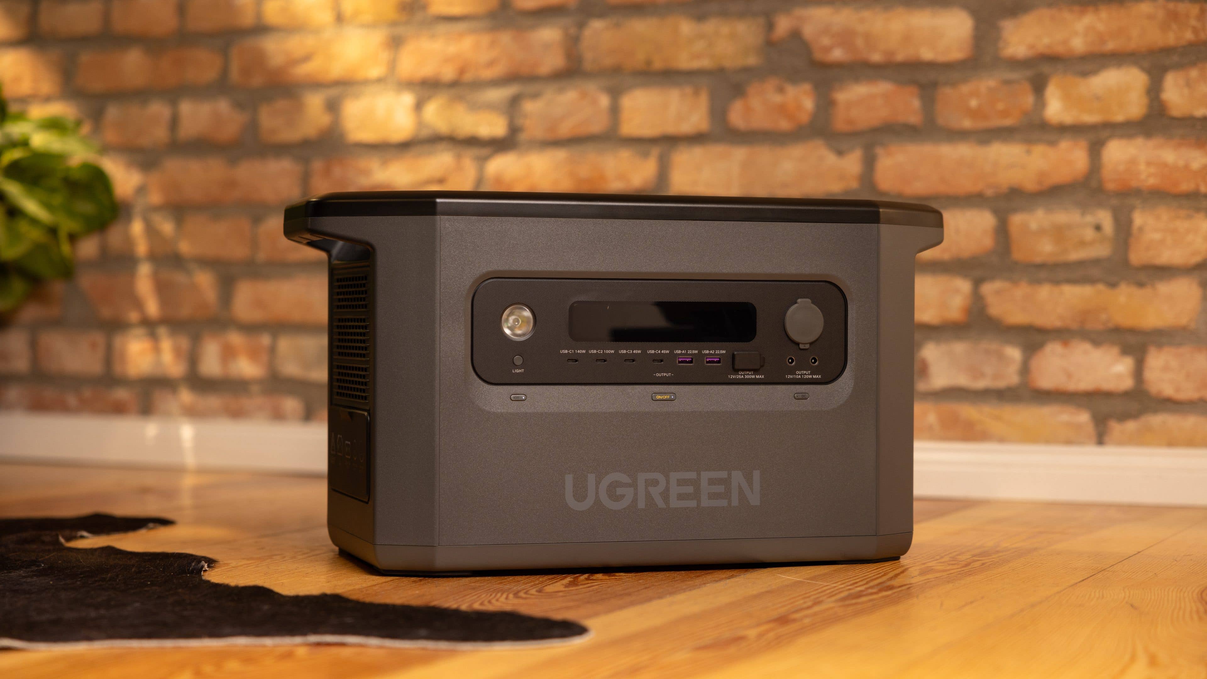

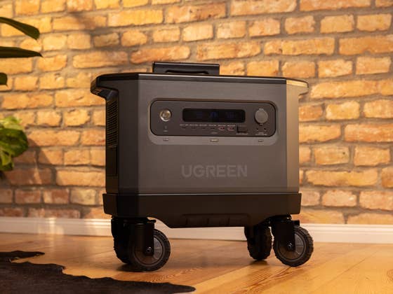

The design is simple yet of high quality. As with the PowerRoam 1200, Ugreen has also equipped the PowerRoam 2200 with an identical black-grey color scheme. You have two side handles to hold on to if you decide to use the more elaborate transport option.
The Ugreen PowerRoam 2200 comes with a wider display.
The Ugreen PowerRoam 2200 does not have an eye-catching design. What is more striking, however, is the screen, which Ugreen has extended in width. / © nextpit
Ugreen installed a display on the front of the power box, which we will look at in more detail in the next section of the review. The Ugreen PowerRoam 2200 offers you a total of 16 connections:

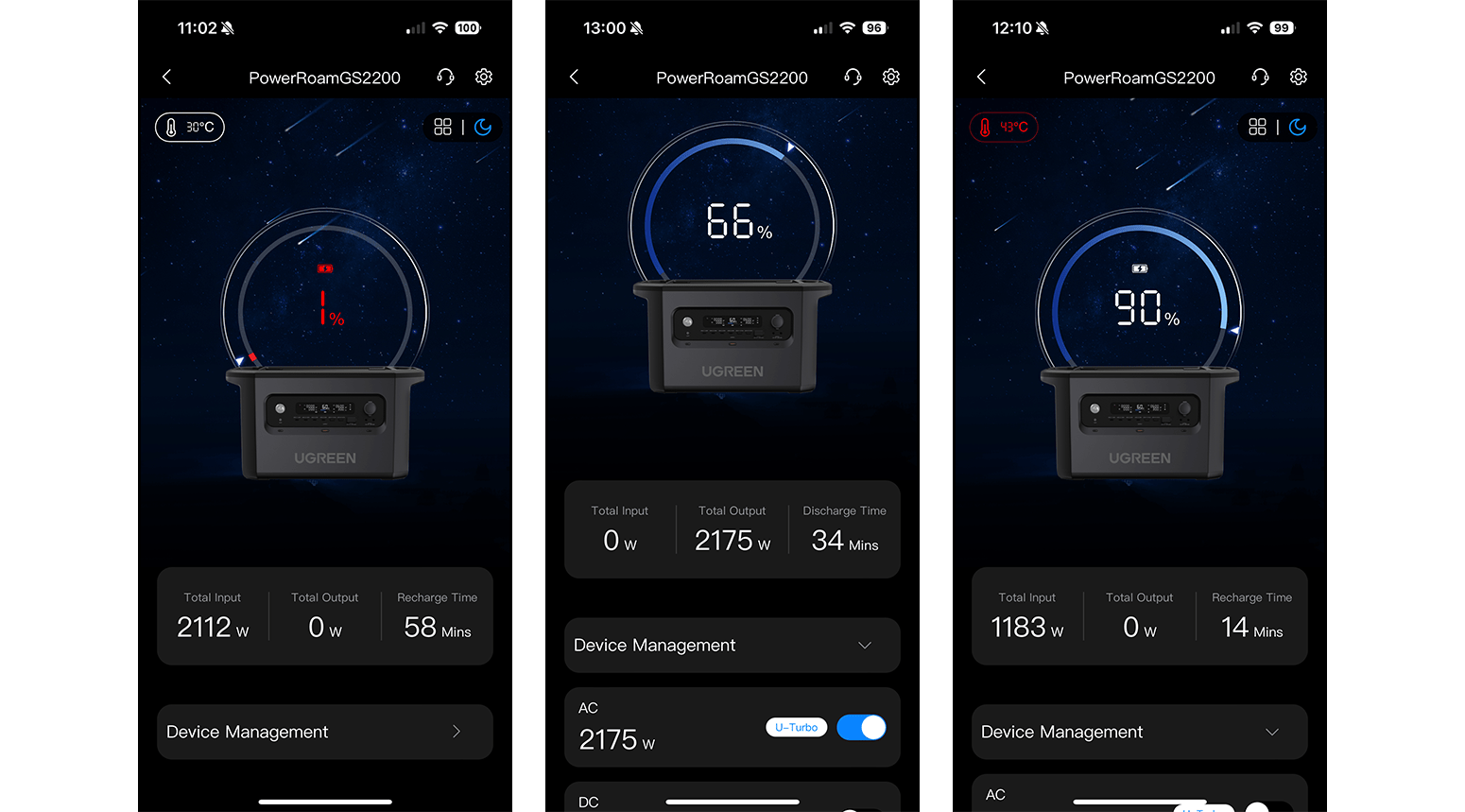

The app is very easy to use. In the main menu, you can see the remaining battery status, input and output power, and how much longer the power station can still supply connected devices with energy. You can also view at a glance on how much time is left to charge the PowerRoam 2200.
The Ugreen app makes it easy to configure everything.
In the main menu of the Ugreen app, you have all the information about the input and output power of the PowerRoam 2200. / © nextpit

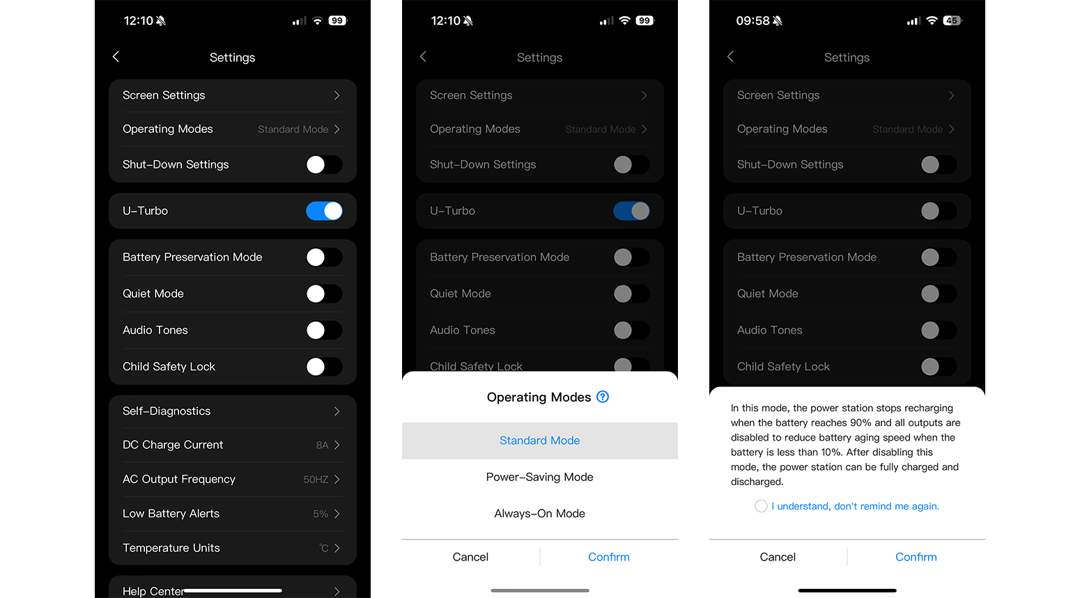

In the other settings, the Ugreen app offers you additional options to configure the power station according to your preference. It is here you can use the slider to activate the so-called U-Turbo to obtain a maximum output power of 3,500 W for a very brief moment.
The app also has additional settings for operation. Ugreen offers you three setting options here. Last but not least, the app provides you with an option of setting the power station to charge up to a maximum of 90 percent and retain a minimum of 10 percent battery life.
Ugreen PowerRoam 2200 app lets you make different control changes.
In the other settings, you can make changes to the operation and charging process of the power station. / © nextpit

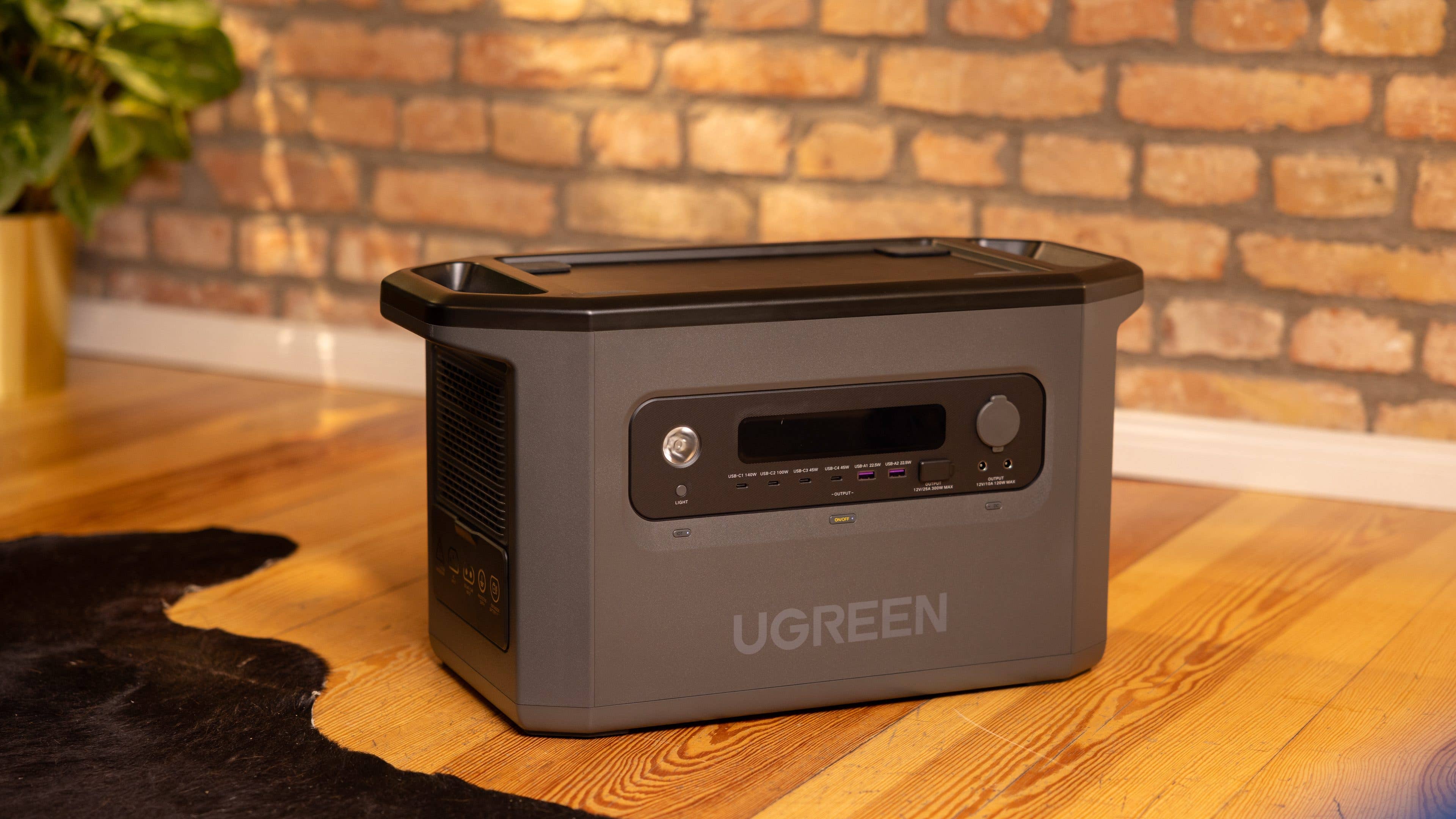

The output power is just as impressive. The PowerRoam 2200 delivers a constant 2,400 W of juice. If the situation calls for the use of heavy equipment, the power station briefly increases the output to 3,500 W. In full swing, the power station is not a cause for concern. During our review, we recorded a noise level of 51 db when discharging and 44 db when charging. While we're on the subject of charging, you only need to allow 1.5 hours for the entire charging process to complete.
Ugreen PowerRoam 2200 has ports on the left and right.
The left side of the PowerRoam 2200 is equipped with four Schuko sockets. Each individual socket is protected by a rubber cover. The vents are also located on this side. / © nextpit
Measured against the capacity of 2 kWh, this is a relatively short charging time. The reason for this is the fact that the Ugreen power station charges at 2,200 W from the socket. To round off the topic of charging, we would like to point out that you don't just have to plug the power station into the socket for additional energy.
A protective flap over the ports ensures greater safety.
On the right, Ugreen placed all the connections to fill the power station with fresh energy. All connections are protected by a protective flap. / © nextpit
