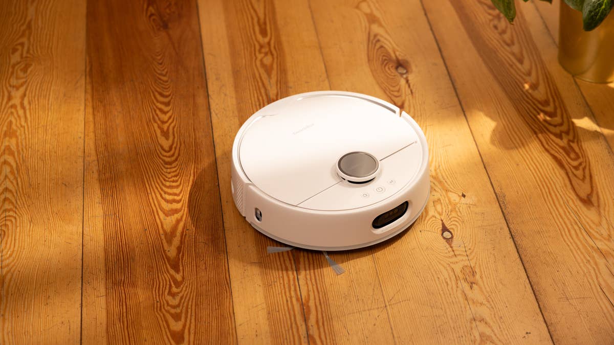

At first sight, memories of the SwitchBot K10+ (review) come to mind. The boasts a similar design, but at 11.5 cm in height, it is a comparatively tall robot vacuum cleaner. If you were to flip the robot vacuum cleaner over, you will initially wonder why there are no mopping pads or a mopping plate. Rather, SwitchBot relies on a roller mop for the S10. Some may be familiar with this from cordless vacuum cleaners (Best Of list). This technical innovation has been gaining momentum in robot vacuum cleaners recently. Even Ecovacs already announced a model with a roller mop for 2025.
A white robot vacuum cleaner on a wooden floor.
The SwitchBot S10 is only available in white.

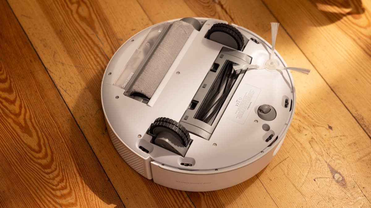

A white robot vacuum cleaner with visible brush attachment on a wooden floor.
A rarity: SwitchBot installs a roller mop here.

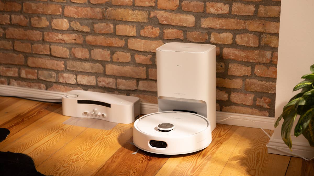

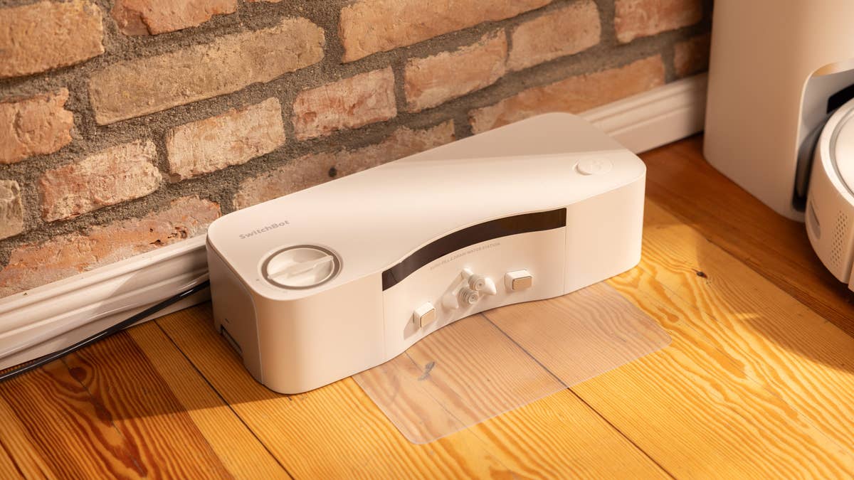

You did not make a mistake. The S10 really does feature two base stations. The first station is only responsible for clean water supply. To do this, you connect the wastewater and freshwater hoses directly to the house plumbing system using the included adapters.
We do not recommend using the accessories that come with the S10 since they are made of plastic and do not seem sturdy enough to withstand the water pressure in the long run. We would definitely have preferred higher-quality accessories to avoid having to purchase longer-lasting parts (made of stainless steel) from the DIY store.

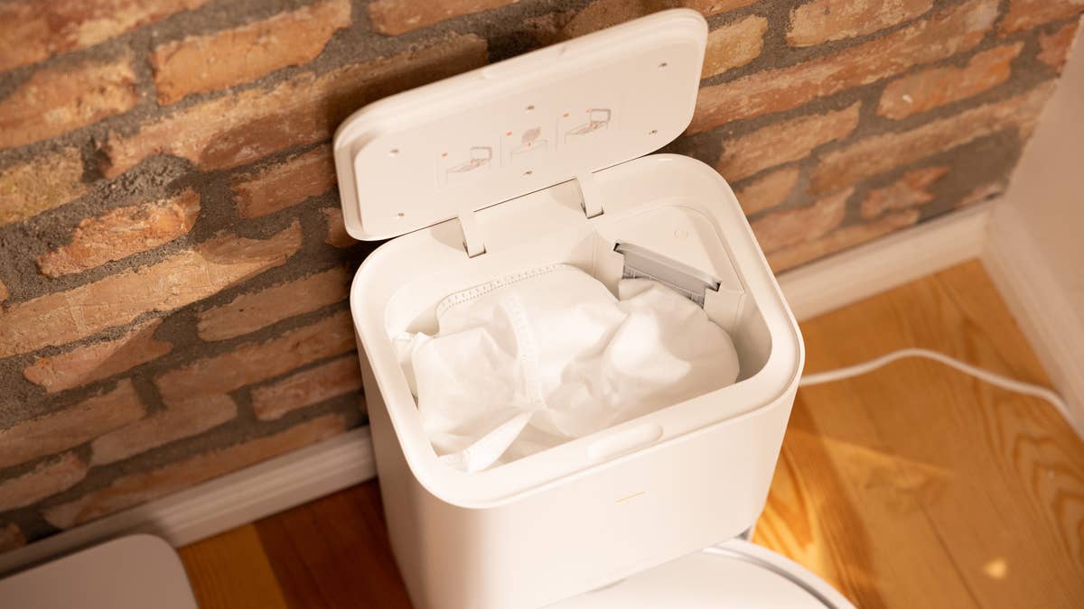

A white smart trash can with an open lid showing a bag and a clean interior in front of a brick wall
There is a dust bag in the self-emptying station.
Quelle: nextpit
A white robot vacuum cleaner and its charging station next to a brick wall.
No joke! The SwitchBot S10 has two base stations. A self-emptying station and a water station.
Quelle: nextpit
A white SwitchBot S10 device on a wooden floor in front of a brick wall.
The water station is connected to a cleaning facility.
Quelle: nextpit
Nevertheless, the trick behind the water station is ingenious. It prevents you from having to manually refill the water, as is the case with robot vacuum cleaners with feature-rich base stations. This water station, measuring 10 cm x 40 cm x 16.5 cm, has a 2.5 L fresh water tank and a 2 L dirty water tank. After all, the water station works on its own without the need for a power supply. We like the fact that SwitchBot provides its own cleaning solution, which is added to the tank with clean water.
The second station has a self-emptying function and takes care of drying the mop roller as well. The 26.0 x 20.7 x 41.2 cm station contains a 4 L dust bag.

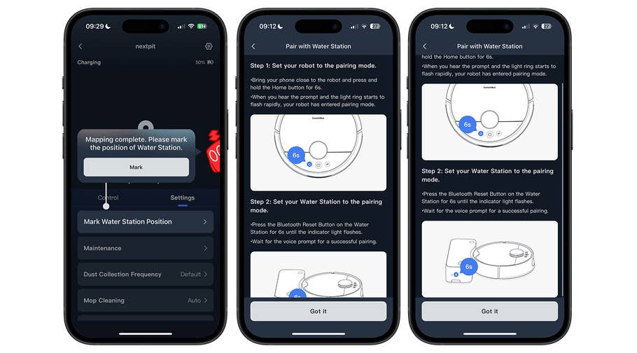

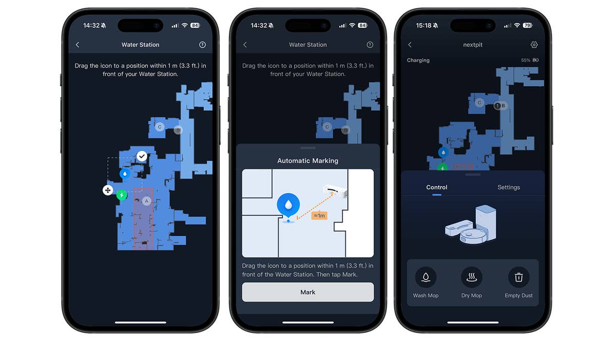

The next step is to add the water station to the map. To do this, mark the location of the water station on the scanned floor plan. The S10 then drives to the specified location and parks, as in the self-emptying station. In our review, pairing only worked on the third attempt. Finally, the robot vacuum cleaner is ready for some cleaning action!
SwitchBot S10 mobile app setup interface showing steps to pair the robot and water station.
The SwitchBot app guides users through the entire setup process.
Quelle: nextpit
SwitchBot S10 app interface shows settings and control options for the water station.
This is how you add the water station.
Quelle: nextpit

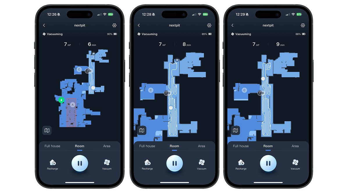

To give the SwitchBot a helping hand even before cleaning, the scanned map can be refined as desired in the SwitchBot app. Among other things, no-go zones, the addition of furniture or the floor type are possible. For cleaning purposes, all suction and wiping levels are included in the main menu. Unfortunately, you cannot make any adjustments for navigation via this menu.
During the cleaning tour, the app shows the live location of the robot vacuum cleaner. It also provides information such as the cleaning duration and how much living space has been cleaned.
Three smartphone screens show the SwitchBot S10 robot vacuum cleaner with maps and status updates.
You will always be kept up to date during the cleaning process.
Quelle: nextpit

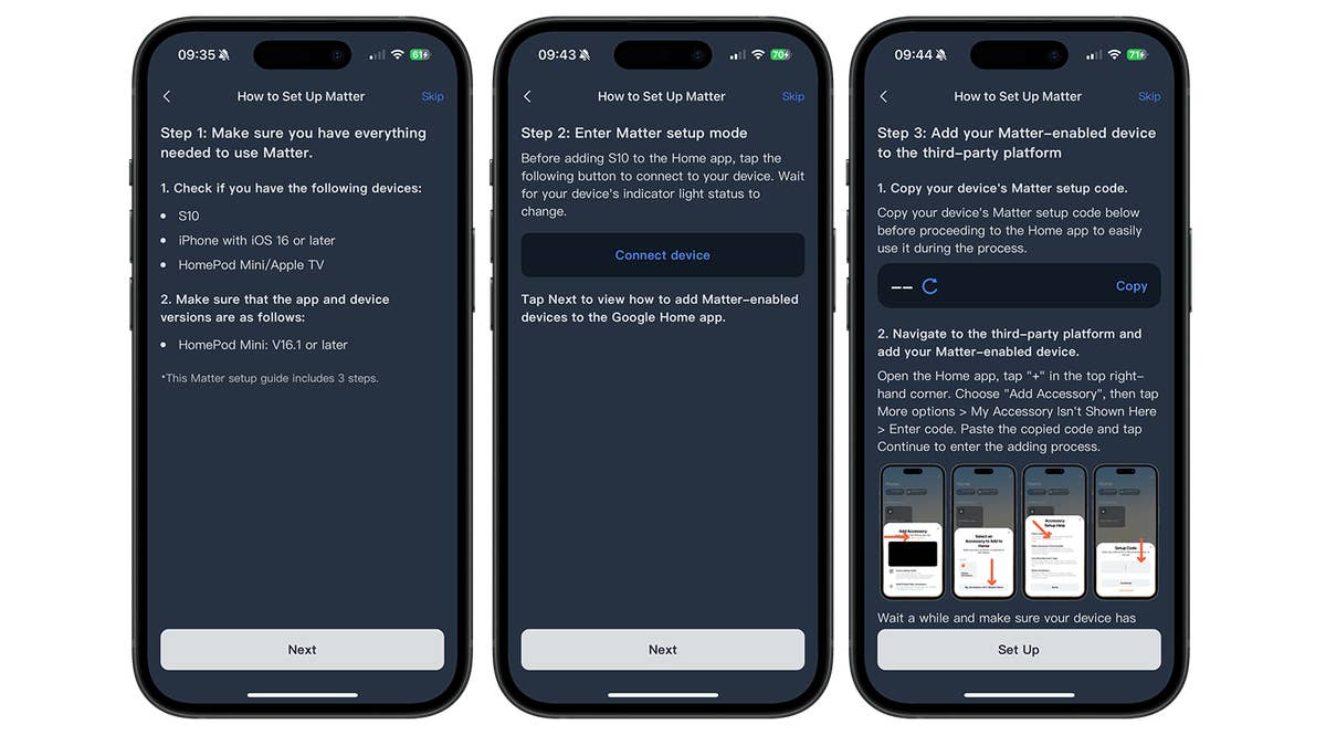

SwitchBot S10 setup guide with steps to connect Matter devices.
The SwitchBot S10 is Matter compatible.
Quelle: nextpit

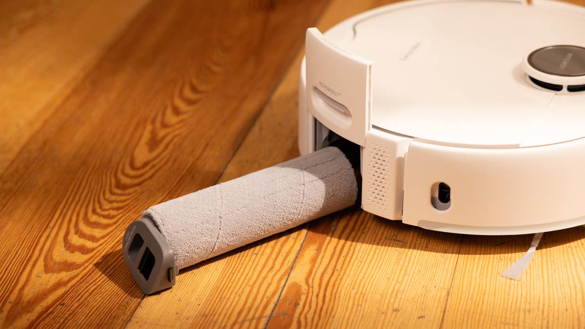

Everything works a little differently with the S10 than what we are used to from previous robot hoovers. As soon as the S10 is sent out to clean, it first travels to the water station to rinse and moisten the roller mop. The roller mop is a special feature of the SwitchBot S10. Robot vacuum cleaners usually have rotating mopping pads while a few models still rely on a mopping plate. Roborock has proven in the S8 MaxV Ultra review that a thorough mopping performance can also be achieved with this.
A SwitchBot S10 robot vacuum cleaner with a removable cleaning brush on a wooden floor.
The mopping roller can be removed. Mopping performance is only average.

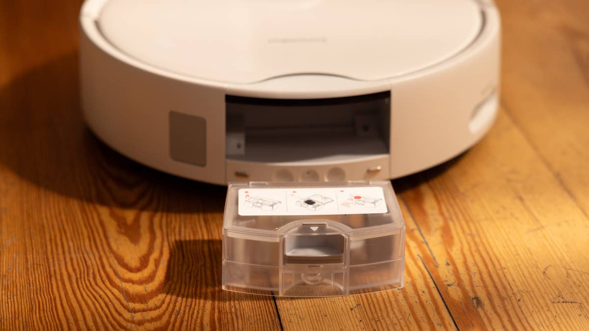

A SwitchBot S10 robot vacuum cleaner with an open dust container and instruction labels.
The dirty water tank collected by the robot vacuum cleaner.

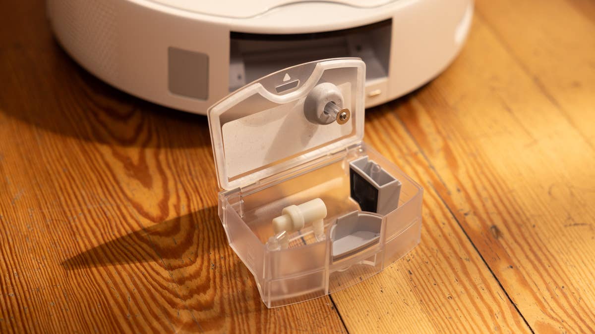

A SwitchBot S10 device with a transparent container showing off its components on a wooden surface.
Dirty water is collected here during cleaning.
Quelle: nextpit
The S10 showed a mixed picture when mopping. Fresh stains are no problem for the cleaning aid. Nevertheless, the self-cleaning roller mop has an advantage over rotating mop pads: the roller mop scrapes off spills when mopping, whereas mopping pads occasionally smear the stains further, causing a bigger mess.
After cleaning, the mopping equipment is rinsed in the water station and dried in the self-emtpying station. There is one disadvantage to this procedure: The mopping equipment is not cleaned with hot water.

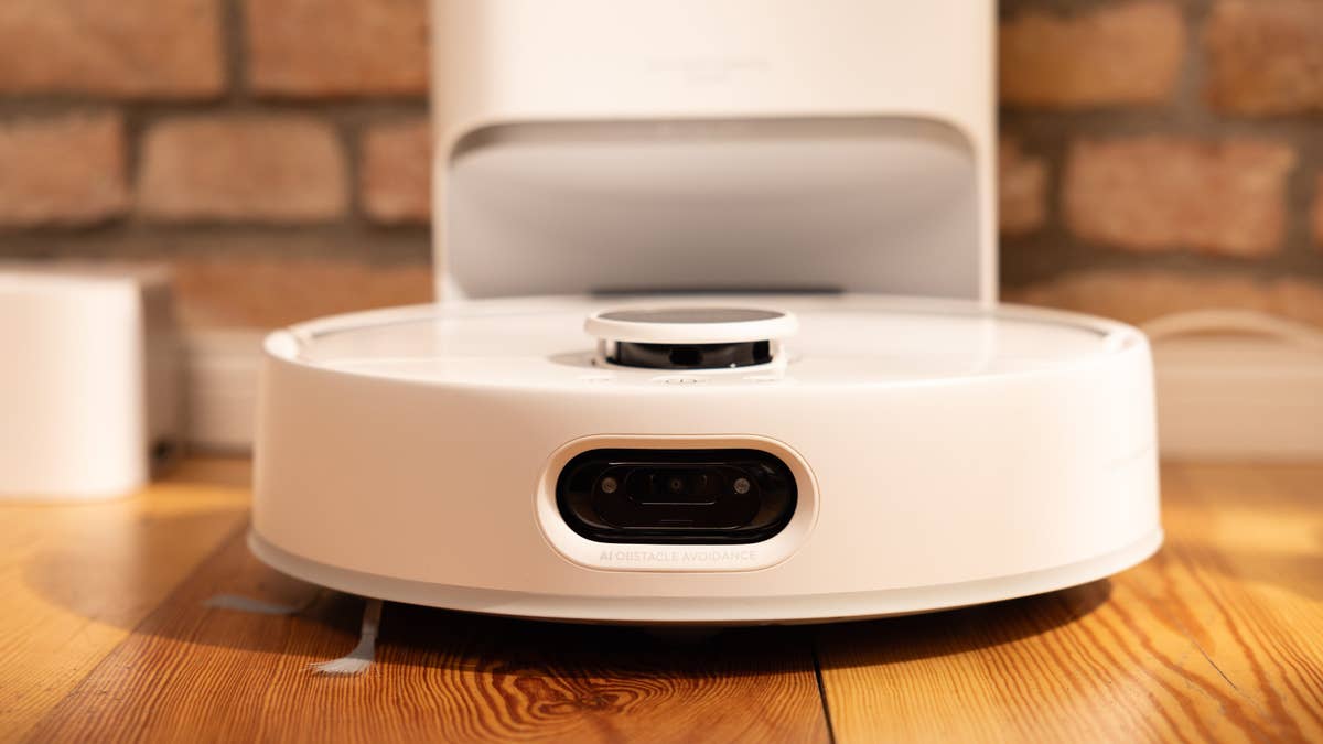

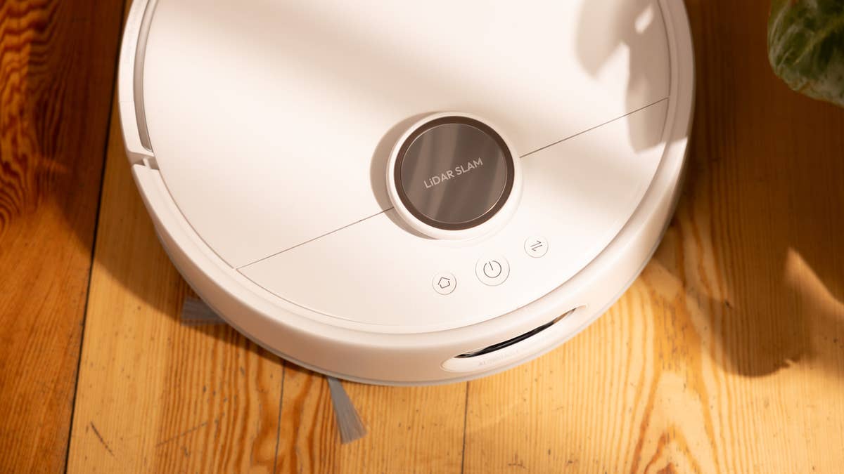

In terms of navigation, the robot vacuum cleaner only scored nothing but plus points. The model is much improved compared to the mapping and recognizes obstacles in good time. The appliance appeared to have been worked from the ground up. The choice of LiDAR navigation also bore fruit in the dark. In poor lighting conditions, the robot vacuum cleaner turned on two headlights to provide better visibility.
A white robot vacuum cleaner with LIDAR sensor on a wooden floor.
The SwitchBot S10 has integrated LiDAR navigation, which is impressive.

A white robot vacuum cleaner with AI obstacle avoidance on a wooden floor.
When working in the dark, the robot vacuum cleaner turns on two headlights.

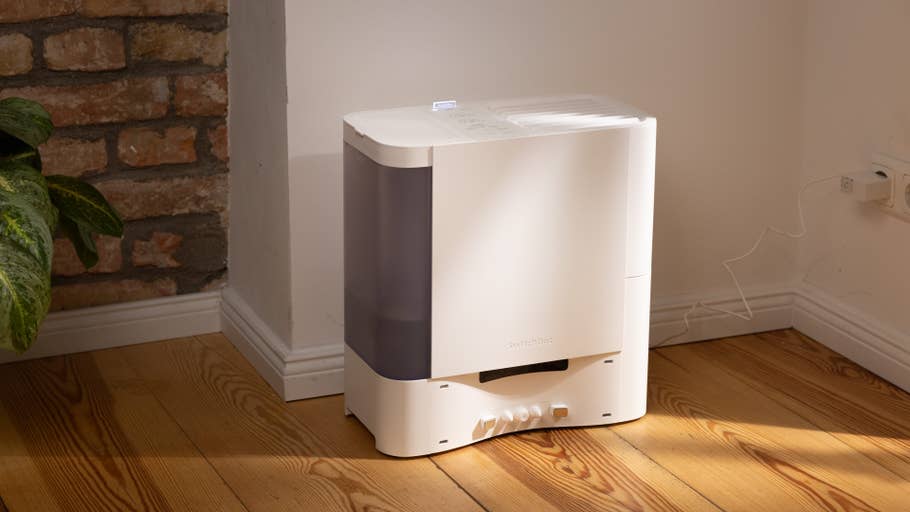

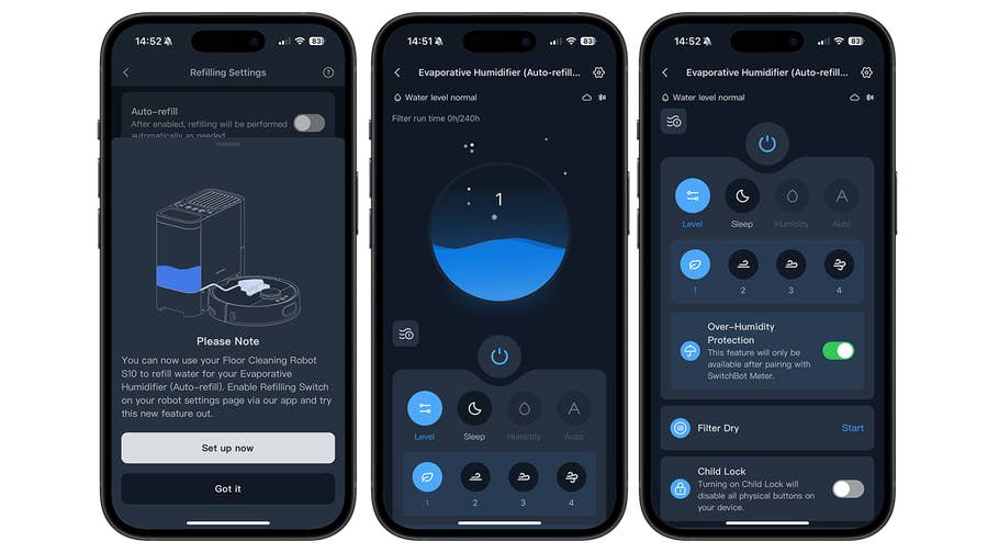

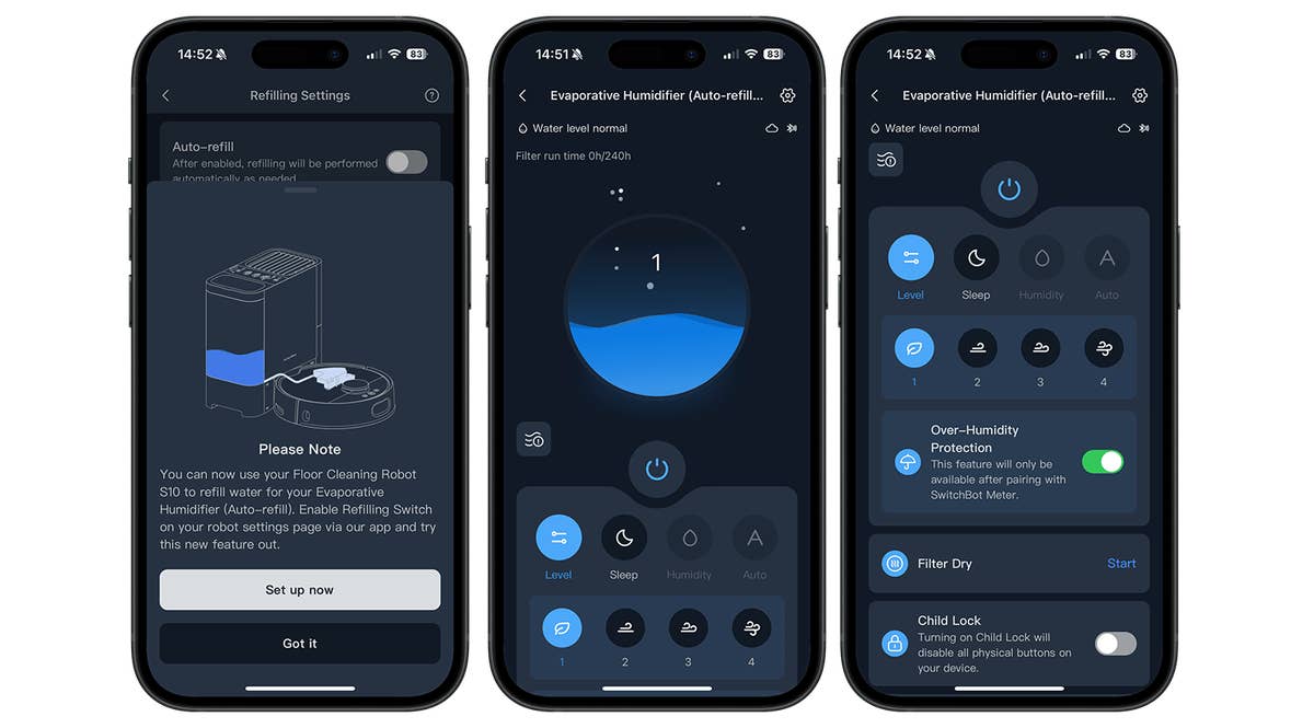

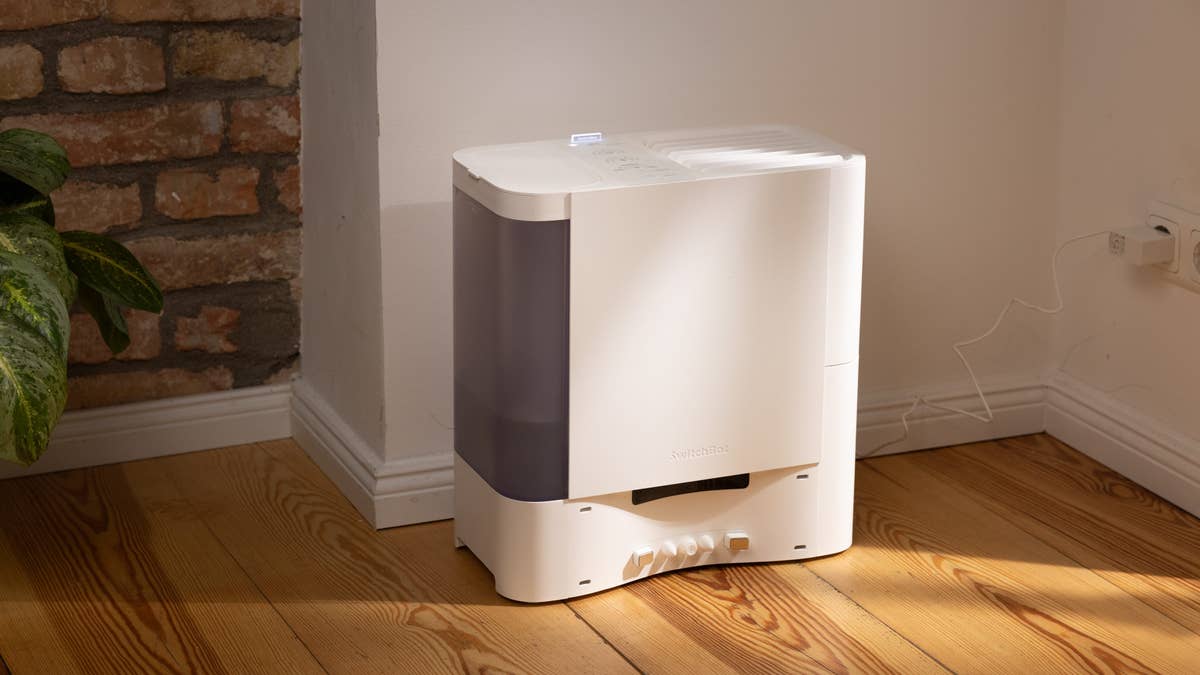

SwitchBot also provided us with the evaporative humidifier for this review. Similar to the fully automated water station, the evaporative humidifier works without any intervention. In the SwitchBot app, you can set the robot vacuum cleaner to supply the evaporative humidifier with water.
Ingenious! All you have to do is add the position of the evaporative humidifier to the map beforehand. The same principle is the same as the water station’s. There are four humidity levels for the evaporative humidifier, which you control via software or the built-in buttons on the device.
A SwitchBot S10 humidifier on a wooden floor next to a plant and a brick wall.
An optional humidifier can be purchased separately, which is supplied with water by the robot vacuum cleaner.

Three smartphone screens displaying the SwitchBot S10 humidifier app settings.
Settings for the SwitchBot humidifier.
