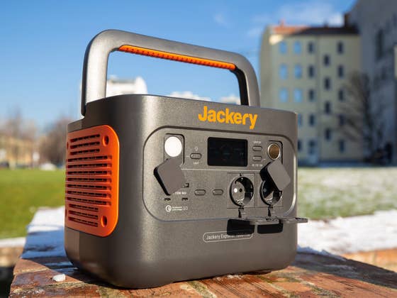

Design and connectivity
Jackery offers the Explorer 1000 Pro as a versatile portable power station that is very convenient to carry around and store thanks to the folding handle. There are rubber covers to protect the ports, while vents on the side support the timeless design. In the Explorer 1000 Pro, Jackery has installed a lithium-ion nickel manganese cobalt oxide battery, or Li-Ion NMC for short.
What I liked:
  • High-quality, timeless design.
  • Excellent portability and convenient stowage thanks to the folding handle.
  • Ports are protected by rubber covers.
What I disliked:
No matter how we look at it, one thing always stands out. Jackery places comfort and high-quality workmanship right at the top of the list. First things first: The accompanying accessories include a power cord, a car charger cable, two DC7909-to-DC-8020 connectors, and the standard user manual. The Jackery Explorer 1000 Pro tips the scales at around 25.4lbs (11.5 kg) and is a compact power station measuring 13.39 x 10.32 x 10.06 in (34 x 26.2 x 25.5 cm).
On the one hand, the Jackery Explorer 1000 Pro can be carried around in a very comfortable manner thanks to the foldable handle. On the other hand, you can also place other objects on the power station if your trunk is lacking any space. Jackery has equipped the Explorer 1000 Pro with rubber feet so that you don’t have to place the power station directly on dirty surfaces.
Jackery Explorer 1000 Pro with its rubber covers.
All ports are protected with a sturdy rubber cover. / © NextPit Image source: NextPit

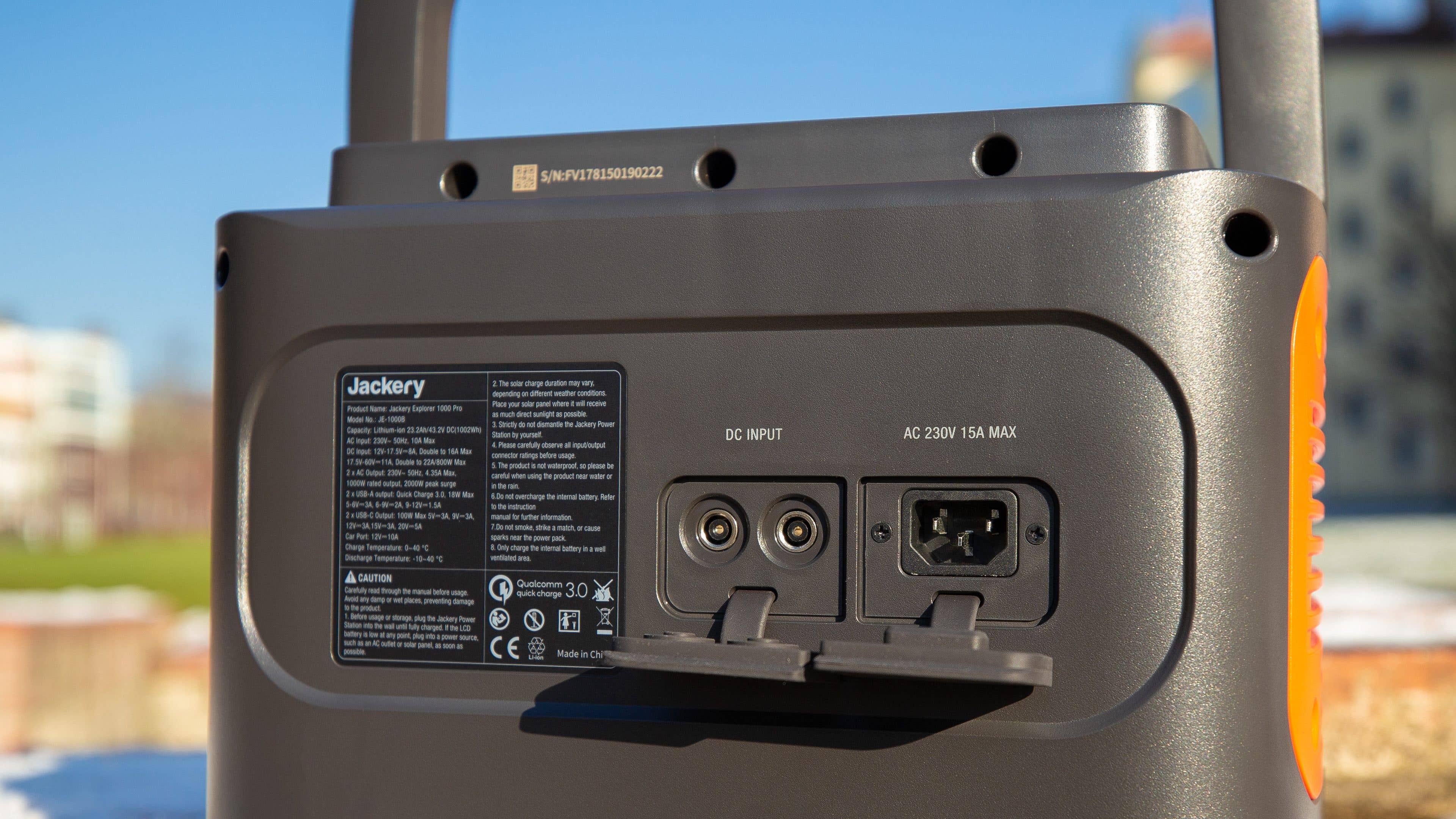

Apart from the USB-A and USB-C ports, all ports are covered with a rubber cover. The two vents are each located on the side, supporting the sleek design of the Jackery Explorer 1000 Pro. Finally, the back of the power station features ports to charge the Explorer 1000 Pro, which also works with solar panels from Jackery’s SolarSaga series.
Jackery Explorer 1000 Pro ports when seen from the back
At the back of the power station are the connections to charge the power station, where it can also be charged using SolarSaga solar panels from Jackery. / © NextPit Image source: NextPit

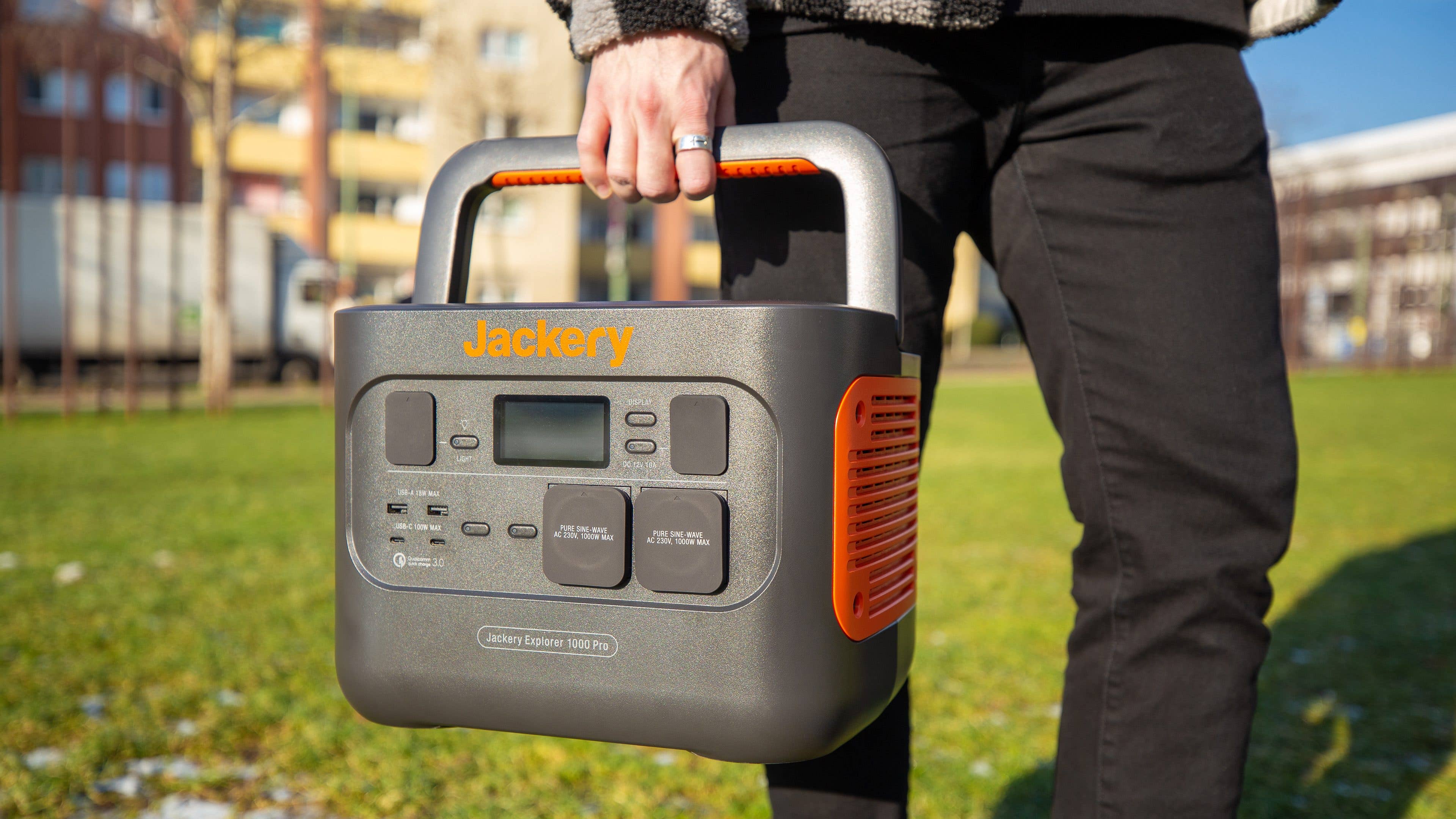

What can we do with it in practical use? Decide for yourself whether it is useful or not: For example, we were able to supply a toaster with 780 watts of power for one hour and eight minutes. During the charging process, the power station was not a great distraction, operating at a volume of 46 decibels. Wireless charging is unfortunately not possible with the power station.
Jackery Explorer 1000 Pro as seen when carried.
The ventilation grille supports the timeless design of the Explorer 1000 Pro. With an operational volume of 46 decibels, the power station works relatively quietly even under a high load. / © NextPit Image source: NextPit
