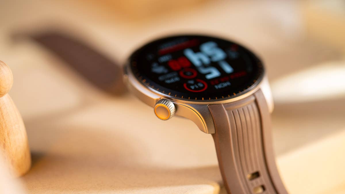

Amazfit Balance smartwatch crown in detail
The Amazfit Balance crown looks like a traditional watch and helps you navigate through software and apps. Itu0027s very responsive.

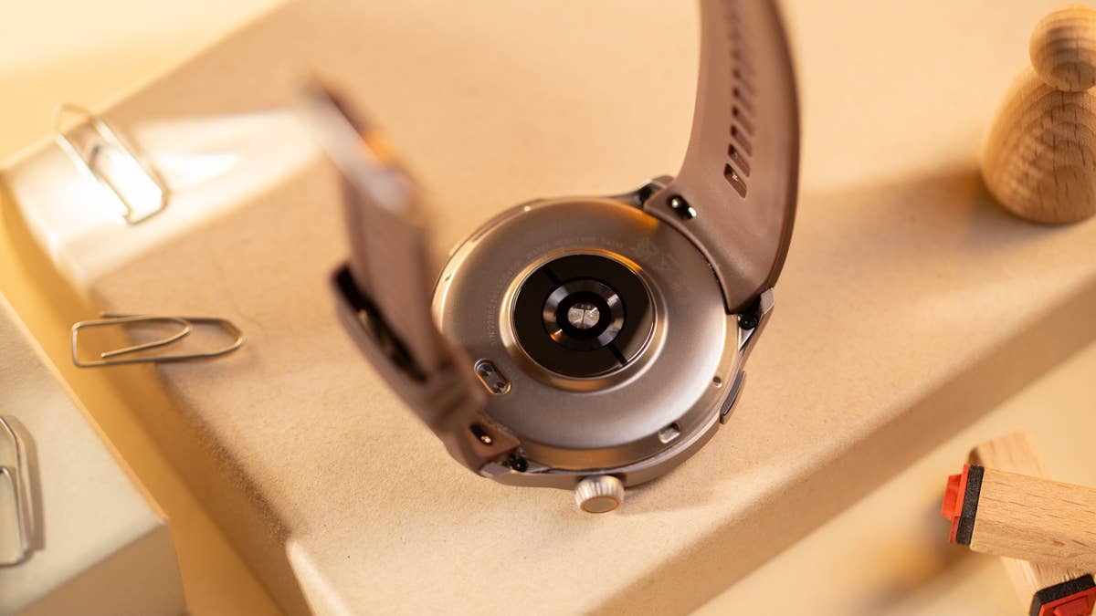

The Amazfit Balance PPG sensor in the back needs to be well strapped to the wrist to maximize accuracy.

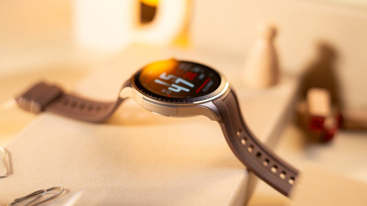

Amazfit Balance smartwatch strap in detail
Although only one size is available, the Amazfit Balance strap is available in a total of 18 fitting sizes.

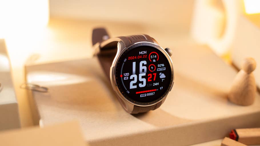

Amazfit Balance smartwatch watch face elements highlighted
The display o f the Amazfit Balance is bright and responsive.
Quelle: nextpit

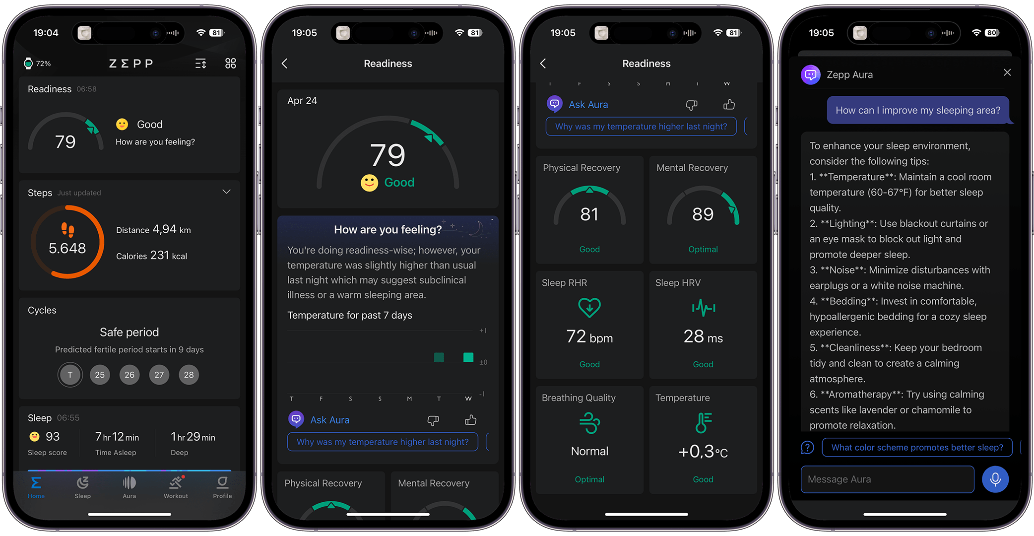

When reviewing the software capabilities of the Amazfit Balance, the integration of several advanced wellness and fitness features stands out. The watch includes a daily readiness score that assesses your physical preparedness each day by analyzing a variety of health metrics.
The goal here is to help you determine how much physical activity you can handle and how long it will take to recover. Honestly, I consider this feature very experimental. Some days, my readiness was good, yet I felt awful, and vice versa. So, it may provide more precise information in the long run—I’m still uncertain about it. Companies like Gamin and Withings also offer something similar to it.

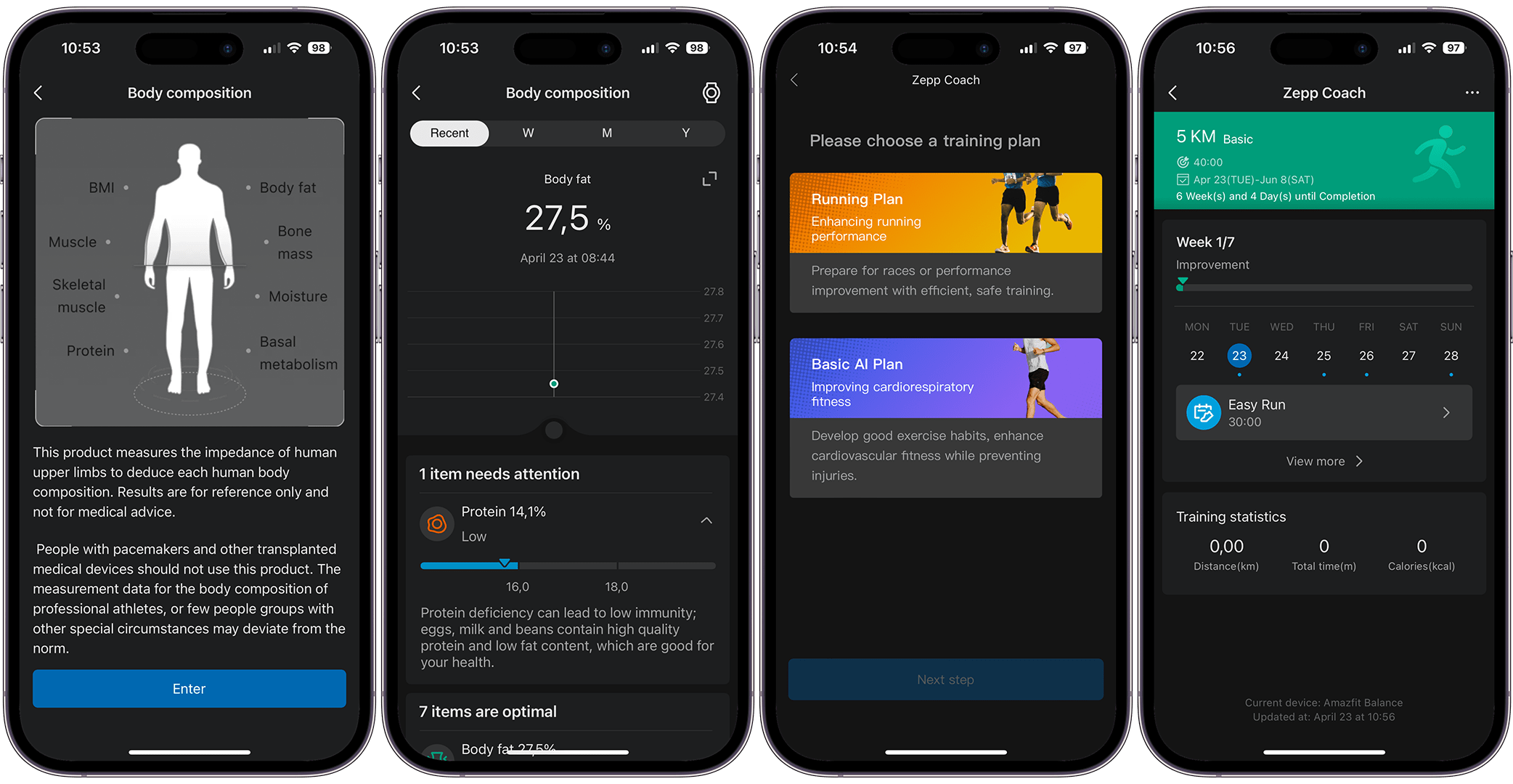

In addition to the readiness score, the Amazfit Balance offers a wrist-based body composition analysis, similar to what Samsung introduced with its Galaxy Watch 4 series. This function measures crucial metrics such as body fat percentage and muscle mass directly from your wrist, enabling continuous monitoring without additional equipment.
I’m also using the Mi Body Composition Scale 2. Although the smartwatch readings are more favorable, they are quite close to the scale’s results. However, it’s difficult to determine which device provides the most accurate analysis.

The Amazfit Balance is enhanced by Zepp’s suite of AI services, each designed to support different aspects of your health and fitness routines. Zepp Aura serves as a personal health coach, providing insights and tools to improve well-being. Zepp Coach offers targeted tips and motivation for your training, while the latest addition, Zepp Flow, features a gen AI-powered voice assistant for natural and intuitive interactions.
AI Assistant widget in the display of the Amazfit Balance smartwatch
The Amazfit Flow AI Assistant is new and still in development.
Quelle: nextpit
However, I haven’t had sufficient time to use all these features together extensively, so I can’t offer a definitive opinion on their combined effectiveness. The platform is still evolving, with each update expected to bring improvements. Additionally, it needs to collect more data on my fitness activities and health metrics to provide a consistent experience. This may explain why Zepp has not yet started charging for the Flow service.
What I can say, however, is that I don’t see it as a game-changer in wellness and fitness in its current stage of development. Perhaps you would benefit more from the Whoop’s approach to AI.

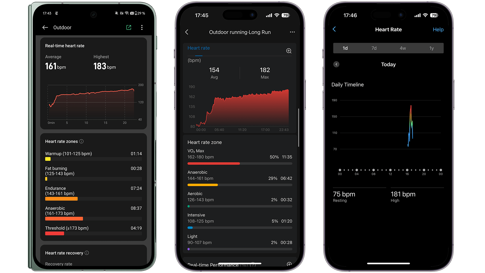

The Amazfit Balance’s dual-band GPS closely matched the performance of the OnePlus Watch 2. During a brief outdoor running test on a track while recovering from illness, both devices accurately tracked my movements.
Both the Amazfit Balance and the OnePlus Watch 2 showed comparable metrics and heart rate zone data during real-time heart rate monitoring. Benchmarking against the Garmin HRM-FIT chest strap produced consistent results across the board.
Despite the Garmin strap recording an average heart rate of 128 bpm, the Amazfit Balance logged 154 bpm, and the OnePlus Watch 2 registered 161 bpm. With the Amazfit Balance worn on my left arm and the OnePlus Watch 2 on my right, these results seem highly credible.
Screenshots of heart rate monitoring features from different fitness tracking apps, showing graphs and statistics for heart rate zones and recovery rates during the same outdoor running session.
From left to right: OnePlus Watch 2 heart rate metrics from the same outdoor running session on the Amazfit Balance and Garmin HRM-FIT chess strap. / © nextpit Image source: nextpit
That said, I consider the Amazfit Balance a versatile choice for runners of all levels, offering a comprehensive feature set that includes tracking distance, time, average and best pace, calories burned, and steps. It also provides cadence and average stride measurement to improve running efficiency.
Its continuous heart rate monitoring offers valuable insights into average and peak levels, along with a detailed analysis of heart rate zones for monitoring workout intensity. Additionally, it provides extra metrics such as Aerobic and Anaerobic Training Effect, VO2Max, and both average and maximum power.

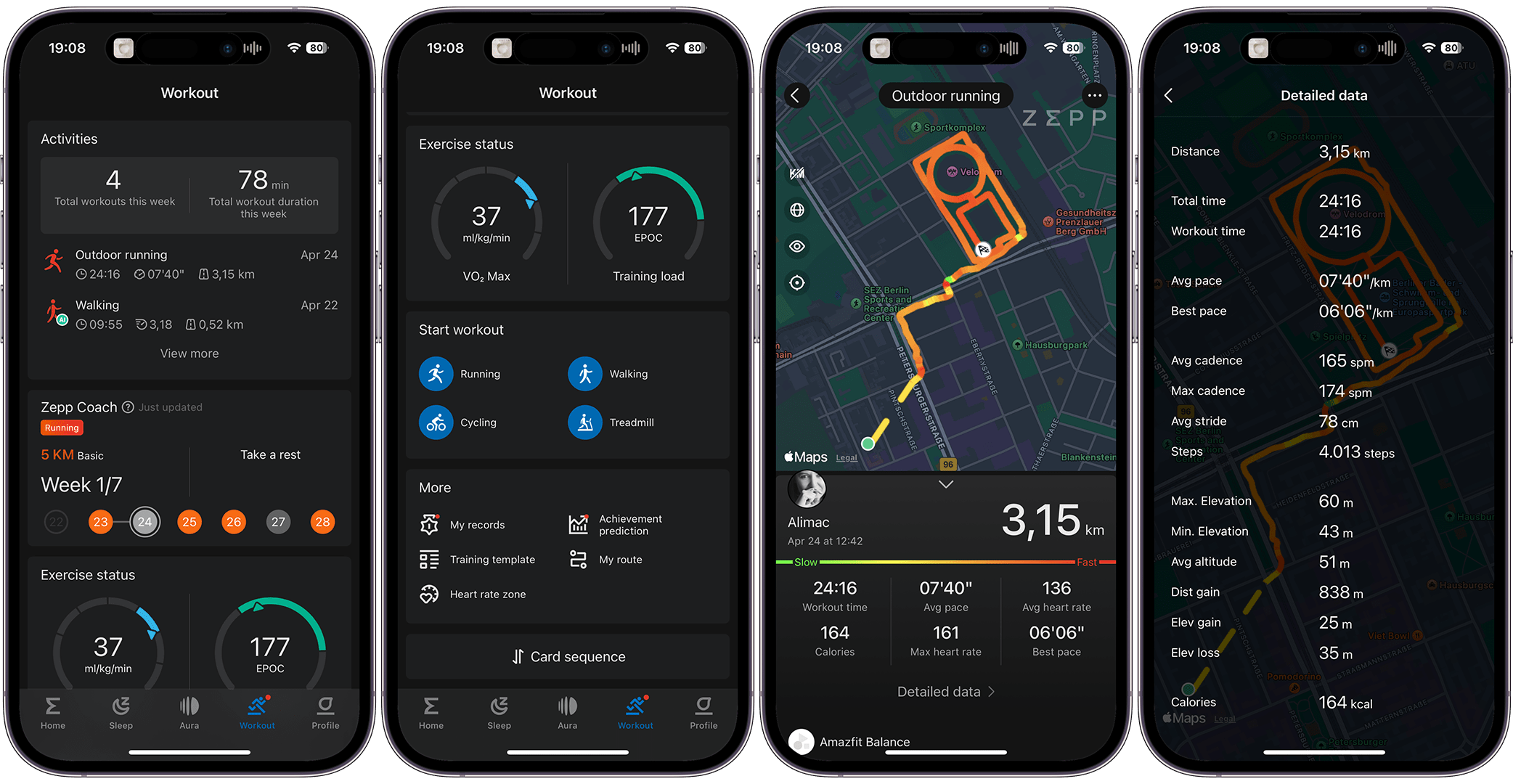

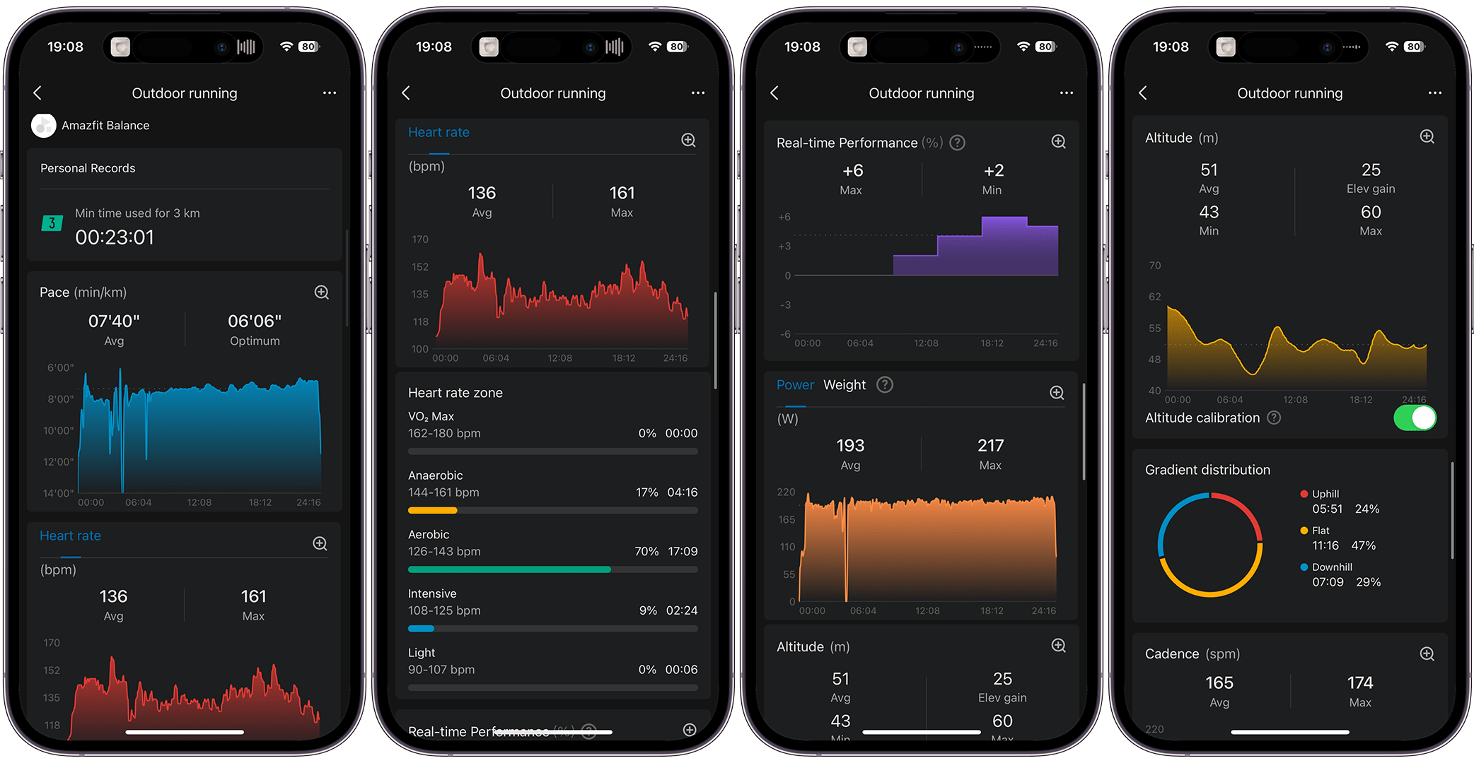

Screenshot of the Zepp Health app
Zepp Health app summarizing the user’s workout activities, along with a map showing the completed running route and key stats. / © nextpit Image source: nextpit
Since I’m training for a marathon at the end of Q3, I find this information really enlightening and helpful for improving my training. However, I do consider that these are only estimates of the run workout and are not exactly precise. But I do appreciate seeing all this data collected and analyzed together after my workout.
More in-depth running performance analysis provided by the Zepp Health app, showing heart rate zones, power, and elevation stats. / © nextpit Image source: nextpit

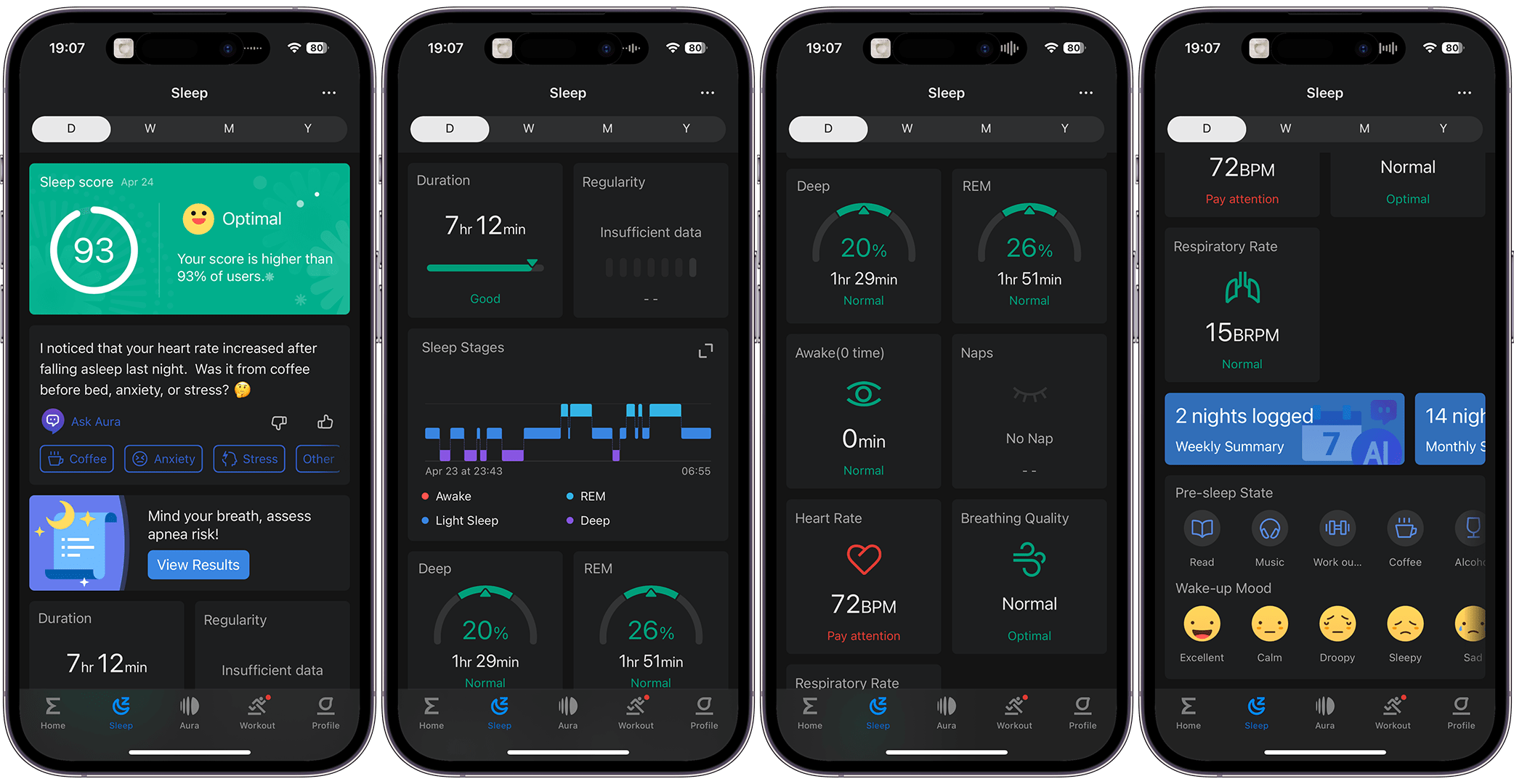

I believe that sleep quality is the most relevant metric for those who want to live longer lives while enjoying good health. However, I don’t usually advise using large smartwatches like the Amazfit Balance for sleep tracking. The main reason is that depending on the size of the wrist, it can negatively impact your sleep. Nevertheless, Zepp offers a compelling sleep-tracking analysis.
If you frequently read my wearable reviews, you might know that I use the Apple Watch Series 9 (review) as a reference device because of its accuracy compared to accurate sleep headband devices. To my surprise, the Amazfit Balance performed well when compared to it. Although it can be more generous with sleep phases like deep and REM sleep, it doesn’t add too much extra time to each stage.
Detailed sleep quality assessment in the Zepp Health app, featuring a sleep score and a breakdown of sleep stages and heart rate data. / © nextpit Image source: nextpit

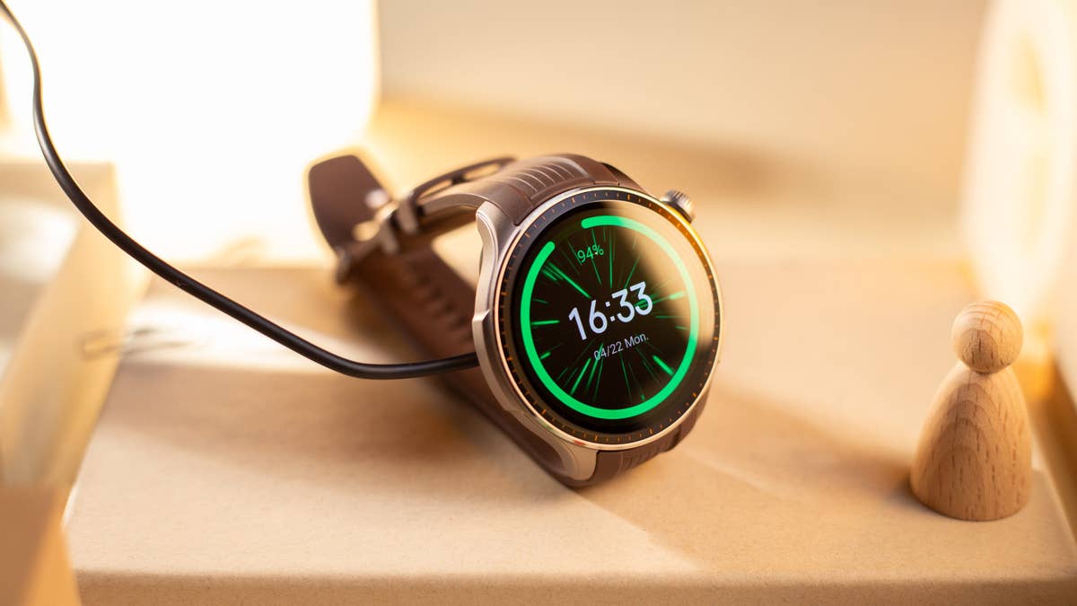

Amazfit Balance fast charging animation in detail
The Amazfit Balance takes a bit longer than 1h to fully charge the device, and it lasts up to a week of usage.
