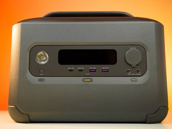

When I opened the box, the first thought that came to my mind was, “Huh, what’s a jukebox doing here?” The Ugreen PowerRoam 1200 is a robustly constructed power station. Items included in the delivery were kept simple. First, there is a charging cable for you to charge it from a wall socket, a charging cable for your car, and yet another cable for solar charging as well as a user manual.
Additionally, there is a small bag used to store the cables. The PowerRoam 1200 tips the scales at 12 kg and is a compact energy box, measuring 34 × 22 × 27 cm. The weight was surprisingly low compared to the Bluetti AC180, where Bluetti’s power station weighed a hefty 17 kg. This is a pleasant surprise for the PowerRoam 1200 considering the power supply is integrated within the power station.

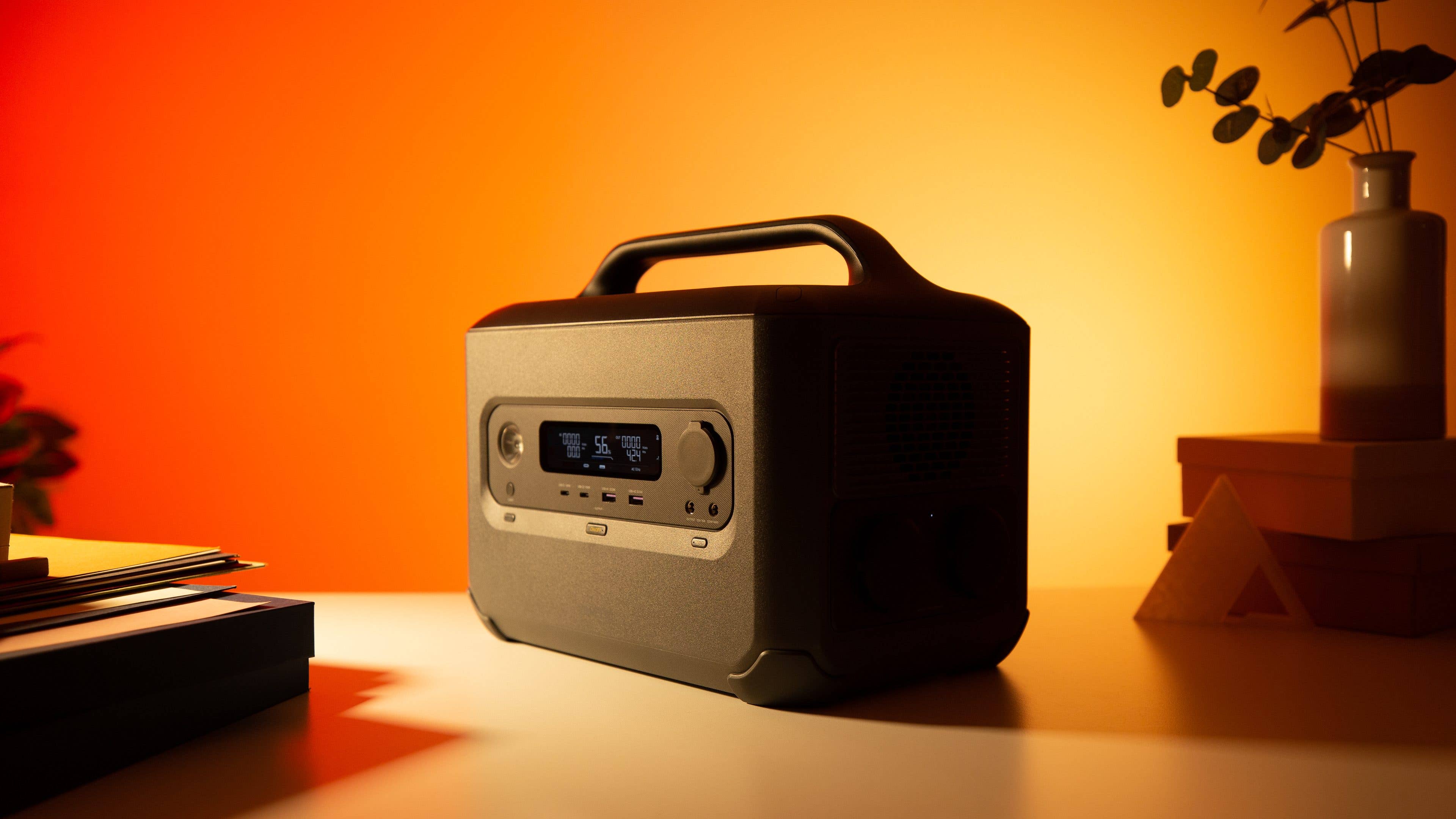

Ugreen installed a carrying handle on top of the PowerRoam 1200, which allows you to transport the power station in a comfortable manner. However, stowing it in the car could be a slightly awkward experience since the carrying handle cannot be folded. Ugreen attached four small rubber feet to the PowerRoam 1200, so you don’t have to worry about the power station slipping off your boat when you’re sailing on choppy waters.

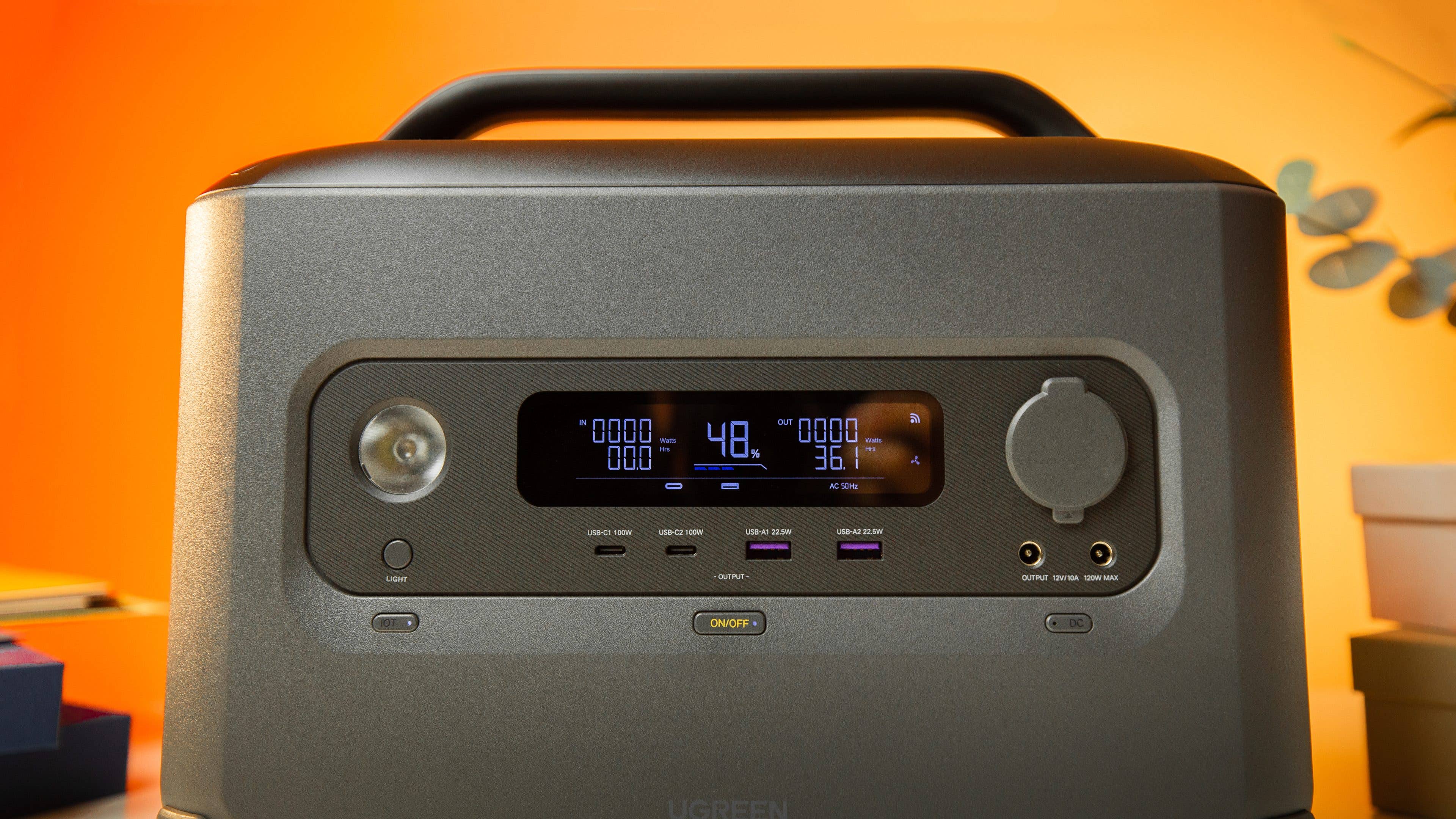

In front is a 4.7-inch display, and right below are two USB-C ports with a maximum power of 100 W each and a pair of USB-A ports with 22.5 W power at its peak. Finally, you have two DC5521 ports with a maximum power of 120 W. Centered in front, Ugreen placed three buttons: one to activate DC power, another to turn the power station on and off, and finally, a button that allows you to pair it to your smartphone.

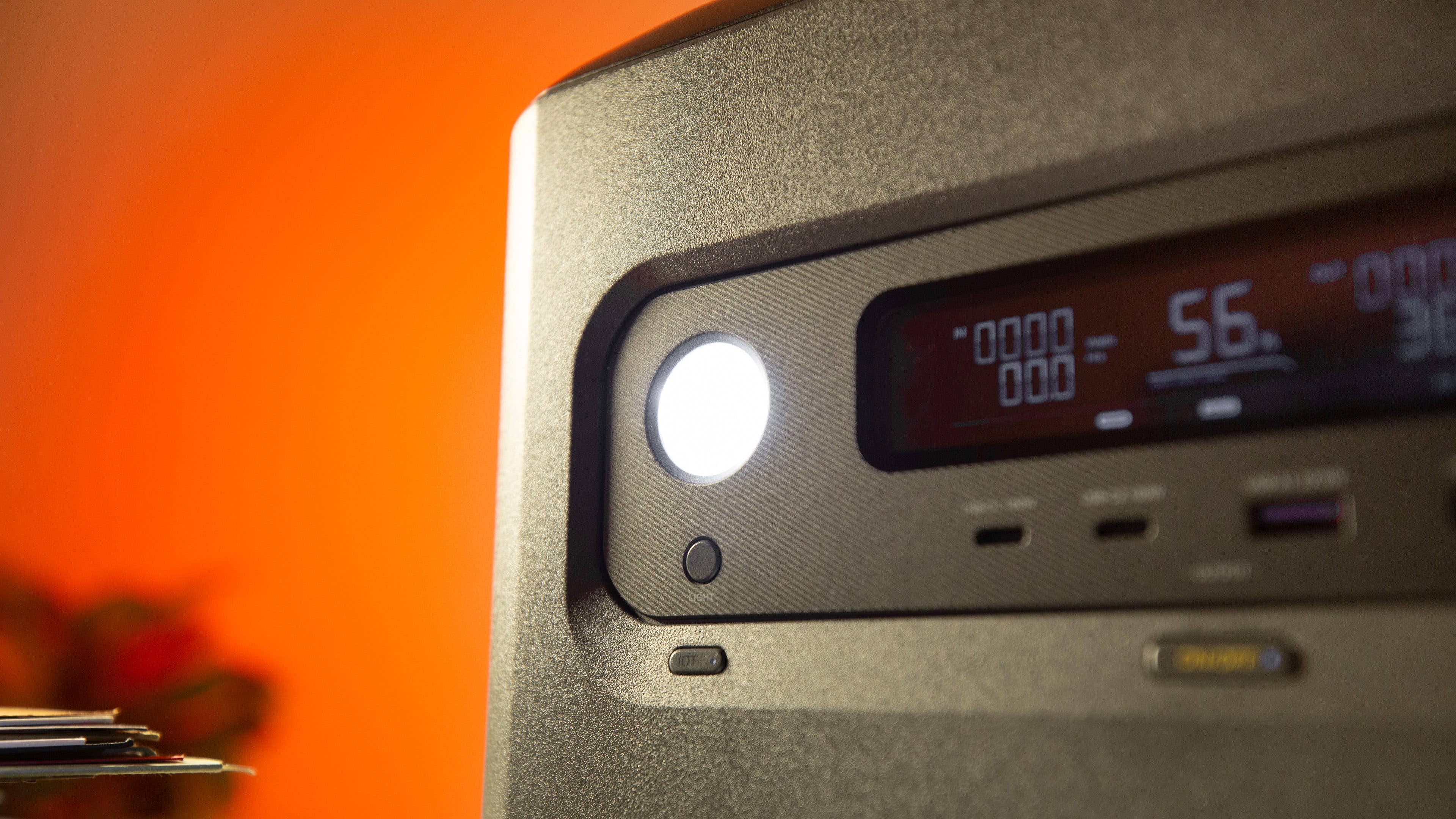

Last but not least, the PowerRoam 1200 has a light in front where you can choose from standard lighting to a flashing light and an SOS light. It is extremely convenient since you can control the light via the Ugreen app.

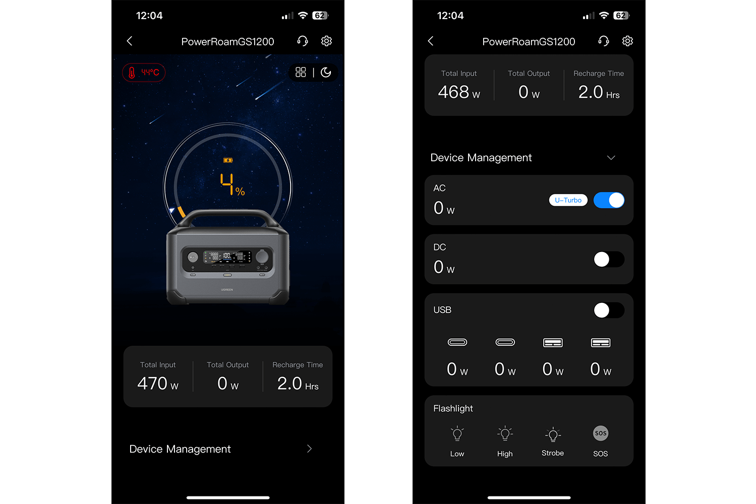

You can tell that Ugreen has put significant effort into the app. You can log in with your email address or with your Apple or Facebook account. Once you have done so, you set up either a Bluetooth or WLAN connection, and you’re ready to go. The Ugreen app is both clear and extremely detailed.
The main menu clearly shows the battery status with a nice animation in the background, the input and output power, and how long the charging process takes. If you were to scroll down a bit, you will also have information about the AC and DC power supply, including turning it on or off.
You can do the same for all USB ports. What caused unexpected enthusiasm in our review is the possibility to control the different lamp functions. Admittedly, this is nothing earth-shattering, but nevertheless, it is a feature in the Ugreen app that caused amazement among the editorial team.
The clearly arranged main menu in the Ugreen app shows you a lot of information about the Ugreen PowerRoam 1200 at a glance. / © NextPit Image source: NextPit

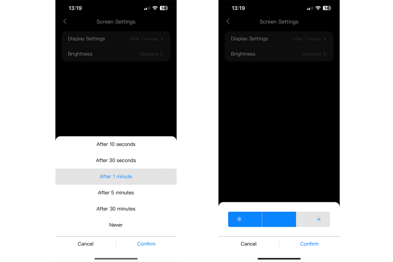

You can adjust the display via the settings as well. Here, you can set the display brightness and even set the time required before the display goes to sleep. The range is from eleven seconds to a whopping 30 minutes. You can also activate the battery-saving mode, deactivate sound when you press a button, and activate the parental lock in the Ugreen app.

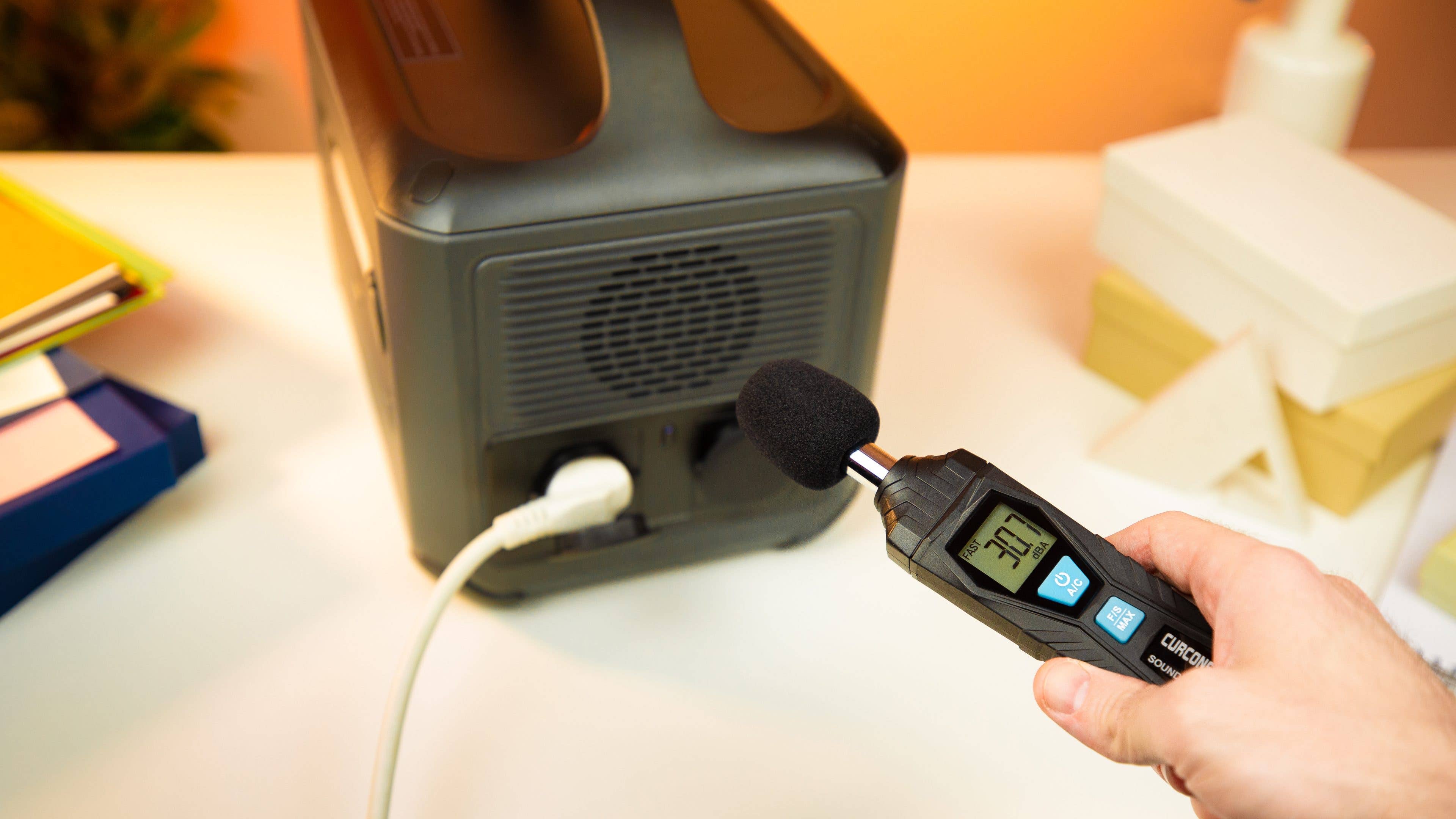

The Ugreen PowerRoam 1200 is the quietest power station we have reviewed so far. / © NextPit Image source: NextPit
During charging, the power station was so unobtrusive that we had to check on it several times to see if it was even operational. At a maximum noise level of 41 dB, the PowerRoam 1200 is softer than, for example, the EcoFLow River 2 Pro (review).
