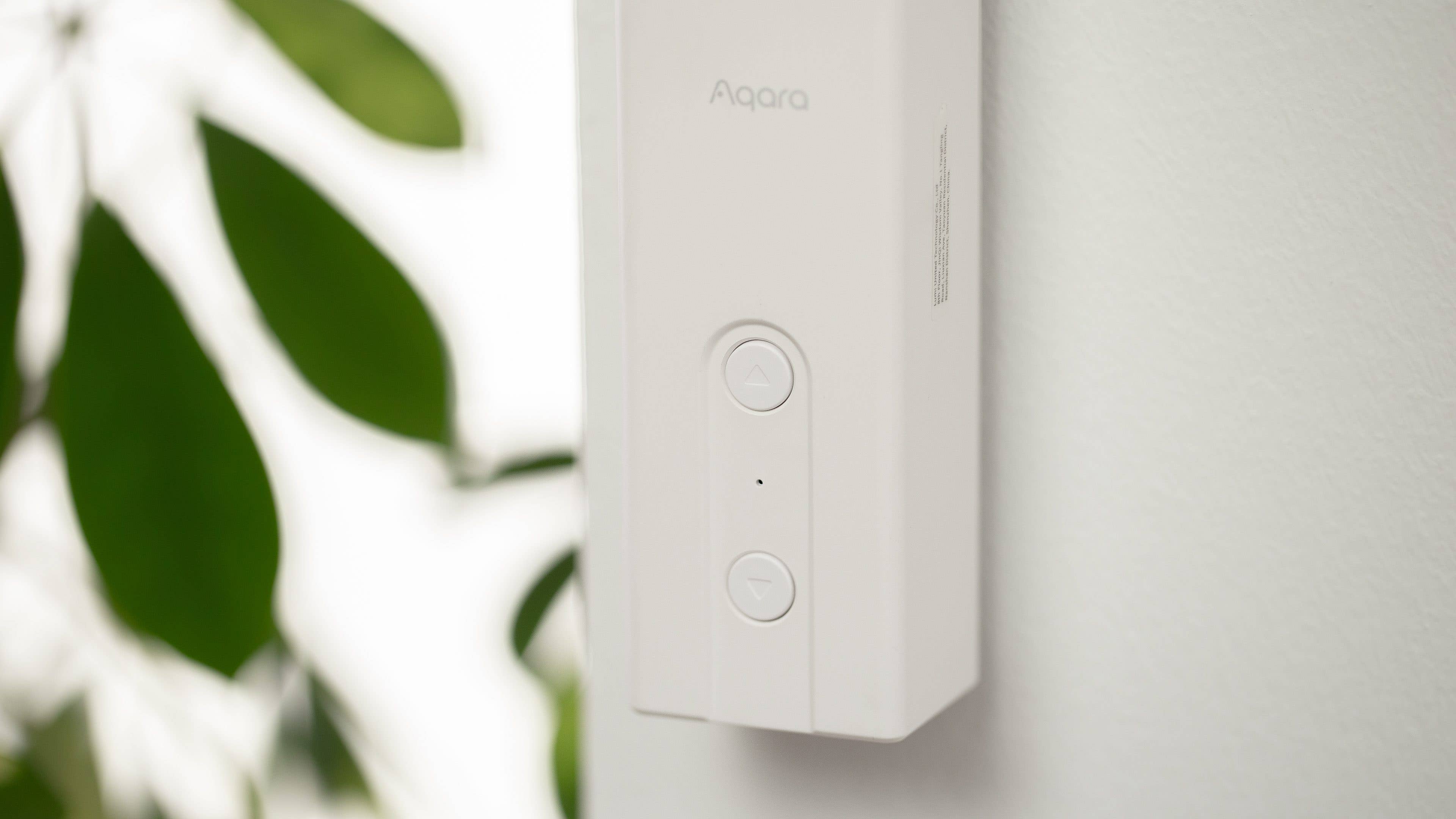

You can control the Roller Share Driver either via the two buttons or via the app. / © NextPit Image source: NextPit

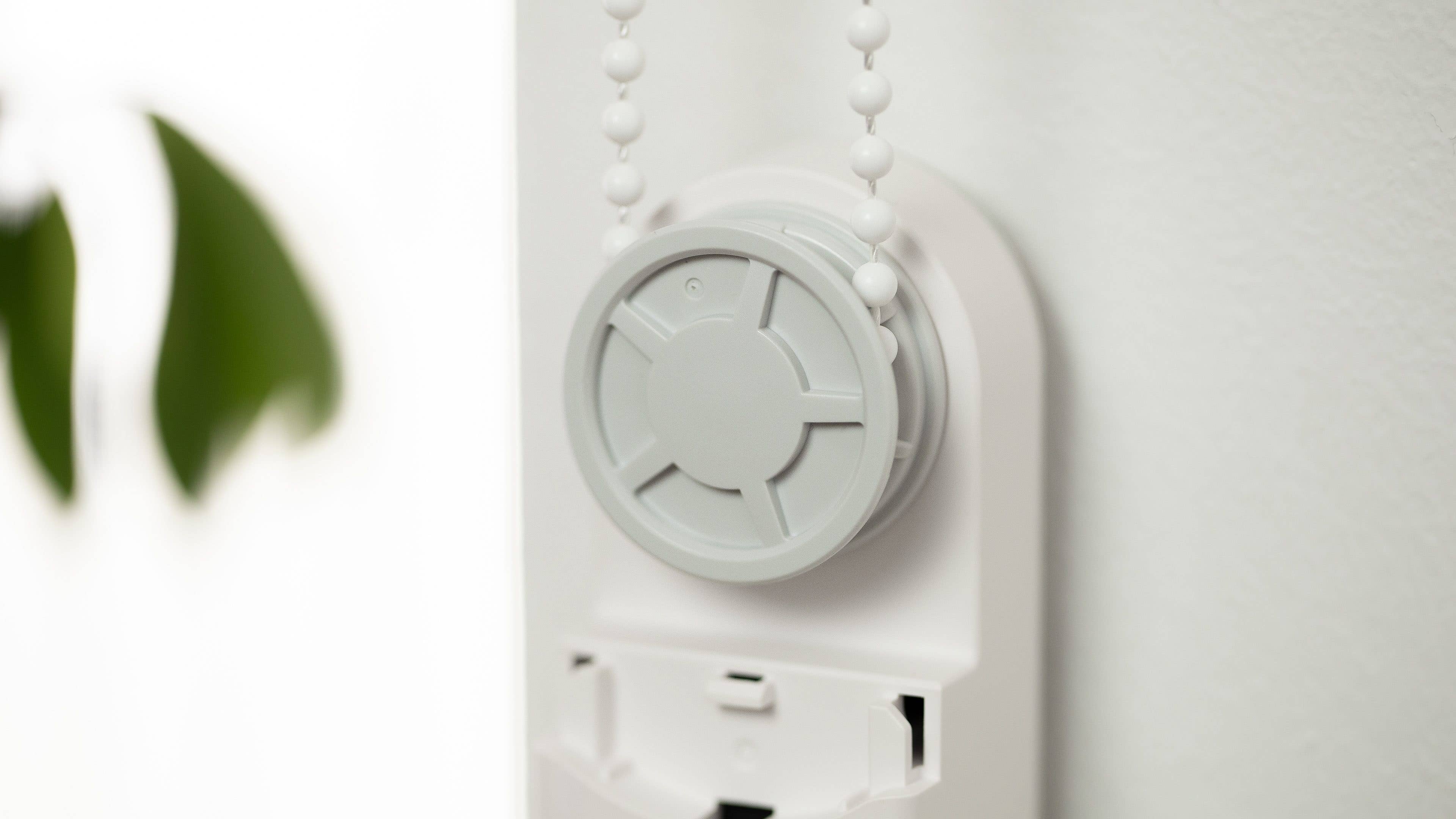

To install the Roller Shade Driver E1, you will first have to remove the plastic cap at the top end. Underneath is the shaft of the electric motor, on which there is already a receptacle for the common roller blind bead chains. If your roller blind uses a different type of chain, you will find three more adapters in the box.
Aqara Roller Shade Driver E1
Hang the Roller Shade Driver E1 at the lowest point and mark the position on the wall, from where you can then attach the wall bracket. Alternative chain adapters are included. / © NextPit Image source: NextPit

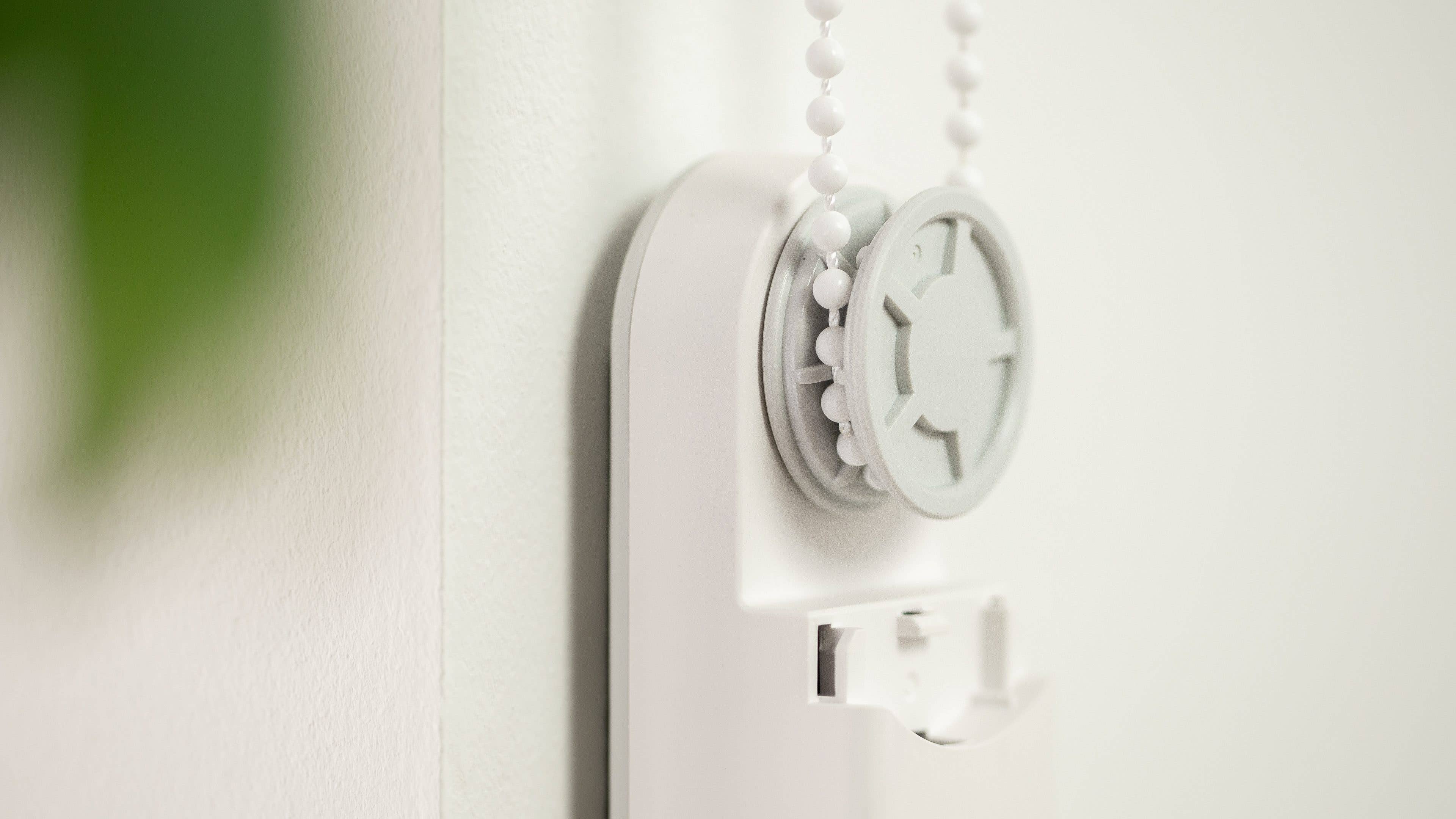

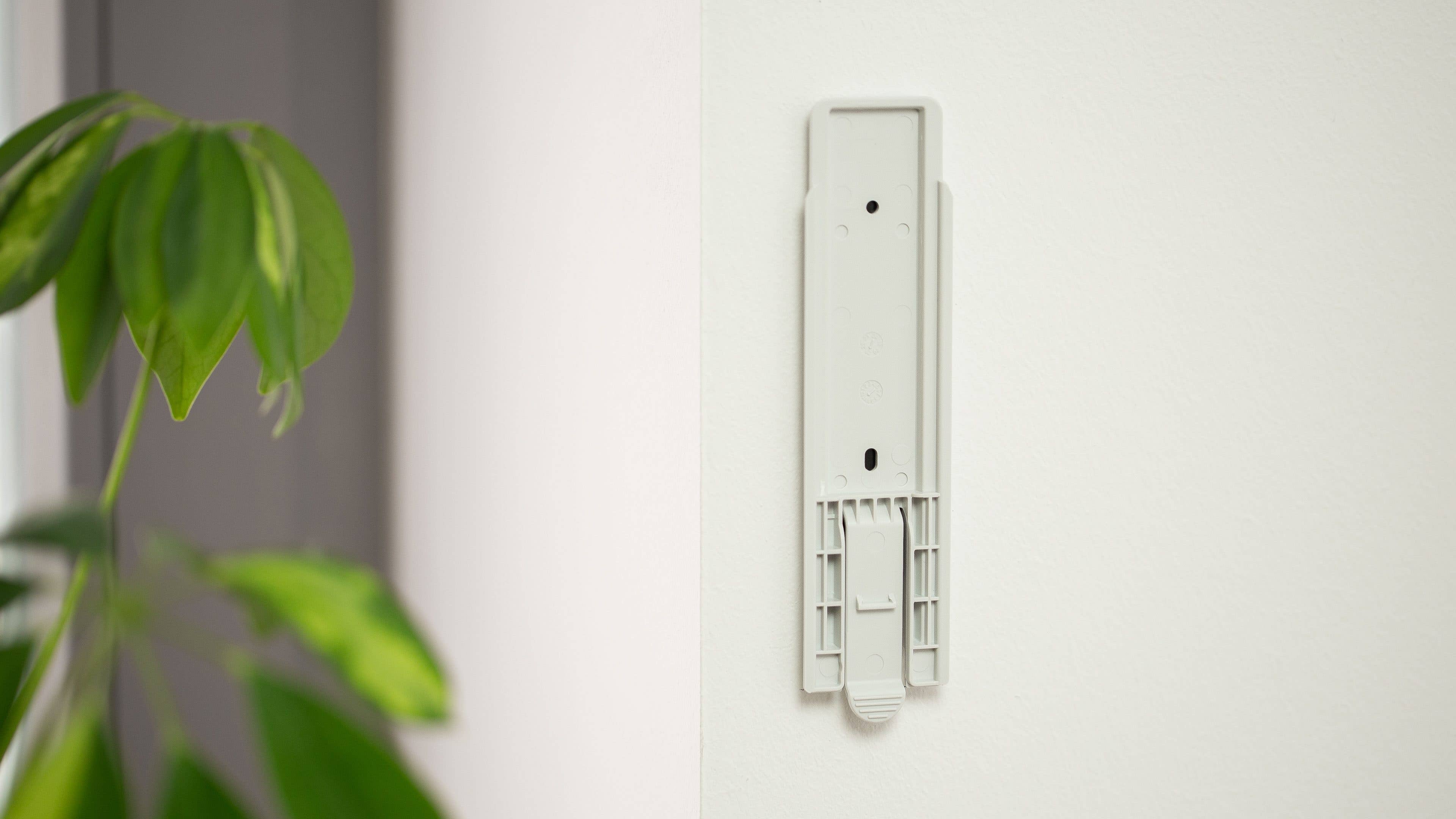

Now all you have to do is hook the Roller Shade Driver E1 into the chain of your roller blind at the lowest possible point, holding it against the wall and marking the bottom end of the housing with a horizontal line. Follow that by separating the wall bracket from the housing and attaching it with the lower end at the marked height. This can be done either using the included adhesive pad or with two dowels and screws that are also included.
Following that, simply slide the roller shutter motor back onto the wall bracket and the installation is complete. With the two up and down buttons on the housing, you can now already remotely move the shutter up and down. However, do be careful: The motor still does not know the end points can can run in both directions infinitely.

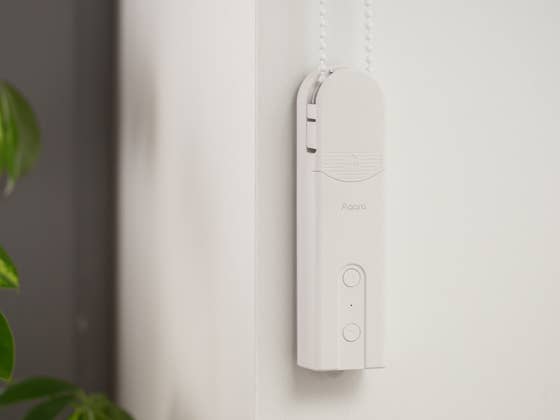

We attached the wall mount for the Aqara Roller Shade Driver E1 to the wall with the included adhesive pad. It has remained firmly in place since. / © NextPit Image source: NextPit
By the way, it was no problem in the test that the axis of our roller blind and the axis of the motor are offset by 90 degrees. Just make sure that the chain is not too tight during installation – the chain should only have a slight tension, not be taut like a guitar string.

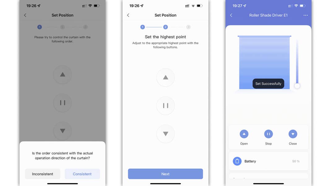

To set up the Roller Shade Driver E1, all you have to do is scan the QR code at the back in the app and follow the instructions on the smartphone display to set the end points of the motor for the top and bottom positions. It took less than two minutes to set up the roller shutter motor in the review.
Aqara Roller Shade Driver E1 Screenshots
Determine the direction of movement, set the highest and lowest positions – and the setup is complete. / © NextPit Image source: NextPit

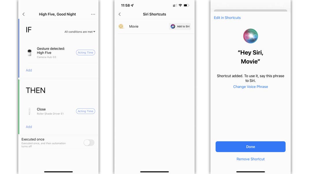

You can also link other sensors to the Roller Shade Driver E1. Since the G3 Camera Hub offers gesture recognition, you can close the roller blind with a high-five gesture. This actually worked flawlessly in the review. Apart from that, you will find a lot of buttons and rocker switches, motion sensors, vibration sensors, door and window sensors and more in the Aqara portfolio. Just have a gander and see whether anything suits your fancy.
You can also set up selected scenes with several components, such as for “Movie”. Here, the room will be automatically darkened and perhaps even have the lights in the room dimmed. These scenes can then also be controlled via a voice assistant like Siri. Speaking of which, the Roller Shade Driver E1 also supports the Apple Homekit and can thus be integrated into your Apple ecosystem. Furthermore, there is support for IFTTT as well as Alexa Skill and Google Assistant.
If you have an Aqara camera with gesture control support, you can close the roller blind via a High Five gesture (left). The Roller Shade Driver E1 also supports Siri, Alexa, and Google Assistant as well as IFTTT. / © NextPit Image source: NextPit
