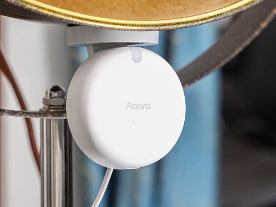

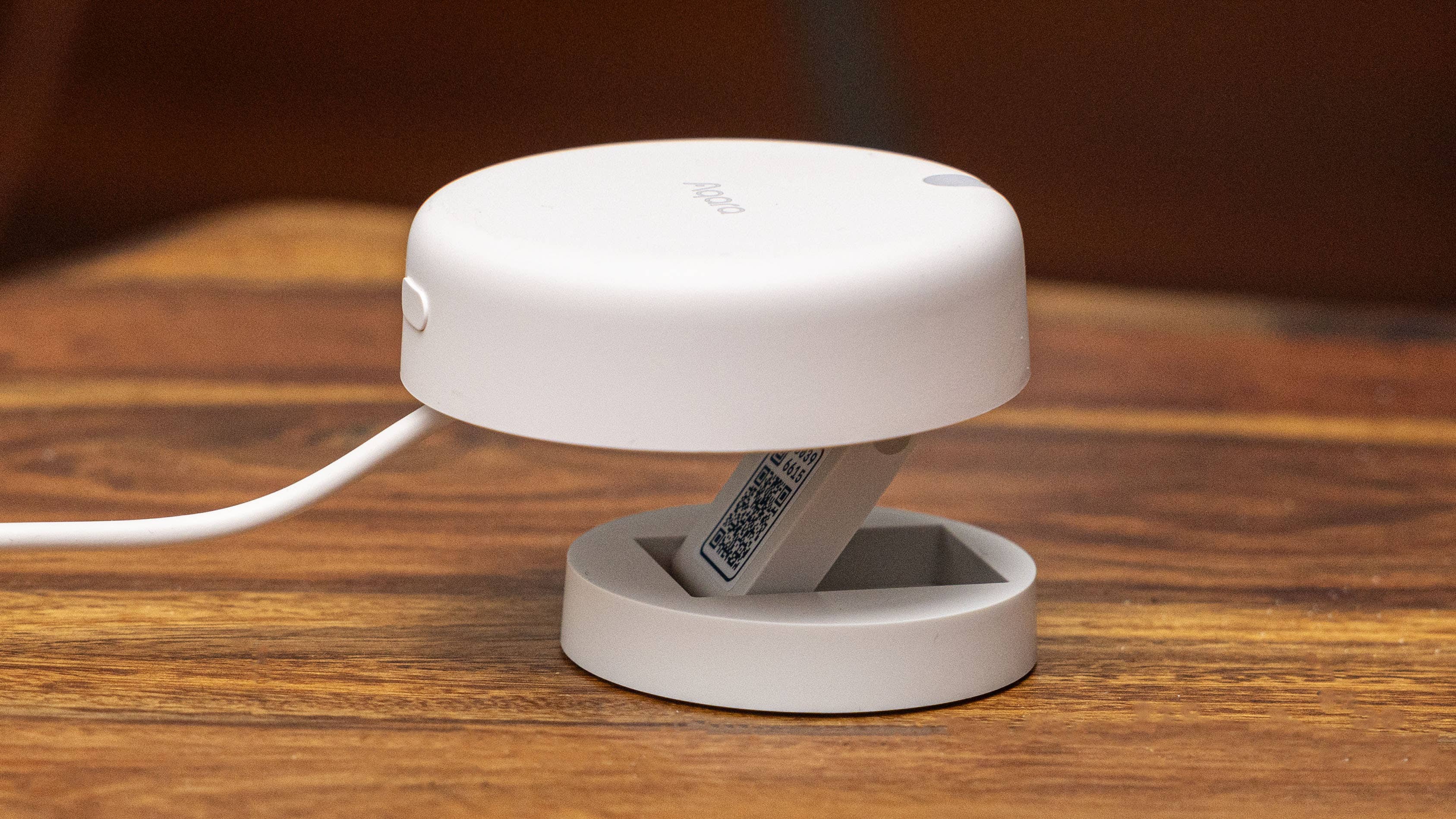

The Aqara FP2 looks stylish and discrete at first glance. The manufacturer crammed enough electronics in a case that measures approximately the width of a thumb with the diameter of a 250 ml Redbull can. This sensor is suspended from a double-jointed hinge with a magnetic base at the end. Thanks to the pre-drilled hole, you can anchor the sensor to a wall as well. It can be hung upside down at an angle to boot.
The most important thing is how the sensor cannot be turned or twisted, ensuring the Aqara lettering remains parallel to the floor. Thanks to its IPX5 certification, the Aqara FP2 is also suitable for damp areas such as bathrooms.
You can easily align the FP2 with its hinge, and the magnetic base makes it easy to mount anywhere.
There is a magnetic base on the Aqara FP2. Alternatively, there is also a hole in the middle of the base plate to screw the sensor in place. Thanks to the hinge, the FP2 is easily aligned. / © nextpit Image source: nextpit

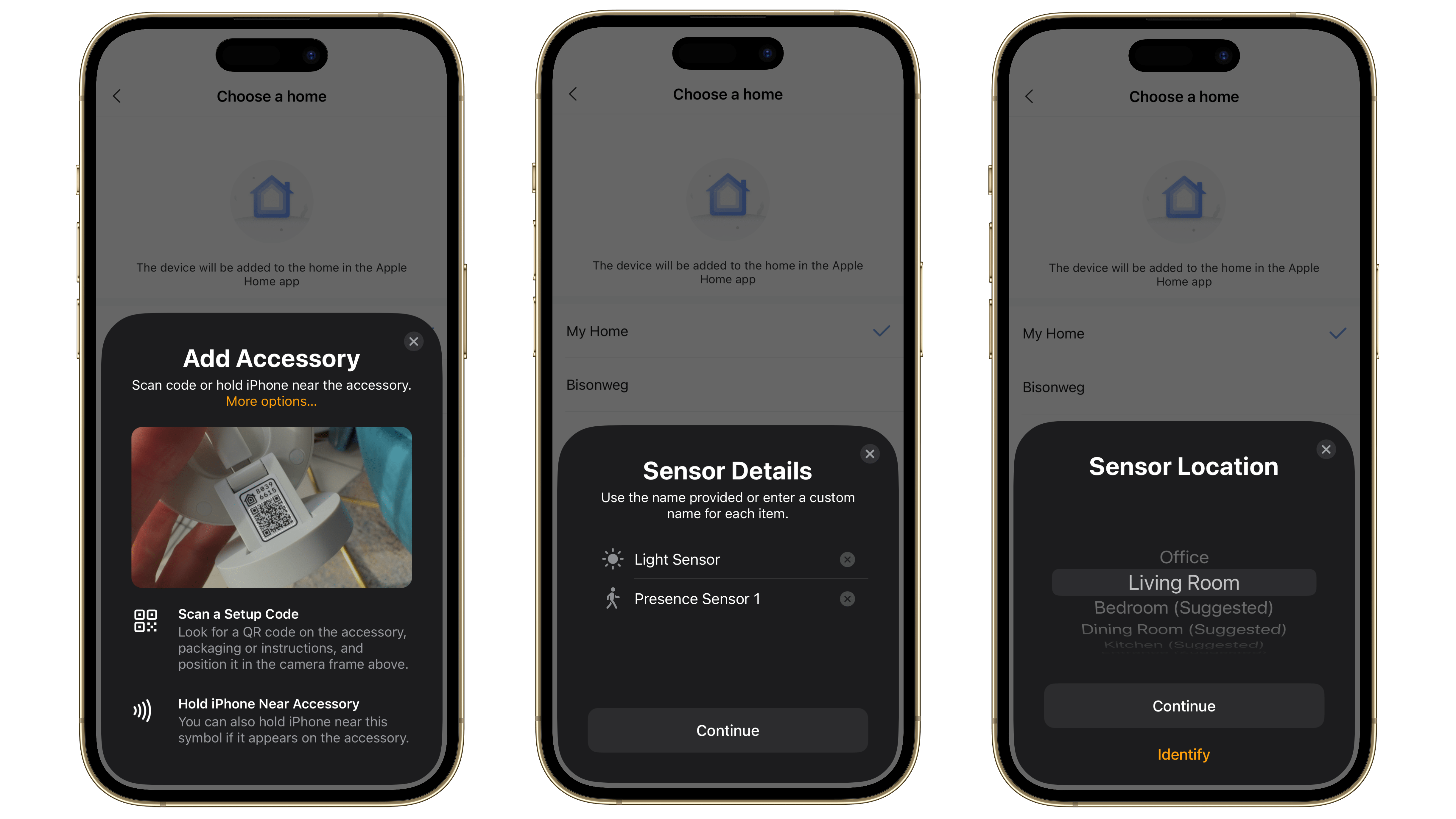

The initial pairing process of the Aqara FP2 is very simple: you plug the sensor into the USB power supply (which is not included) using the included USB cable and activate pairing mode. It all takes less than a minute, and after keying in your Wi-Fi password, the sensor will be connected to the home network.
Setting up the Aqara FP2 is a simple process that can be done via the app.
Scan the code, set the name and room: The initial setup of the Aqara FP2 is simple. Another nice feature on the side is how this light sensor is also integrated in the presence sensor to switch certain actions only when it is dark. / © nextpit Image source: nextpit

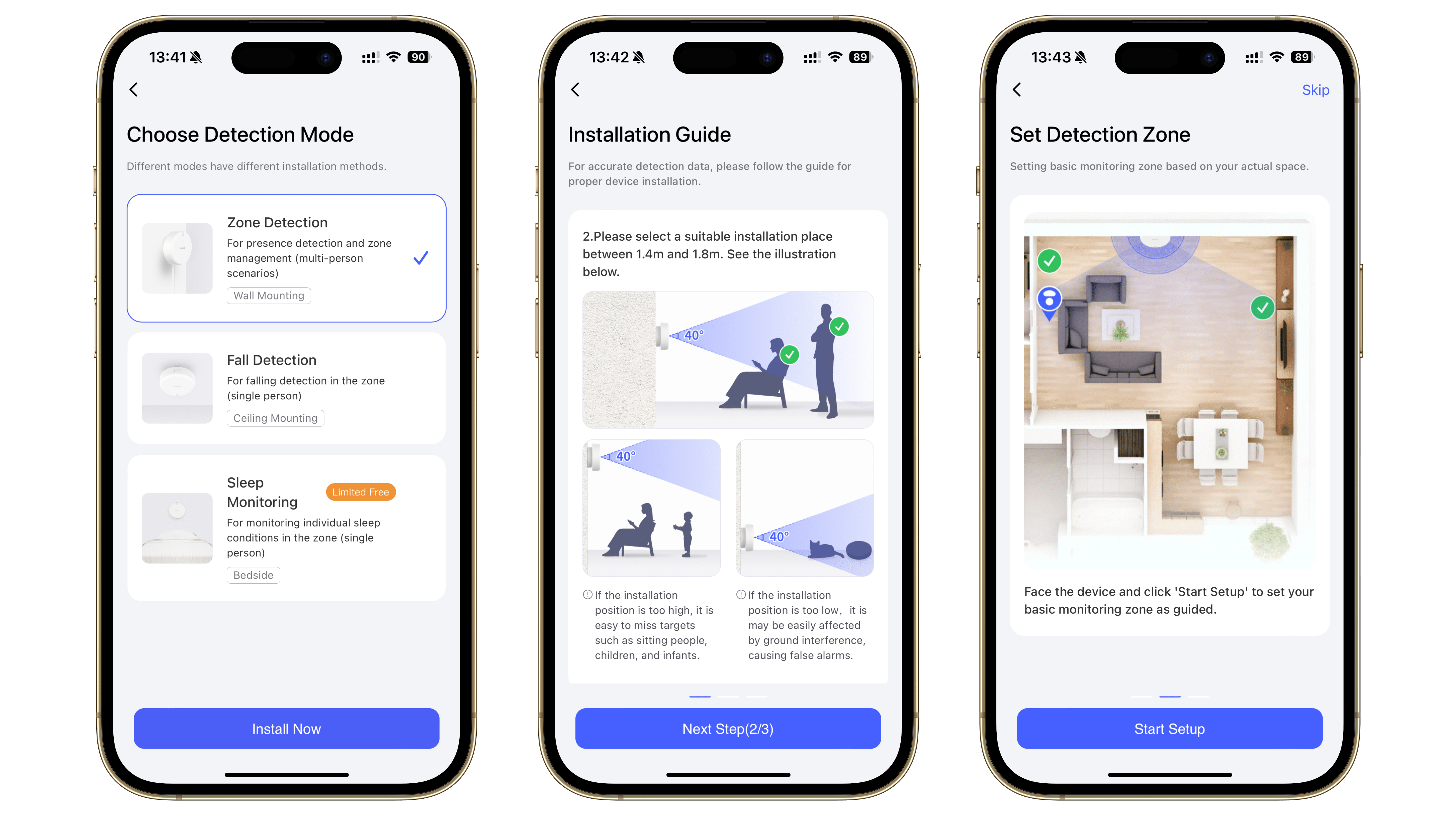

You can then choose from three current usage scenarios:
  • Presence detection: How many people are in the room and where are they? For this, the sensor must be mounted on the wall anywhere between 1.4 and 1.8 m high.
  • Fall detection: Did someone fall in the monitored zone? The sensor must be mounted on the ceiling.
  • Sleep tracking: The Aqara FP2 can track the sleep pattern of a single person in bed. To do this, the sensor must be mounted on the wall above the bed.

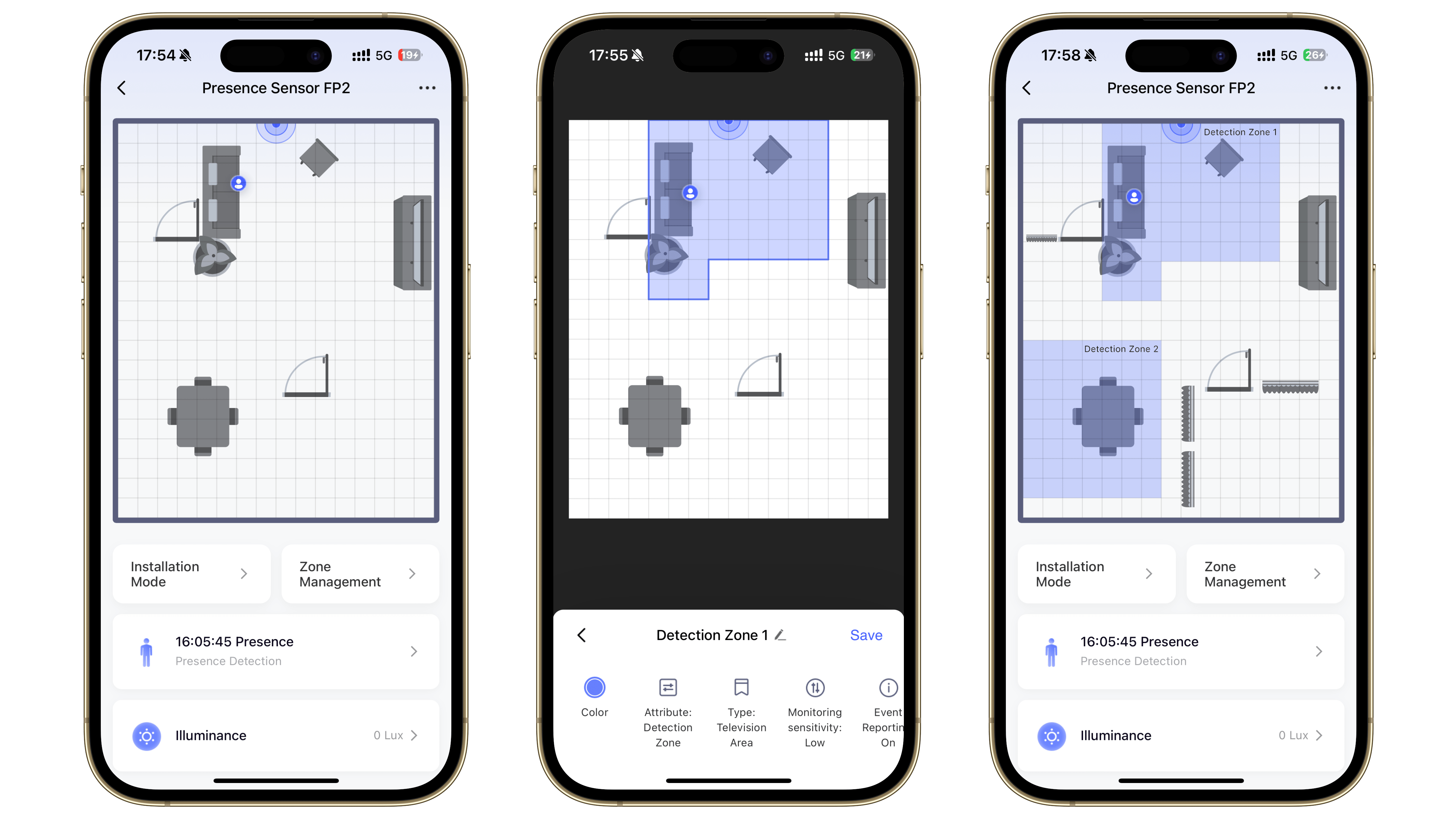

The most exciting function (which is also the primary feature) is presence detection, which we will focus in this review. That is the easy bit before the more complicated part kicks in: calibrating your room. To do this, you will have to walk from the far left to the far right in the room and be monitored to inform the sensor where the room ends for improved accuracy. You can view your live position in the app. In this review, it can get a little bit tricky at first, but it actually works.

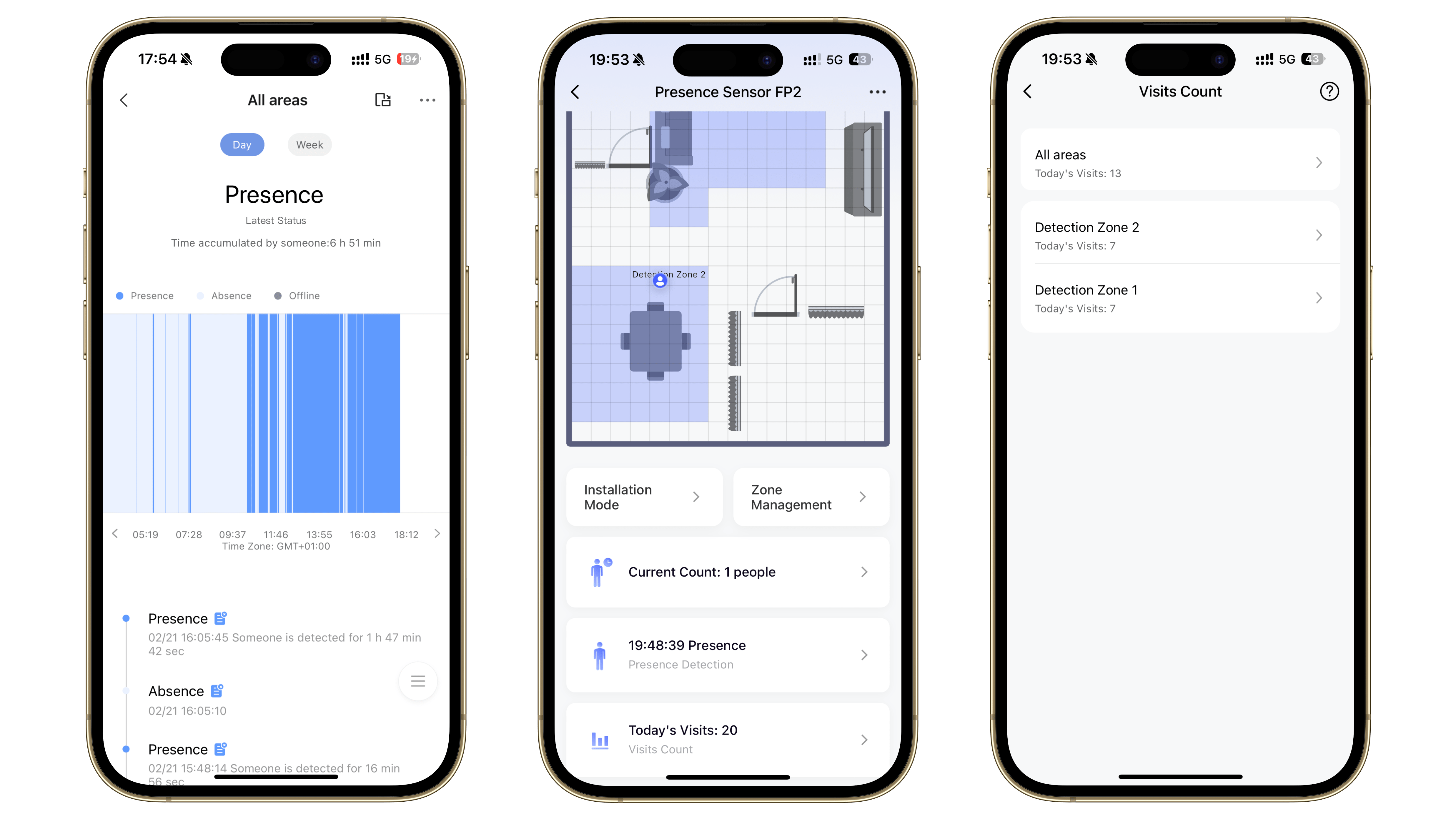

Once you have ‘mapped out’ the room, feel free to mix things up in the empty room. For instance, go to the dining table and place a table at the position shown on the map, or do the same with your sofa, sitting area, or bed. Next, you can set up detection zones that trigger certain actions if one or more people are present or absent. You can complete this setup once in the Aqara app and use the same setting and the zones in other smart home systems, such as Amazon Alexa or Home Assistant.
Position the presence sensor in a virtual image of your home to complete the Aqara FP2
To complete the Aqara FP2’s setup, position the presence sensor in a virtual image of your home. / © nextpit Image source: nextpit

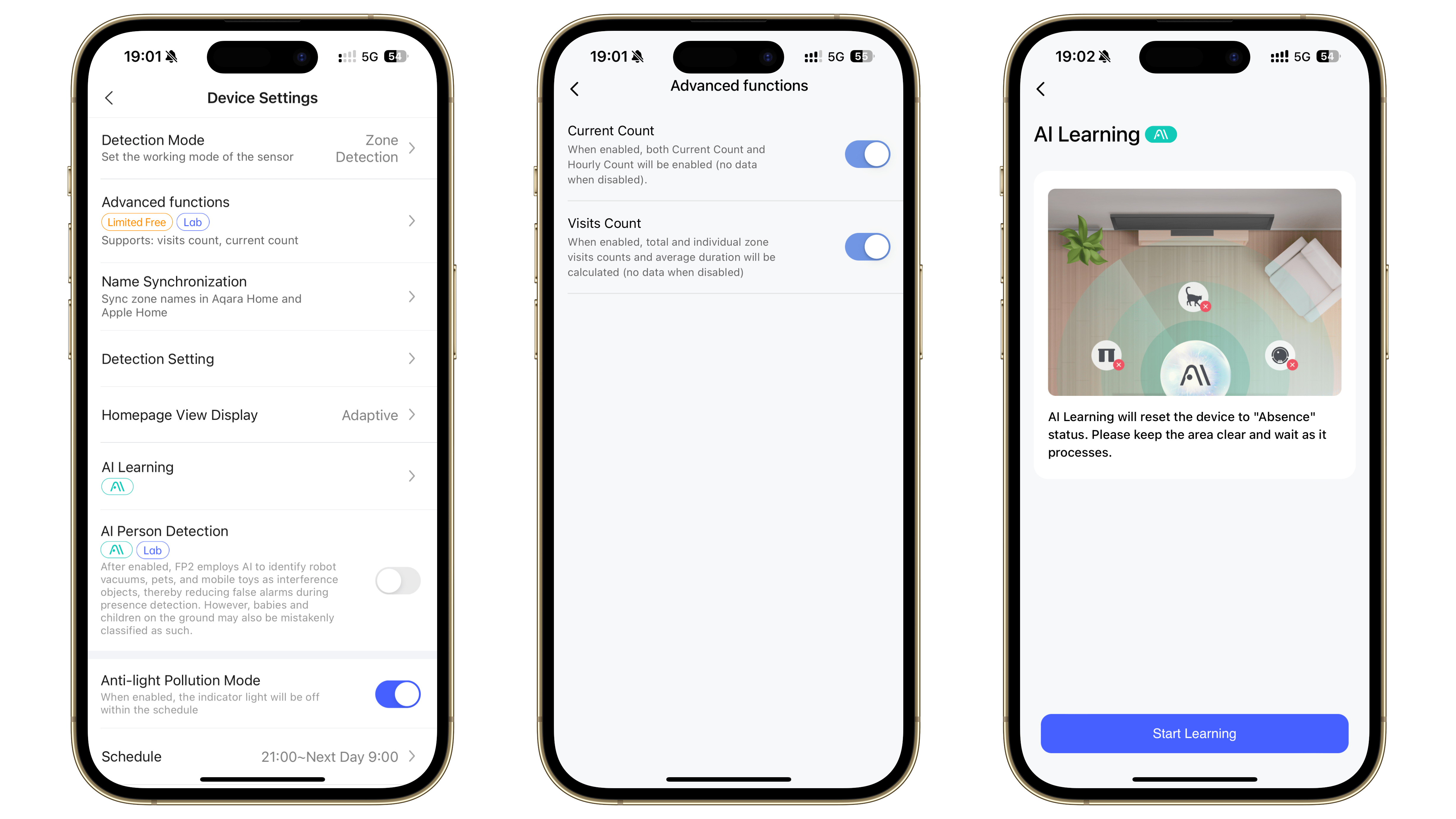

Aqara recently released an update that included a few experimental features designed to further improve detection via artificial intelligence. With the help of the AI learning function, the sensor is supposed to scan the empty room and improve detection.
Expect more updates to come in the future to improve the Aqara FP2.
Aqara will gradually improve the FP2 with updates. Matter support will be added this year. / © nextpit Image source: nextpit
The AI person recognition function was designed to prevent pets and robot vacuum cleaners from being recognized as people by accident. At least the robot vacuum cleaner that runs early in the morning every day was eliminated from the activity log.

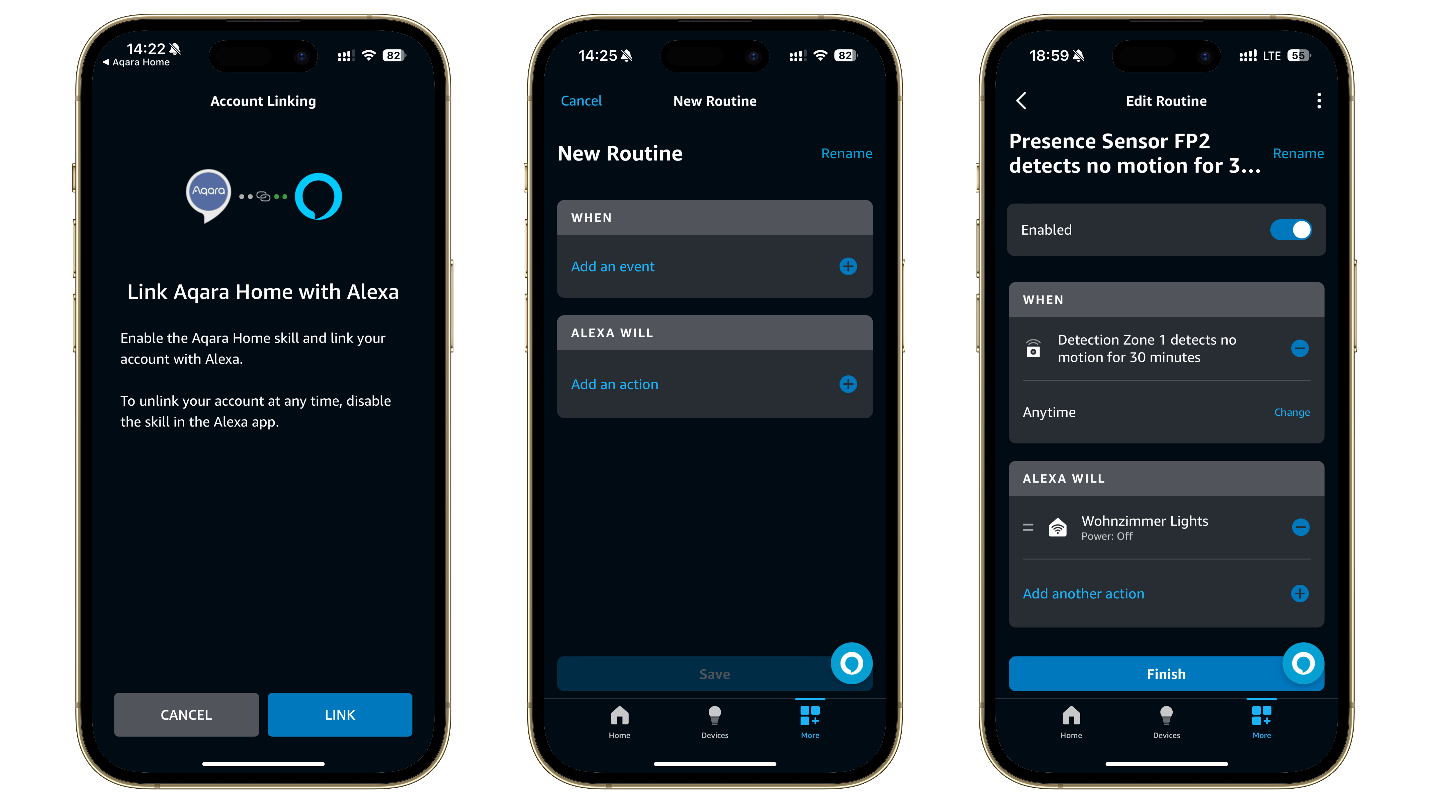

In reality, we not only verified the sensor’s performance in real-time on the display but also tested it in routines. There is one very simple example: as soon as nobody is in the living room for 30 minutes, the lights should be switched off. What can I say? This routine, implemented as an example via Amazon Alexa, worked perfectly.
It is all too easy to link the Aqara FP2 with Alexa, and setting up routines is as easy as A-B-C.
Linking the Aqara FP2 with Alexa is very easy. The first routine is set up in an IF-THEN style with just a few clicks. / © nextpit Image source: nextpit

You can let the Aqara FP2 show different statistics about your presence and absence.
If desired, the Aqara FP2 can also show various statistics concerning your presence and absence. / © nextpit Image source: nextpit
