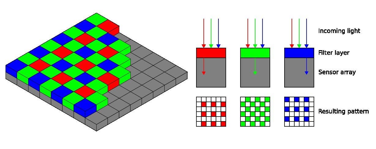

The first step in turning a RAW into a JPEG in the digital photo lab is demosaicing. The image spreading algorithm makes RGB pixels out of only red, green, blue, and possibly white pixels and casts them into a color space. The software then optimizes the image with noise reduction, re-sharpening, lens correction, white balance, and other measures, saving the result as a JPEG file.
