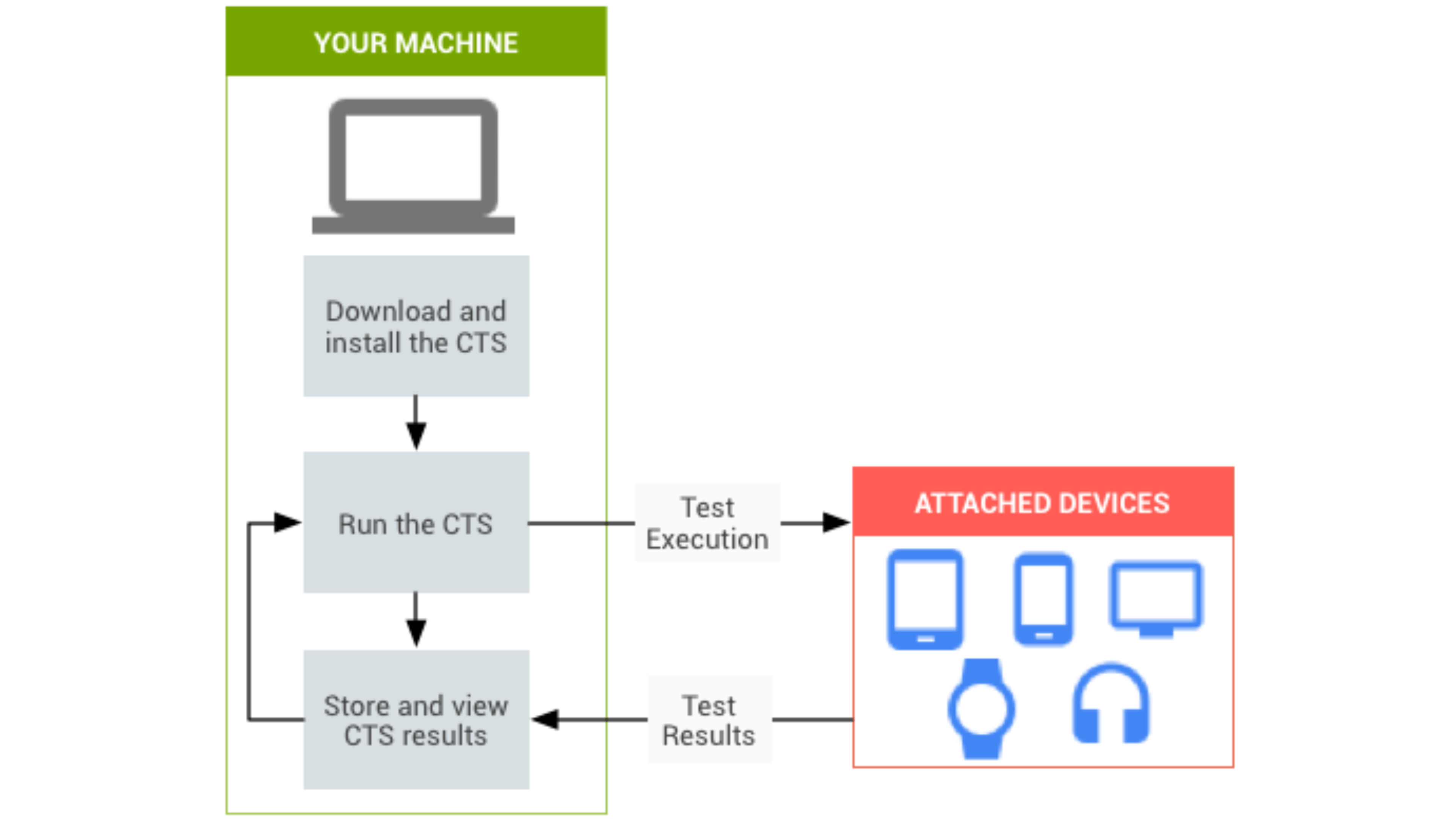

“The first is Google. We send everything to a Google certifying body that submits the update to a test suite called CTS (Compatibility Test Suite). That’s hundreds of thousands of tests. If just one fails, you don’t have Android certification and you can’t deploy the update.”
“If Google’s certifying body says it’s good, you then proceed to carrier tests. You have to go through one European operator after another, the biggest ones being the most demanding. And only after that can you ‘ship’ the update. If one thing crashes, it’s back to square one. It’s long, it’s expensive, it’s complex.”

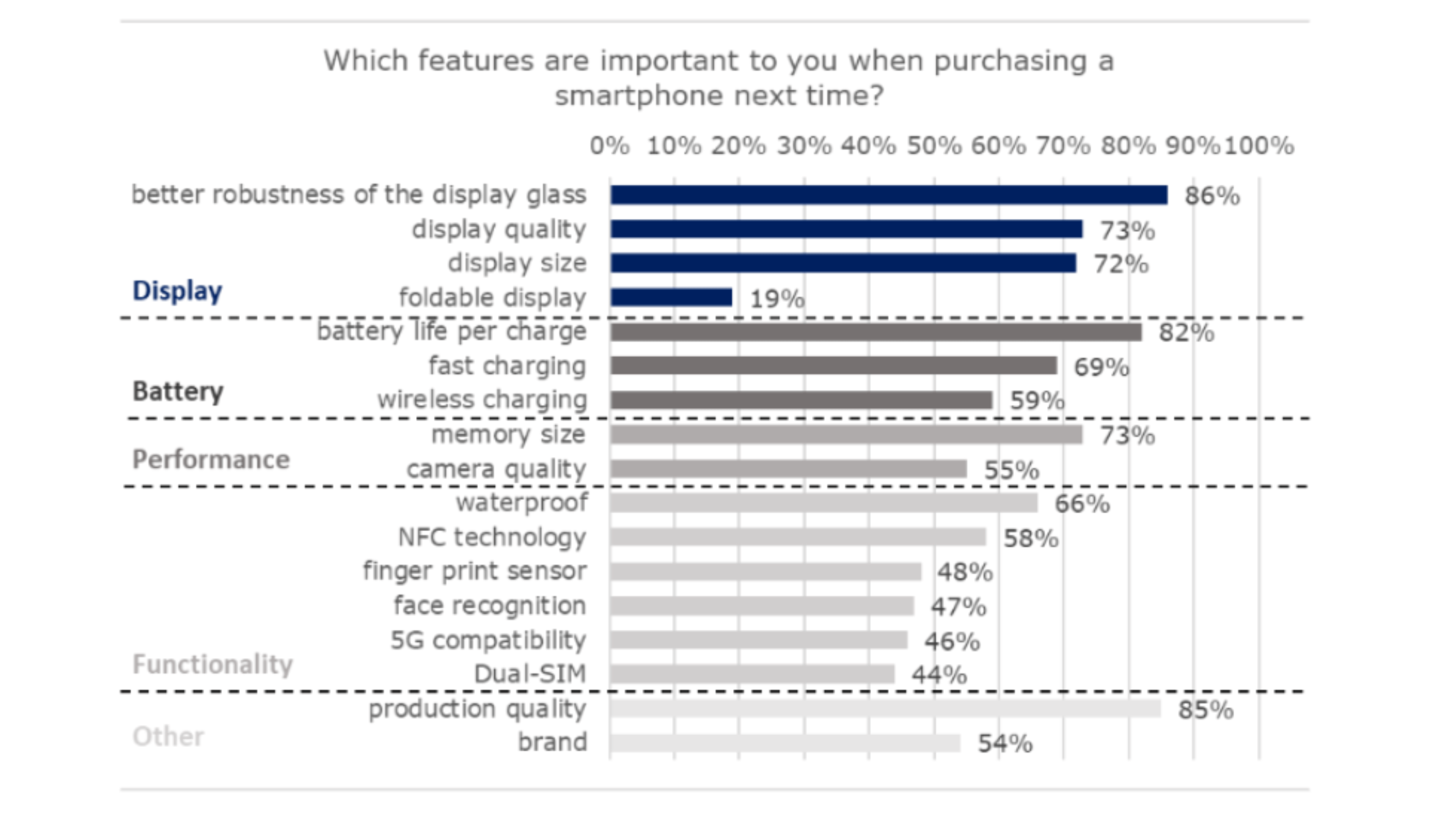

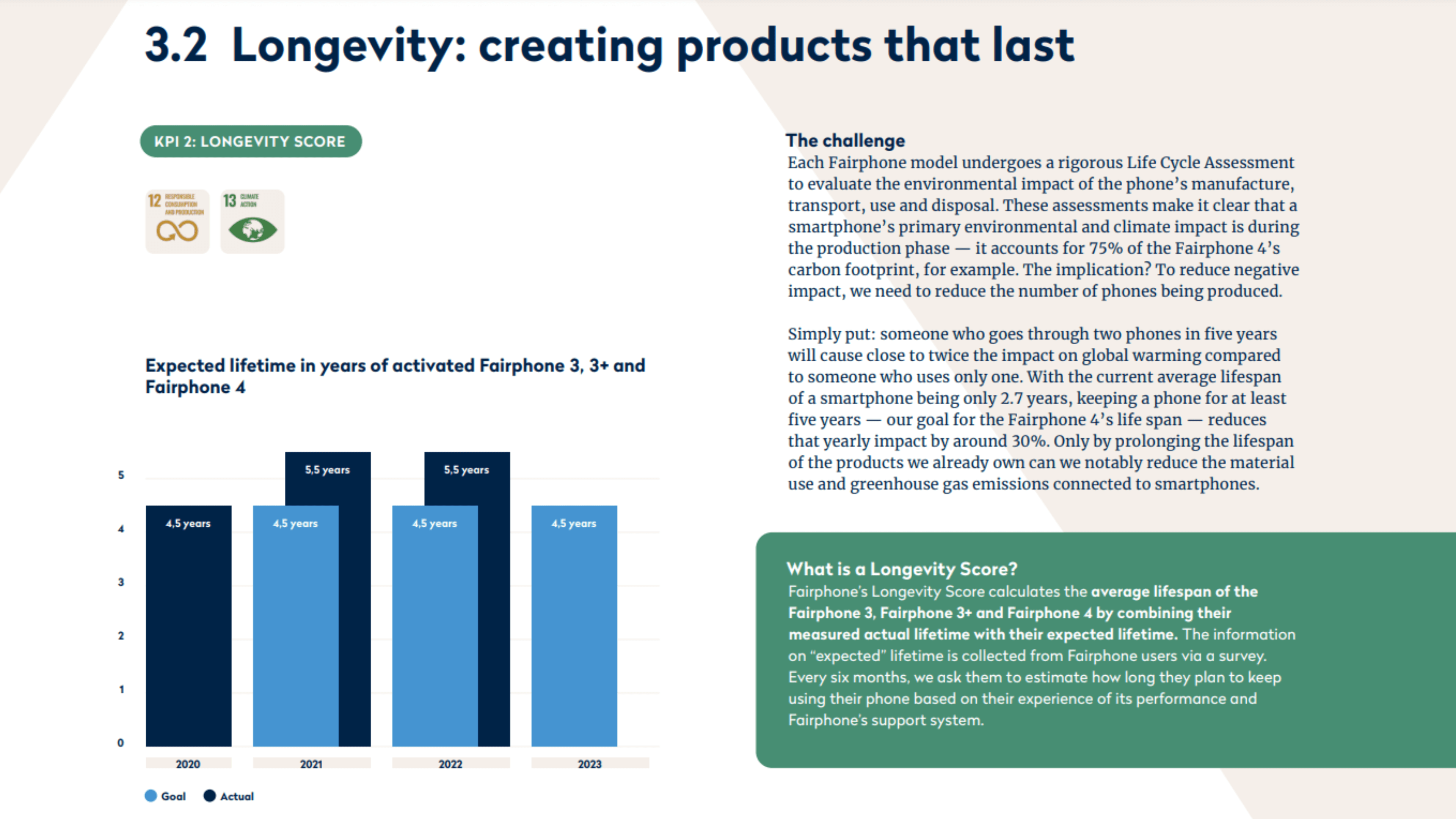

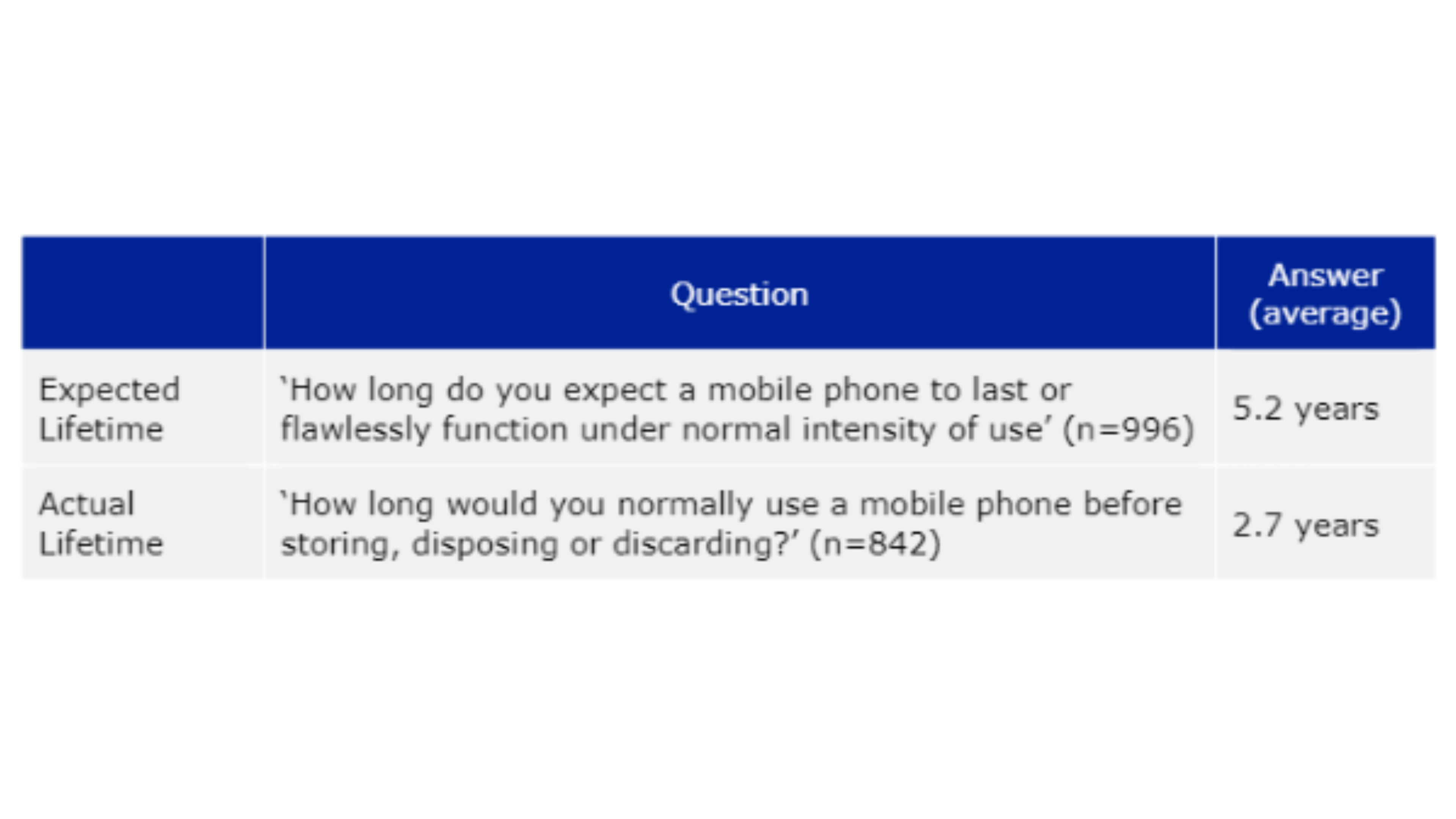

However, this is more a result than a cause. Angès shared with me the preparatory study for the European Ecodesign Directive which aims to limit the waste of electronic products and ensure a better sustainability in the consumption of these products. She represents Fairphone in the government working group for the implementation of this directive in France.
In this study, one of the surveys conducted shows that 19% of European consumers said they bought a new smartphone because the software was no longer receiving any updates or support. Another barometer showed that on average, consumers would like to keep the same smartphone for 5.2 years. Reality showed otherwise, with owners parting with their handsets after a mere 2.7 years.
